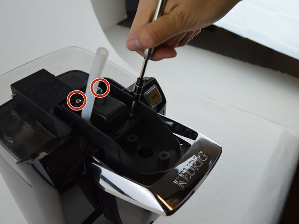

  1. Keurig K10 MINI PLUS Handle Replacement, Top Needle: crwdns2935265:01crwdnd2935265:01crwdnd2935265:02crwdne2935265:0 Keurig K10 MINI PLUS Handle Replacement, Top Needle: crwdns2935265:01crwdnd2935265:02crwdnd2935265:02crwdne2935265:0
    • Remove two 9 mm Phillips #1 screws.
    • Avoid the top needle if at all possible. The needle may cut you and/or penetrate your skin.
    • The screws are located on the top of where the K-Cup would be.

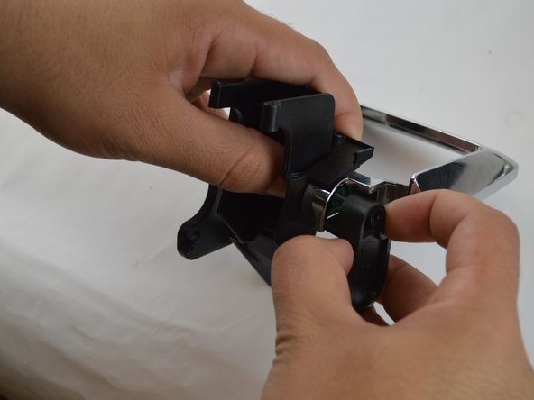

  6. Keurig K10 MINI PLUS Handle Replacement: crwdns2935265:06crwdnd2935265:01crwdnd2935265:01crwdne2935265:0
    • Once you take off the screws, this part of the handle will come off.
  7. Keurig K10 MINI PLUS Handle Replacement: crwdns2935265:07crwdnd2935265:01crwdnd2935265:01crwdne2935265:0
    • To pull this part off, pull inwards with the these tabs located on both sides of the handle assembly.

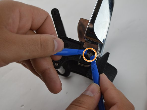

  8. Keurig K10 MINI PLUS Handle Replacement: crwdns2935265:08crwdnd2935265:01crwdnd2935265:03crwdne2935265:0 Keurig K10 MINI PLUS Handle Replacement: crwdns2935265:08crwdnd2935265:02crwdnd2935265:03crwdne2935265:0 Keurig K10 MINI PLUS Handle Replacement: crwdns2935265:08crwdnd2935265:03crwdnd2935265:03crwdne2935265:0
    • Next, remove these two Phillips #1 screws to allow the release of the actual handle from the frame.
    • For the O rings, we used the plastic prying tools. Just keep in mind that you might want to hold one side of the O ring down while trying to pry off the other side with the other.
    • Once you get the O rings on both sides out, you can pull the handle by pulling on each side.
  9. Keurig K10 MINI PLUS Handle Replacement: crwdns2935265:09crwdnd2935265:01crwdnd2935265:01crwdne2935265:0
    • Once you pull both sides, the handle will come off as shown.
