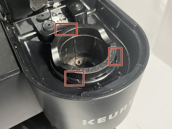

    • Pull the silver handle upwards to open the compartment that holds the pod holder.
  2. Keurig K-Duo Pod Holder Replacement: crwdns2935265:02crwdnd2935265:01crwdnd2935265:03crwdne2935265:0 Keurig K-Duo Pod Holder Replacement: crwdns2935265:02crwdnd2935265:02crwdnd2935265:03crwdne2935265:0 Keurig K-Duo Pod Holder Replacement: crwdns2935265:02crwdnd2935265:03crwdnd2935265:03crwdne2935265:0
    • Pinch the tabs while pulling the pod holder upwards and out of the machine.
    • Be wary of the needle above the pod holder!
    • If the pod holder is stuck, try pushing it back into the machine and pulling it out again.
  3. Keurig K-Duo Pod Holder Replacement: crwdns2935265:03crwdnd2935265:01crwdnd2935265:01crwdne2935265:0
    • Align the replacement pod holder with the three slots in the machine
    • Make sure the tabs are aligned to prevent damaging the machine and/or the pod holder.
  4. Keurig K-Duo Pod Holder Replacement: crwdns2935265:04crwdnd2935265:01crwdnd2935265:01crwdne2935265:0
    • Push the pod holder down until it snaps securely into place.
