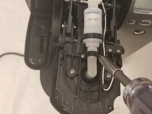

    • Turn off and unplug the Keurig before starting.
    • Lay the Keurig on its back and open the lid.
    • Using a Phillips #2 screwdriver, remove the two 21.0 mm screws.
    • Be careful when removing the screws. There is a sharp puncture needle!
    • You may need to use tweezers to get the screws out.

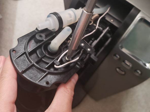

  2. Keurig B70 Platinum Puncture Needle Replacement: crwdns2935265:02crwdnd2935265:01crwdnd2935265:02crwdne2935265:0 Keurig B70 Platinum Puncture Needle Replacement: crwdns2935265:02crwdnd2935265:02crwdnd2935265:02crwdne2935265:0
    • Using a T15 Torx screwdriver, remove the two 29.0 mm screws on each ends of the handle.

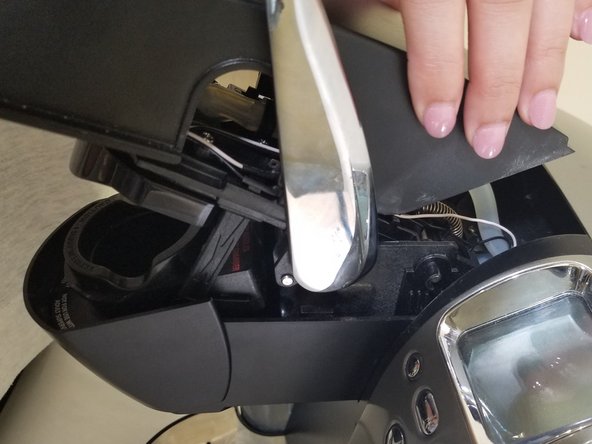

  3. Keurig B70 Platinum Puncture Needle Replacement: crwdns2935265:03crwdnd2935265:01crwdnd2935265:02crwdne2935265:0 Keurig B70 Platinum Puncture Needle Replacement: crwdns2935265:03crwdnd2935265:02crwdnd2935265:02crwdne2935265:0

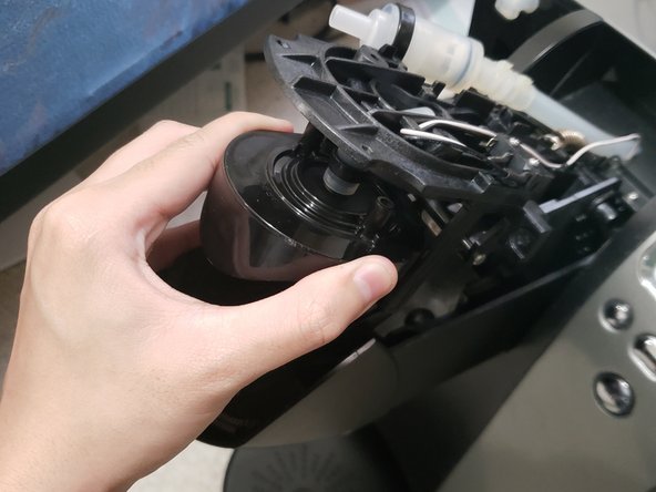

    • Lift and pull the black plastic cover away from the Keurig.
  4. Keurig B70 Platinum Puncture Needle Replacement: crwdns2935265:04crwdnd2935265:01crwdnd2935265:01crwdne2935265:0
    • Push the handle back and upward to detach it from the Keurig.
  5. Keurig B70 Platinum Puncture Needle Replacement, Puncture Needle: crwdns2935265:05crwdnd2935265:01crwdnd2935265:02crwdne2935265:0 Keurig B70 Platinum Puncture Needle Replacement, Puncture Needle: crwdns2935265:05crwdnd2935265:02crwdnd2935265:02crwdne2935265:0

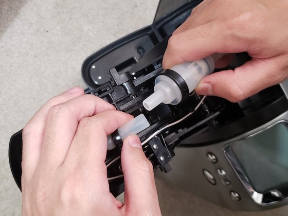

  6. Keurig B70 Platinum Puncture Needle Replacement: crwdns2935265:06crwdnd2935265:01crwdnd2935265:02crwdne2935265:0 Keurig B70 Platinum Puncture Needle Replacement: crwdns2935265:06crwdnd2935265:02crwdnd2935265:02crwdne2935265:0
    • Using both hands, pull the puncture needle tube and the Keurig tube apart to disconnect the tubes.
    • Don't be afraid to pull hard! The tubes are tightly connected.

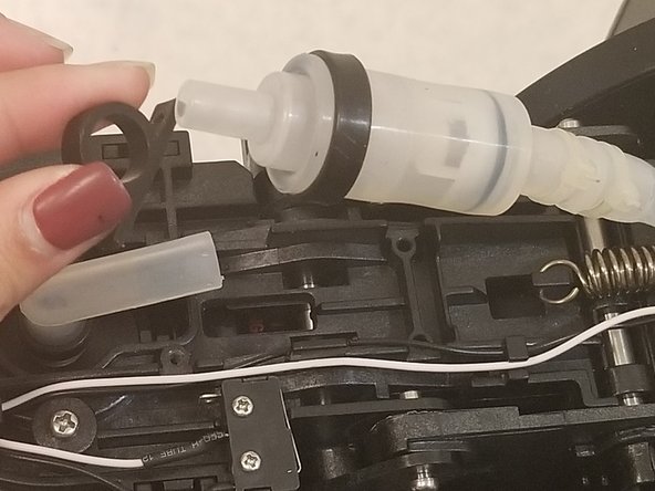

  7. Keurig B70 Platinum Puncture Needle Replacement: crwdns2935265:07crwdnd2935265:01crwdnd2935265:02crwdne2935265:0 Keurig B70 Platinum Puncture Needle Replacement: crwdns2935265:07crwdnd2935265:02crwdnd2935265:02crwdne2935265:0

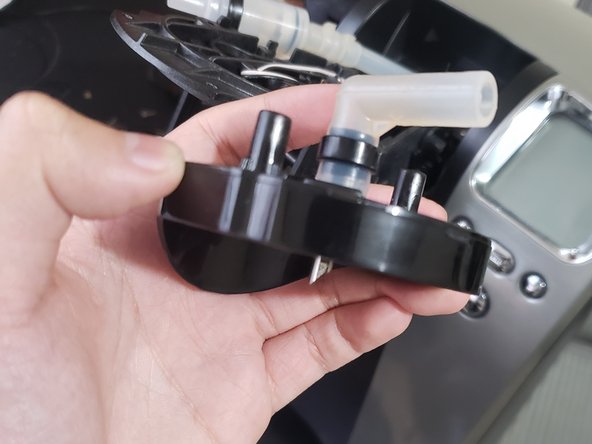

    • Slide the black plastic ring, which holds the puncture needle tube down, off of the tube.

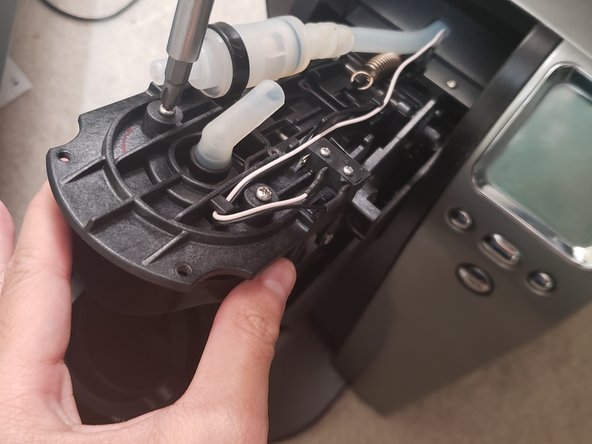

  8. Keurig B70 Platinum Puncture Needle Replacement: crwdns2935265:08crwdnd2935265:01crwdnd2935265:03crwdne2935265:0 Keurig B70 Platinum Puncture Needle Replacement: crwdns2935265:08crwdnd2935265:02crwdnd2935265:03crwdne2935265:0 Keurig B70 Platinum Puncture Needle Replacement: crwdns2935265:08crwdnd2935265:03crwdnd2935265:03crwdne2935265:0
    • Using a Phillips #2 screwdriver, remove the two 9.0 mm screws next to the detached tube.
    • Hold on to the puncture needle when removing the screws to ensure that the puncture needle does not fall and cause injury.
  9. Keurig B70 Platinum Puncture Needle Replacement: crwdns2935265:09crwdnd2935265:01crwdnd2935265:03crwdne2935265:0 Keurig B70 Platinum Puncture Needle Replacement: crwdns2935265:09crwdnd2935265:02crwdnd2935265:03crwdne2935265:0 Keurig B70 Platinum Puncture Needle Replacement: crwdns2935265:09crwdnd2935265:03crwdnd2935265:03crwdne2935265:0
    • Gently pull the puncture needle down and out from the Keurig.
