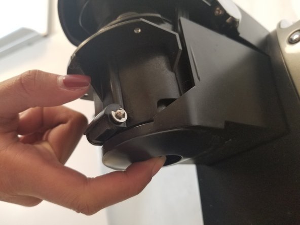

    • Turn off and unplug the Keurig before starting.
    • Open the lid and remove the two 11.0 mm screws located below the K-Cup holder.
  2. Keurig B70 Platinum K-Cup Portion Pack Holder Replacement: crwdns2935265:02crwdnd2935265:01crwdnd2935265:01crwdne2935265:0
    • Pull the black plastic guard of the K-Cup housing away from the Keurig.
    • Depending on the angle, the guard can actually fall out instead. Be ready to catch it!
  3. Keurig B70 Platinum K-Cup Portion Pack Holder Replacement: crwdns2935265:03crwdnd2935265:01crwdnd2935265:03crwdne2935265:0 Keurig B70 Platinum K-Cup Portion Pack Holder Replacement: crwdns2935265:03crwdnd2935265:02crwdnd2935265:03crwdne2935265:0 Keurig B70 Platinum K-Cup Portion Pack Holder Replacement: crwdns2935265:03crwdnd2935265:03crwdnd2935265:03crwdne2935265:0
    • Push the black button at the bottom of the lid to remove the K-cup holder assembly.
    • From the top, lift the assembly out of the Keurig.

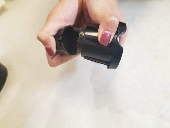

  4. Keurig B70 Platinum K-Cup Portion Pack Holder Replacement: crwdns2935265:04crwdnd2935265:01crwdnd2935265:02crwdne2935265:0 Keurig B70 Platinum K-Cup Portion Pack Holder Replacement: crwdns2935265:04crwdnd2935265:02crwdnd2935265:02crwdne2935265:0
    • Grab the top and the bottom of the holder assembly and pull it apart.
    • Be careful when pulling the assembly. There is a sharp needle!
    • This step requires a little force.

Spring flew out as I was removing cup holder. Where does it go. How do I reinsert it?
