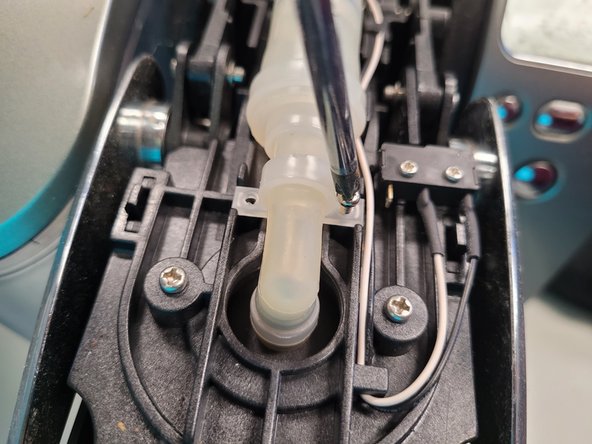

    • Lift up the top lid.
    • Remove the two screws with a Phillips #0 screwdriver.
  2. Keurig B70 Platinum Check Valve Replacement: crwdns2935265:02crwdnd2935265:01crwdnd2935265:02crwdne2935265:0 Keurig B70 Platinum Check Valve Replacement: crwdns2935265:02crwdnd2935265:02crwdnd2935265:02crwdne2935265:0
    • Push down on the lid.
    • Lift up and remove the lid.
  3. Keurig B70 Platinum Check Valve Replacement: crwdns2935265:03crwdnd2935265:01crwdnd2935265:02crwdne2935265:0 Keurig B70 Platinum Check Valve Replacement: crwdns2935265:03crwdnd2935265:02crwdnd2935265:02crwdne2935265:0
    • Using the Phillips #0 screwdriver, remove the two screws holding the tubing to the puncture needle.
  4. Keurig B70 Platinum Check Valve Replacement: crwdns2935265:04crwdnd2935265:01crwdnd2935265:03crwdne2935265:0 Keurig B70 Platinum Check Valve Replacement: crwdns2935265:04crwdnd2935265:02crwdnd2935265:03crwdne2935265:0 Keurig B70 Platinum Check Valve Replacement: crwdns2935265:04crwdnd2935265:03crwdnd2935265:03crwdne2935265:0
    • Twist and pull to disconnect the valve on that side.
  5. Keurig B70 Platinum Check Valve Replacement: crwdns2935265:05crwdnd2935265:01crwdnd2935265:02crwdne2935265:0 Keurig B70 Platinum Check Valve Replacement: crwdns2935265:05crwdnd2935265:02crwdnd2935265:02crwdne2935265:0
    • On the other side, cut the one zip tie closest to the valve.
  6. Keurig B70 Platinum Check Valve Replacement: crwdns2935265:06crwdnd2935265:01crwdnd2935265:02crwdne2935265:0 Keurig B70 Platinum Check Valve Replacement: crwdns2935265:06crwdnd2935265:02crwdnd2935265:02crwdne2935265:0
    • Twist and pull to disconnect valve on the other side.
  7. Keurig B70 Platinum Check Valve Replacement: crwdns2935265:07crwdnd2935265:01crwdnd2935265:02crwdne2935265:0 Keurig B70 Platinum Check Valve Replacement: crwdns2935265:07crwdnd2935265:02crwdnd2935265:02crwdne2935265:0
    • Reassemble the valve in place.
    • Resecure it with a zip tie.
    • Trim the excess plastic off of the zip tie.
