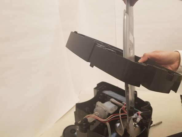

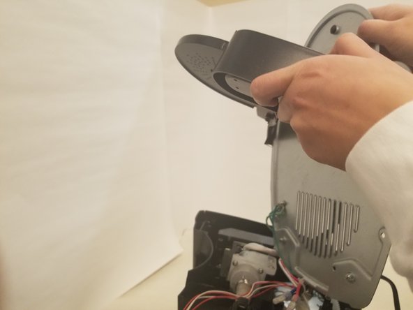

    • Lift the metal plate off the Keurig and hang it over the side of the device.
    • Be careful! The metal plate is sharp!
    • There are wires connected to the metal plate. Make sure the wires are not in the way of the internal components.

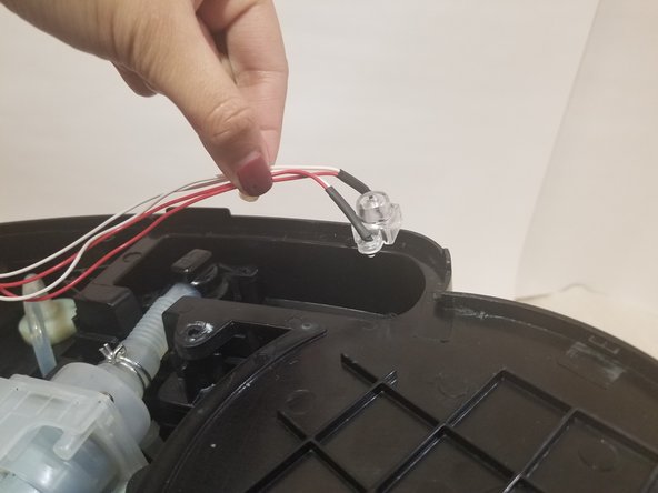

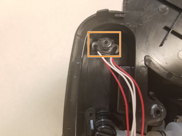

    • Remove the three 11.0 mm screws located on the upper left side of the base from within the tub-looking area.
    • Pull out the red and white wires and put it off to the side of the Keurig.

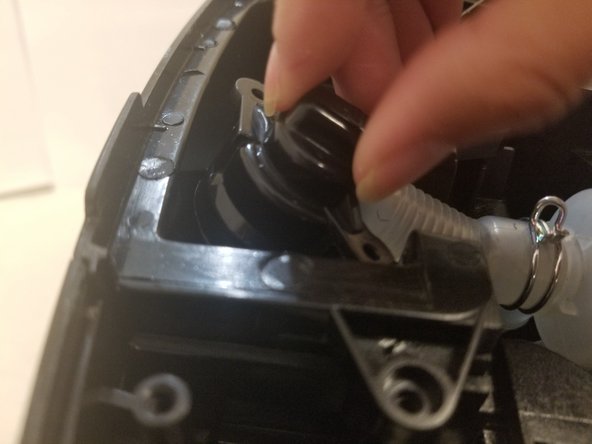

    • Pull out the water collector by gripping it tightly and lifting upwards.
  5. Keurig B70 Platinum Base Replacement: crwdns2935265:05crwdnd2935265:01crwdnd2935265:03crwdne2935265:0 Keurig B70 Platinum Base Replacement: crwdns2935265:05crwdnd2935265:02crwdnd2935265:03crwdne2935265:0 Keurig B70 Platinum Base Replacement: crwdns2935265:05crwdnd2935265:03crwdnd2935265:03crwdne2935265:0

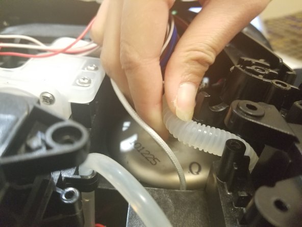

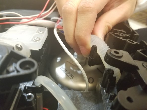

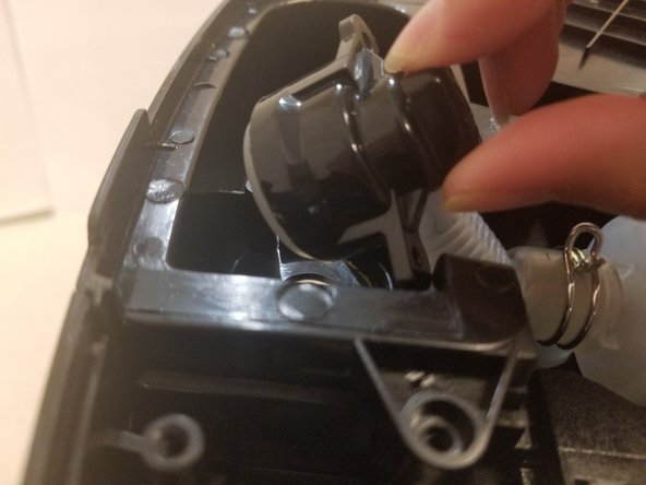

    • Lift the tube, connected to the tank, off the black plastic hook and leave it off to the side of the hook.
  6. Keurig B70 Platinum Base Replacement: crwdns2935265:06crwdnd2935265:01crwdnd2935265:03crwdne2935265:0 Keurig B70 Platinum Base Replacement: crwdns2935265:06crwdnd2935265:02crwdnd2935265:03crwdne2935265:0 Keurig B70 Platinum Base Replacement: crwdns2935265:06crwdnd2935265:03crwdnd2935265:03crwdne2935265:0

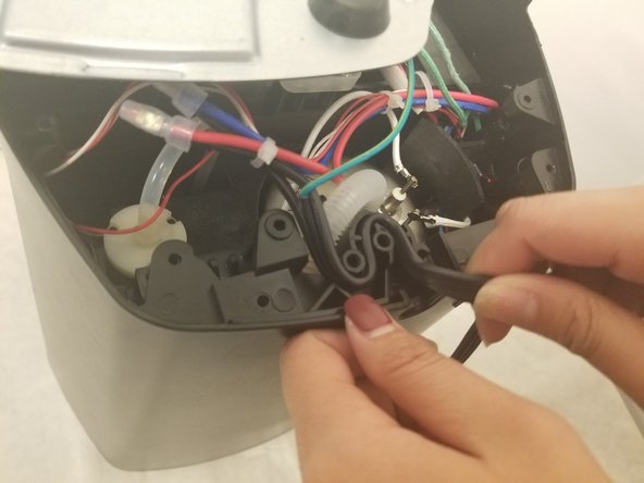

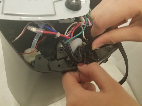

    • Pull the power cord out from the plastic holder located near the water tank.
    • This step requires a bit of force so don't be afraid to pull harder!

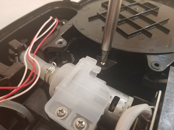

    • Remove the six 13.0 mm screws.
