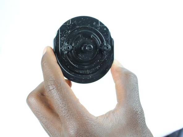

  4. Keurig B60 Puncture Needle Replacement, Puncture Needle: crwdns2935265:04crwdnd2935265:01crwdnd2935265:01crwdne2935265:0
    • Locate and remove the two 9.5 mm Phillips #1 screws.
    • Remove the plastic ring around the K-Cup Pack Holder

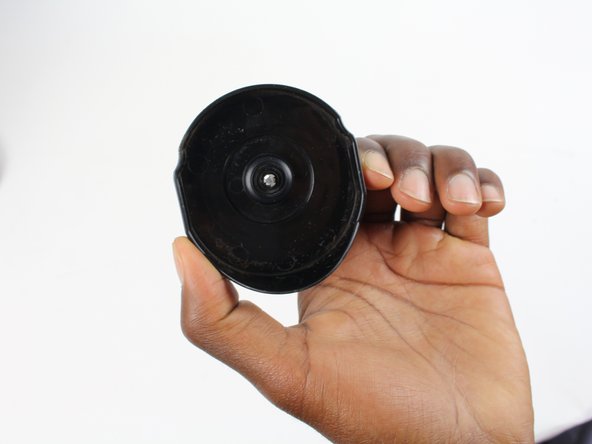

  5. Keurig B60 Puncture Needle Replacement: crwdns2935265:05crwdnd2935265:01crwdnd2935265:01crwdne2935265:0
    • Remove the two 9.5 mm Phillips #1 screws on the underside of the lid.

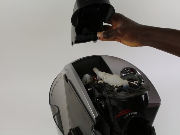

  6. Keurig B60 Puncture Needle Replacement: crwdns2935265:06crwdnd2935265:01crwdnd2935265:02crwdne2935265:0 Keurig B60 Puncture Needle Replacement: crwdns2935265:06crwdnd2935265:02crwdnd2935265:02crwdne2935265:0
    • Detach the lid from the Keurig.

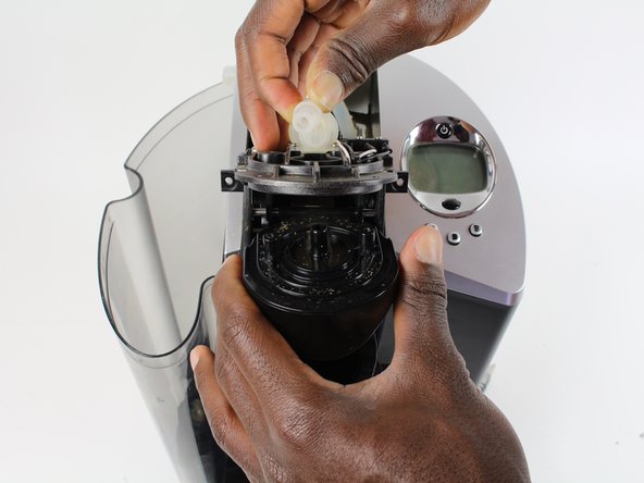

    • Locate and remove the two 9.5 mm Phillips #1 screws on the top of the puncture needle.
  8. Keurig B60 Puncture Needle Replacement: crwdns2935265:08crwdnd2935265:01crwdnd2935265:03crwdne2935265:0 Keurig B60 Puncture Needle Replacement: crwdns2935265:08crwdnd2935265:02crwdnd2935265:03crwdne2935265:0 Keurig B60 Puncture Needle Replacement: crwdns2935265:08crwdnd2935265:03crwdnd2935265:03crwdne2935265:0
    • Squeeze and pull on the hose to remove it from the Puncture Needle
    • Puncture needle should now be exposed
  9. Keurig B60 Puncture Needle Replacement: crwdns2935265:09crwdnd2935265:01crwdnd2935265:03crwdne2935265:0 Keurig B60 Puncture Needle Replacement: crwdns2935265:09crwdnd2935265:02crwdnd2935265:03crwdne2935265:0 Keurig B60 Puncture Needle Replacement: crwdns2935265:09crwdnd2935265:03crwdnd2935265:03crwdne2935265:0
    • Remove the Puncture Needle Assembly from Keurig
