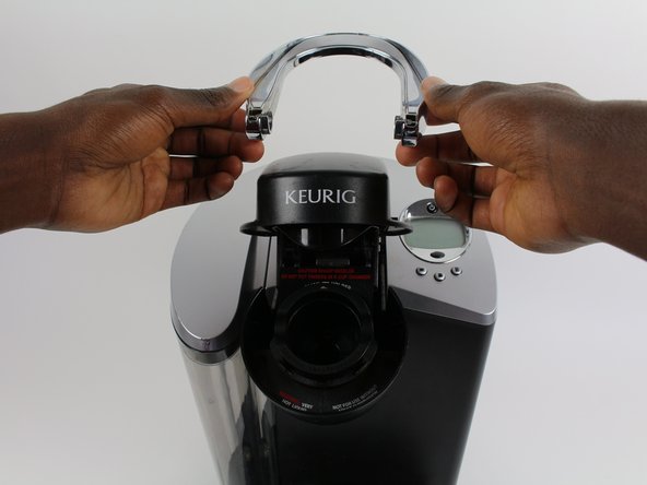

    • Lift the handle
  2. Keurig B60 Handle Replacement: crwdns2935265:02crwdnd2935265:01crwdnd2935265:03crwdne2935265:0 Keurig B60 Handle Replacement: crwdns2935265:02crwdnd2935265:02crwdnd2935265:03crwdne2935265:0 Keurig B60 Handle Replacement: crwdns2935265:02crwdnd2935265:03crwdnd2935265:03crwdne2935265:0
    • Locate and remove the two 9.5 mm Torx T15 screws on both sides of the handle.
  3. Keurig B60 Handle Replacement: crwdns2935265:03crwdnd2935265:01crwdnd2935265:02crwdne2935265:0 Keurig B60 Handle Replacement: crwdns2935265:03crwdnd2935265:02crwdnd2935265:02crwdne2935265:0
    • Remove the broken handle and replace with the new one
