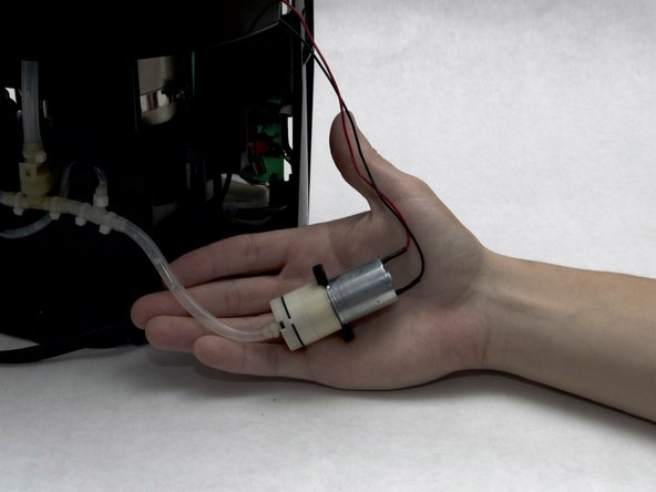

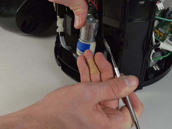

    1. Keurig 2.0-400 Mini Pump Replacement, Mini Pump: crwdns2935265:016crwdnd2935265:01crwdnd2935265:02crwdne2935265:0 Keurig 2.0-400 Mini Pump Replacement, Mini Pump: crwdns2935265:016crwdnd2935265:02crwdnd2935265:02crwdne2935265:0
      • Pry it out from the frame by using the metal spudger.
    2. Keurig 2.0-400 Mini Pump Replacement: crwdns2935265:017crwdnd2935265:01crwdnd2935265:01crwdne2935265:0
      • Lift the Mini Pump up and out of the frame using your hands.
    3. Keurig 2.0-400 Mini Pump Replacement: crwdns2935265:018crwdnd2935265:01crwdnd2935265:02crwdne2935265:0 Keurig 2.0-400 Mini Pump Replacement: crwdns2935265:018crwdnd2935265:02crwdnd2935265:02crwdne2935265:0
      • Remove the wires connecting the Mini Pump to the Keurig, including the air tube.
      • The Mini Pump is should now be free from the brewer.
