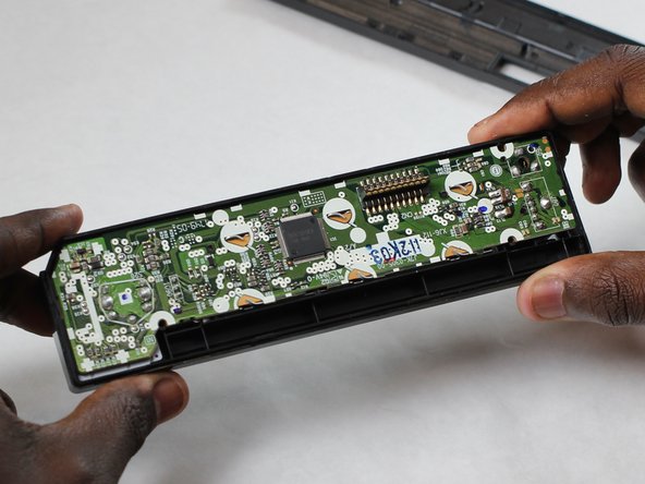

Kenwood KMM-BT522HD LCD Screen Replacement
  1. Kenwood KMM-BT522HD LCD Screen Replacement, Face Plate: crwdns2935265:01crwdnd2935265:01crwdnd2935265:01crwdne2935265:0
    • Press the ejection button on the lower left corner of the face plate.
  2. Kenwood KMM-BT522HD LCD Screen Replacement: crwdns2935265:02crwdnd2935265:01crwdnd2935265:02crwdne2935265:0 Kenwood KMM-BT522HD LCD Screen Replacement: crwdns2935265:02crwdnd2935265:02crwdnd2935265:02crwdne2935265:0
    • Remove the face plate by pulling upwards and in the direction of the ejection button.
  3. Kenwood KMM-BT522HD LCD Screen Replacement, LCD Screen: crwdns2935265:03crwdnd2935265:01crwdnd2935265:01crwdne2935265:0
    • Remove the three 7.5mm Phillips #1 screws.
  4. Kenwood KMM-BT522HD LCD Screen Replacement: crwdns2935265:04crwdnd2935265:01crwdnd2935265:02crwdne2935265:0 Kenwood KMM-BT522HD LCD Screen Replacement: crwdns2935265:04crwdnd2935265:02crwdnd2935265:02crwdne2935265:0
    • Separate the two halves of the housing by prying along the length of the device with a plastic opening tool.
  5. Kenwood KMM-BT522HD LCD Screen Replacement: crwdns2935265:05crwdnd2935265:01crwdnd2935265:01crwdne2935265:0
    • Remove the motherboard from the housing.
