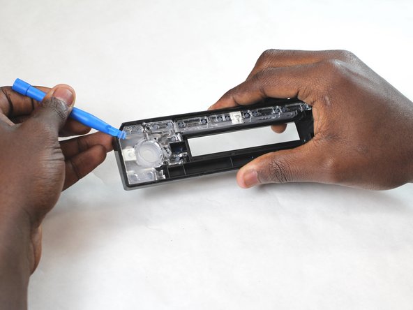

  6. Kenwood KMM-BT522HD Button Replacement, Buttons: crwdns2935265:06crwdnd2935265:01crwdnd2935265:02crwdne2935265:0 Kenwood KMM-BT522HD Button Replacement, Buttons: crwdns2935265:06crwdnd2935265:02crwdnd2935265:02crwdne2935265:0
    • Remove the 5.5 mm Phillips #00 screw.
    • Remove the clear plastic piece by carefully prying it away from the plastic housing.

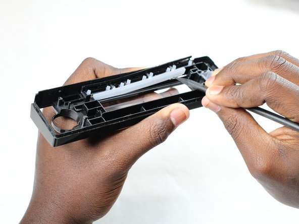

  7. Kenwood KMM-BT522HD Button Replacement: crwdns2935265:07crwdnd2935265:01crwdnd2935265:02crwdne2935265:0 Kenwood KMM-BT522HD Button Replacement: crwdns2935265:07crwdnd2935265:02crwdnd2935265:02crwdne2935265:0
    • Remove the gray rubber piece by pulling it upwards and away from the plastic housing.
    • Use the pointed end of a spudger to pry out the buttons.
