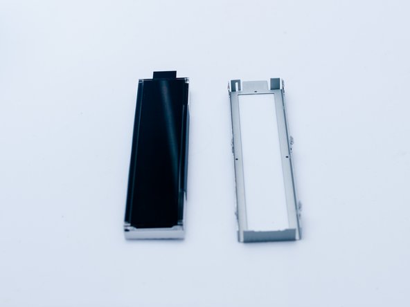

  3. Kenwood KDC-BT565U LCD Screen Replacement, LCD Screen: crwdns2935265:03crwdnd2935265:01crwdnd2935265:01crwdne2935265:0
    • Remove the four 7.5mm Phillips #0 screws on the back of the face-plate.

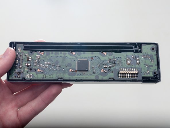

  4. Kenwood KDC-BT565U LCD Screen Replacement: crwdns2935265:04crwdnd2935265:01crwdnd2935265:02crwdne2935265:0 Kenwood KDC-BT565U LCD Screen Replacement: crwdns2935265:04crwdnd2935265:02crwdnd2935265:02crwdne2935265:0
    • Use a spudger or prying tool to open the back of the face plate. Pry the back at multiple points around the edge of the face plate. This will take some patience. Applying too much force risks breaking the plastic.

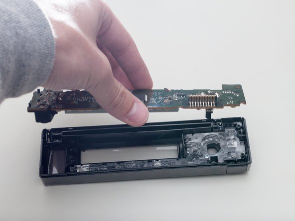

  5. Kenwood KDC-BT565U LCD Screen Replacement: crwdns2935265:05crwdnd2935265:01crwdnd2935265:02crwdne2935265:0 Kenwood KDC-BT565U LCD Screen Replacement: crwdns2935265:05crwdnd2935265:02crwdnd2935265:02crwdne2935265:0
    • Lift and remove the motherboard to reveal the inside of the front panel.
    • You might need to pry the right side up with the spudger.

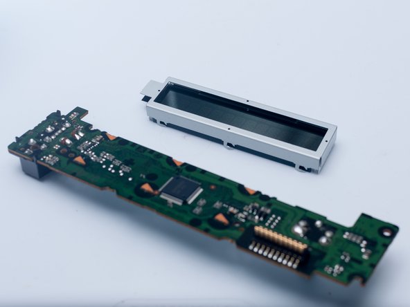

  6. Kenwood KDC-BT565U LCD Screen Replacement: crwdns2935265:06crwdnd2935265:01crwdnd2935265:03crwdne2935265:0 Kenwood KDC-BT565U LCD Screen Replacement: crwdns2935265:06crwdnd2935265:02crwdnd2935265:03crwdne2935265:0 Kenwood KDC-BT565U LCD Screen Replacement: crwdns2935265:06crwdnd2935265:03crwdnd2935265:03crwdne2935265:0

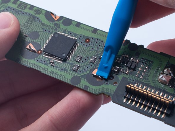

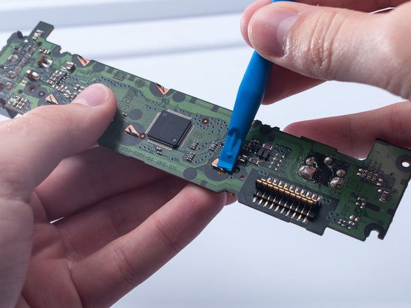

    • Use the plastic spudger to straighten out the six pegs to allow the removal of the LCD screen.
    • Make sure to use an ESD-safe prying tool when working on electrical boards. Here, we are using a plastic tool, not a metal one.
  7. Kenwood KDC-BT565U LCD Screen Replacement: crwdns2935265:07crwdnd2935265:01crwdnd2935265:03crwdne2935265:0 Kenwood KDC-BT565U LCD Screen Replacement: crwdns2935265:07crwdnd2935265:02crwdnd2935265:03crwdne2935265:0 Kenwood KDC-BT565U LCD Screen Replacement: crwdns2935265:07crwdnd2935265:03crwdnd2935265:03crwdne2935265:0
    • Lift the LCD screen to remove and replace it.
