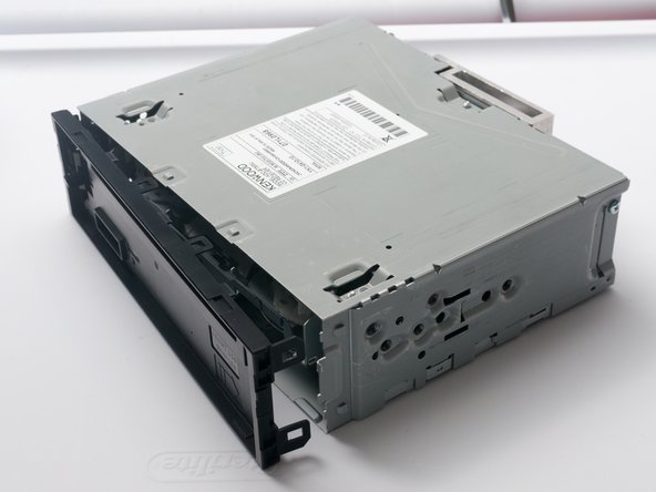

  3. Kenwood KDC-BT565U CD Drive Replacement, Metal Sleeve: crwdns2935265:03crwdnd2935265:01crwdnd2935265:02crwdne2935265:0 Kenwood KDC-BT565U CD Drive Replacement, Metal Sleeve: crwdns2935265:03crwdnd2935265:02crwdnd2935265:02crwdne2935265:0
    • Grasp the outer metal sleeve with one hand and the front of the unit with the other.
    • Slide the sleeve back until it comes off the unit.

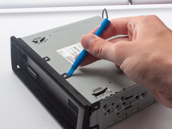

  5. Kenwood KDC-BT565U CD Drive Replacement: crwdns2935265:05crwdnd2935265:01crwdnd2935265:03crwdne2935265:0 Kenwood KDC-BT565U CD Drive Replacement: crwdns2935265:05crwdnd2935265:02crwdnd2935265:03crwdne2935265:0 Kenwood KDC-BT565U CD Drive Replacement: crwdns2935265:05crwdnd2935265:03crwdnd2935265:03crwdne2935265:0
    • Lift the clasps of the tabs around the edges by using a plastic opening tool or spudger.

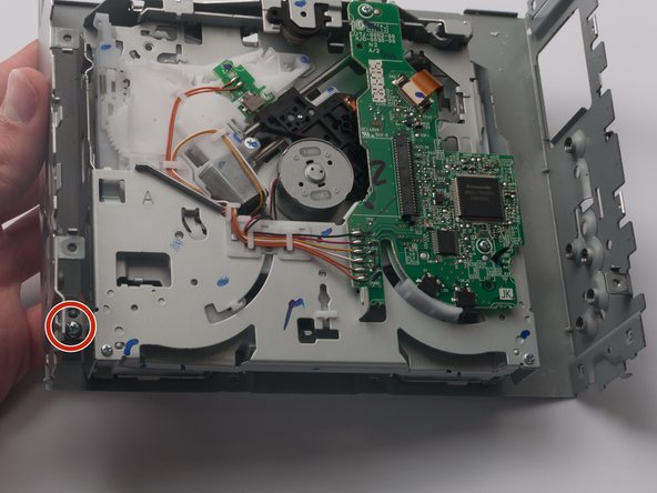

  6. Kenwood KDC-BT565U CD Drive Replacement: crwdns2935265:06crwdnd2935265:01crwdnd2935265:01crwdne2935265:0
    • Remove the two 5.5mm Phillips #0 (PH0) screws on the bottom of the unit.

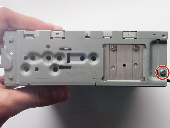

  7. Kenwood KDC-BT565U CD Drive Replacement: crwdns2935265:07crwdnd2935265:01crwdnd2935265:02crwdne2935265:0 Kenwood KDC-BT565U CD Drive Replacement: crwdns2935265:07crwdnd2935265:02crwdnd2935265:02crwdne2935265:0
    • Remove the two 6mm Phillips #0 screws from the side of the unit.

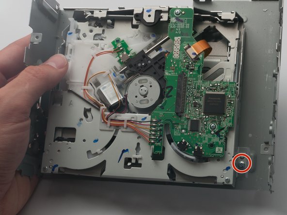

  8. Kenwood KDC-BT565U CD Drive Replacement: crwdns2935265:08crwdnd2935265:01crwdnd2935265:01crwdne2935265:0
    • Remove the 7.5mm Phillips #0 screw in between the red and white RCA inputs.
    • Remove the two 13.5mm Phillips #0 screws towards the top of the aluminum block.
    • Remove the 10mm Phillips #0 screw towards the bottom of the aluminum block.
    • Remove the two 6mm Phillips #0 screws found above the microphone mount and below the circular port.
    • Remove the 7.5mm Phillips #0 screw next to the large rectangular power connector.
    • Remove the 10mm Phillips #0 screw that resides above the aluminum block.

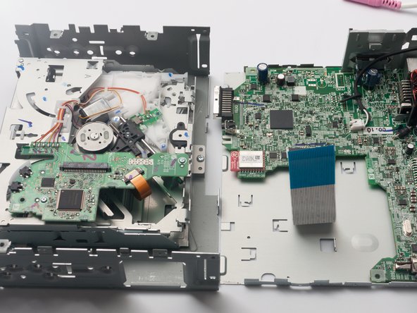

  9. Kenwood KDC-BT565U CD Drive Replacement: crwdns2935265:09crwdnd2935265:01crwdnd2935265:01crwdne2935265:0
    • Separate the top and bottom metal housings of the unit carefully.
    • There is a connecting ribbon that links the two halves. Too much force could rip and irreversibly damage the ribbon.
  10. Kenwood KDC-BT565U CD Drive Replacement: crwdns2935265:010crwdnd2935265:01crwdnd2935265:02crwdne2935265:0 Kenwood KDC-BT565U CD Drive Replacement: crwdns2935265:010crwdnd2935265:02crwdnd2935265:02crwdne2935265:0
    • Carefully pull the ribbon out of the connector found on the bottom half of the unit (the bottom half has the CD drive).
    • To remove the ribbon, grip the black base connector with one hand and the base of the ribbon with the other. The ribbon will have a blue, reinforced section close to the base (seen in second picture) which makes it easier to pull.
