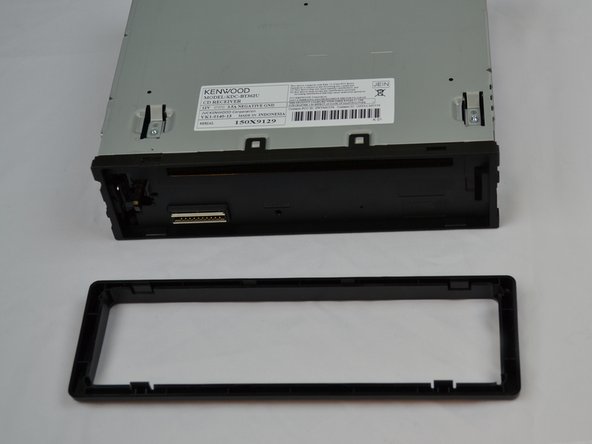

    • Locate the face-plate eject button.
  2. Kenwood KDC-BT362U LCD Screen Replacement: crwdns2935265:02crwdnd2935265:01crwdnd2935265:02crwdne2935265:0 Kenwood KDC-BT362U LCD Screen Replacement: crwdns2935265:02crwdnd2935265:02crwdnd2935265:02crwdne2935265:0
    • Press the eject button with your forefinger.
    • Remove the face-plate.
  3. Kenwood KDC-BT362U LCD Screen Replacement: crwdns2935265:03crwdnd2935265:01crwdnd2935265:02crwdne2935265:0 Kenwood KDC-BT362U LCD Screen Replacement: crwdns2935265:03crwdnd2935265:02crwdnd2935265:02crwdne2935265:0
    • Starting on the top side, pop the front panel frame out.
    • Remove the face-plate frame.

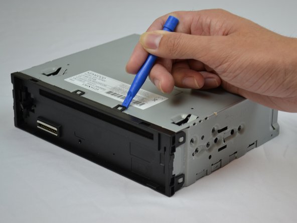

  4. Kenwood KDC-BT362U LCD Screen Replacement: crwdns2935265:04crwdnd2935265:01crwdnd2935265:02crwdne2935265:0 Kenwood KDC-BT362U LCD Screen Replacement: crwdns2935265:04crwdnd2935265:02crwdnd2935265:02crwdne2935265:0
    • Use the plastic opening tool to pry open the tabs.
    • Repeat on the opposite side.
  5. Kenwood KDC-BT362U LCD Screen Replacement: crwdns2935265:05crwdnd2935265:01crwdnd2935265:01crwdne2935265:0
    • Remove the front panel.

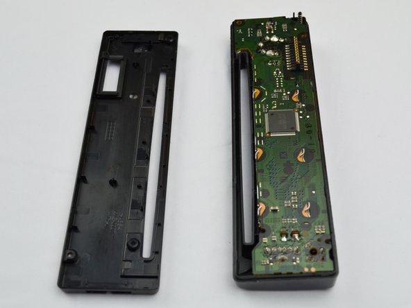

  6. Kenwood KDC-BT362U LCD Screen Replacement, LCD Screen: crwdns2935265:06crwdnd2935265:01crwdnd2935265:01crwdne2935265:0
    • Use the Phillips #0 Screwdriver to remove the four screws.
  7. Kenwood KDC-BT362U LCD Screen Replacement: crwdns2935265:07crwdnd2935265:01crwdnd2935265:02crwdne2935265:0 Kenwood KDC-BT362U LCD Screen Replacement: crwdns2935265:07crwdnd2935265:02crwdnd2935265:02crwdne2935265:0
    • Use the plastic opening tool to pry it open.
  8. Kenwood KDC-BT362U LCD Screen Replacement: crwdns2935265:08crwdnd2935265:01crwdnd2935265:02crwdne2935265:0 Kenwood KDC-BT362U LCD Screen Replacement: crwdns2935265:08crwdnd2935265:02crwdnd2935265:02crwdne2935265:0

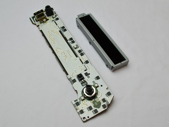

    • Lift and remove the motherboard to reveal the inside of the front panel.
  9. Kenwood KDC-BT362U LCD Screen Replacement: crwdns2935265:09crwdnd2935265:01crwdnd2935265:02crwdne2935265:0 Kenwood KDC-BT362U LCD Screen Replacement: crwdns2935265:09crwdnd2935265:02crwdnd2935265:02crwdne2935265:0

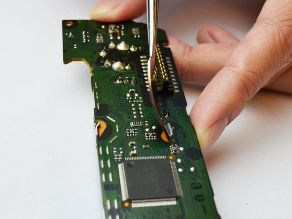

    • Use the metal spudger to straighten out the six pegs to allow the removal of the LCD Screen.
  10. Kenwood KDC-BT362U LCD Screen Replacement: crwdns2935265:010crwdnd2935265:01crwdnd2935265:02crwdne2935265:0 Kenwood KDC-BT362U LCD Screen Replacement: crwdns2935265:010crwdnd2935265:02crwdnd2935265:02crwdne2935265:0
    • Lift the LCD Screen to remove and replace it.
