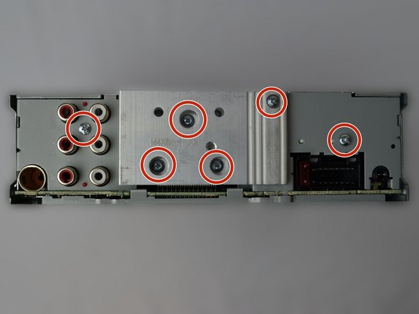

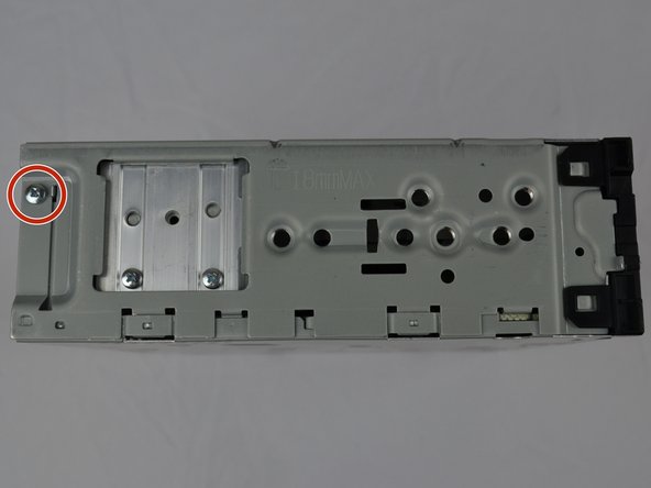

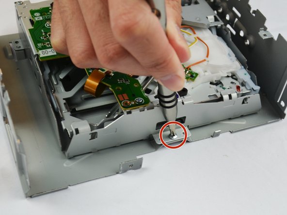

  6. Kenwood KDC-BT362U DVD-Drive Replacement, Metal Case: crwdns2935265:06crwdnd2935265:01crwdnd2935265:03crwdne2935265:0 Kenwood KDC-BT362U DVD-Drive Replacement, Metal Case: crwdns2935265:06crwdnd2935265:02crwdnd2935265:03crwdne2935265:0 Kenwood KDC-BT362U DVD-Drive Replacement, Metal Case: crwdns2935265:06crwdnd2935265:03crwdnd2935265:03crwdne2935265:0
    • Use the Phillips #0 Screwdriver to remove the screws off of the metal case.

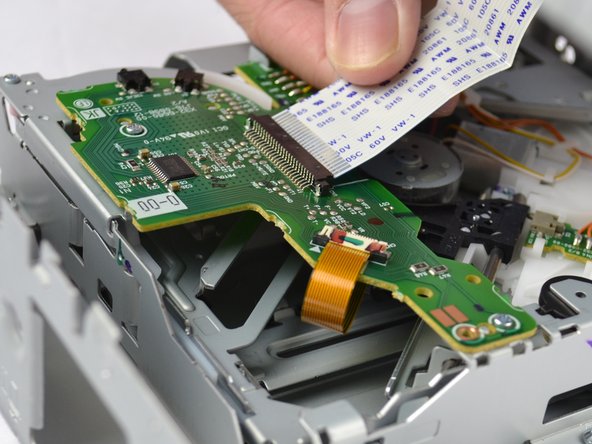

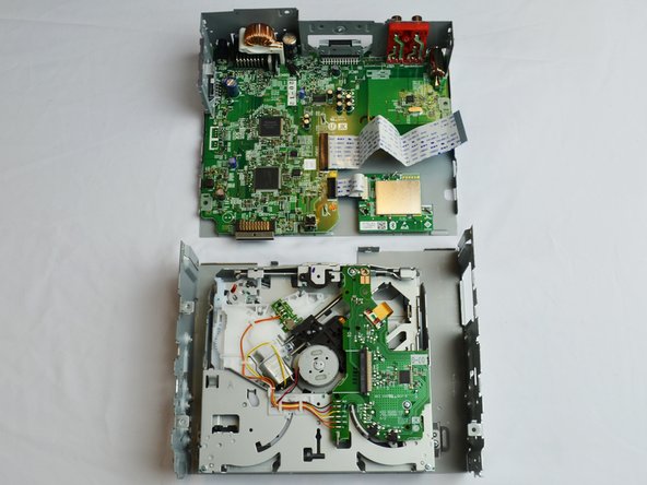

  7. Kenwood KDC-BT362U DVD-Drive Replacement: crwdns2935265:07crwdnd2935265:01crwdnd2935265:03crwdne2935265:0 Kenwood KDC-BT362U DVD-Drive Replacement: crwdns2935265:07crwdnd2935265:02crwdnd2935265:03crwdne2935265:0 Kenwood KDC-BT362U DVD-Drive Replacement: crwdns2935265:07crwdnd2935265:03crwdnd2935265:03crwdne2935265:0
    • Carefully separate the top and bottom halves of the metal case apart.
    • Do not separate the metal case halves completely.
    • Carefully pull the DVD-Drive ribbon cable from the motherboard.
  8. Kenwood KDC-BT362U DVD-Drive Replacement, DVD-Drive: crwdns2935265:08crwdnd2935265:01crwdnd2935265:02crwdne2935265:0 Kenwood KDC-BT362U DVD-Drive Replacement, DVD-Drive: crwdns2935265:08crwdnd2935265:02crwdnd2935265:02crwdne2935265:0
    • Use the Phillips #0 Screwdriver to remove the three screws.
  9. Kenwood KDC-BT362U DVD-Drive Replacement: crwdns2935265:09crwdnd2935265:01crwdnd2935265:01crwdne2935265:0
    • Lift the DVD-Drive to separate it from the metal case.
