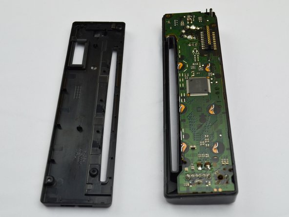

    • Use the Phillips #0 Screwdriver to remove the four screws.
  7. Kenwood KDC-BT362U Button  Replacement: crwdns2935265:07crwdnd2935265:01crwdnd2935265:02crwdne2935265:0 Kenwood KDC-BT362U Button  Replacement: crwdns2935265:07crwdnd2935265:02crwdnd2935265:02crwdne2935265:0
    • Use the plastic opening tool to pry it open.

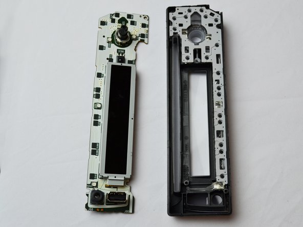

  8. Kenwood KDC-BT362U Button  Replacement: crwdns2935265:08crwdnd2935265:01crwdnd2935265:02crwdne2935265:0 Kenwood KDC-BT362U Button  Replacement: crwdns2935265:08crwdnd2935265:02crwdnd2935265:02crwdne2935265:0
    • Lift and remove the motherboard to reveal the inside of the front panel.

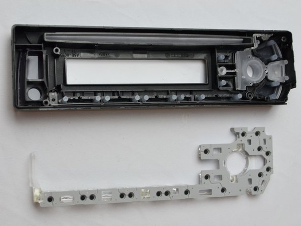

  9. Kenwood KDC-BT362U Button  Replacement: crwdns2935265:09crwdnd2935265:01crwdnd2935265:02crwdne2935265:0 Kenwood KDC-BT362U Button  Replacement: crwdns2935265:09crwdnd2935265:02crwdnd2935265:02crwdne2935265:0
    • Use the plastic opening tool to lift up and remove the cover.
  10. Kenwood KDC-BT362U Button  Replacement: crwdns2935265:010crwdnd2935265:01crwdnd2935265:01crwdne2935265:0
    • The buttons are now able to be removed and replaced if damaged or missing.
