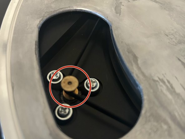

  6. Kenwood KD-37R Belt Replacement and Modification: crwdns2935265:06crwdnd2935265:01crwdnd2935265:02crwdne2935265:0 Kenwood KD-37R Belt Replacement and Modification: crwdns2935265:06crwdnd2935265:02crwdnd2935265:02crwdne2935265:0
    • Put the metal platter back on the turn table.
    • Use your thumb and forefinger to pull a small section of the belt behind the pulley shaft.

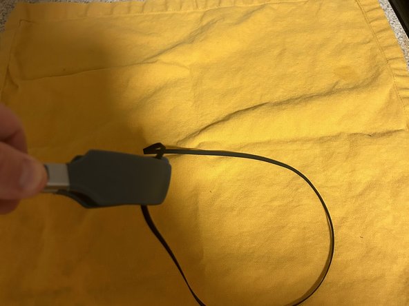

    • This is when I discovered the belt that was sent to me was slightly too big. Not to fear! We can fix that.
  8. Kenwood KD-37R Belt Replacement and Modification: crwdns2935265:08crwdnd2935265:01crwdnd2935265:03crwdne2935265:0 Kenwood KD-37R Belt Replacement and Modification: crwdns2935265:08crwdnd2935265:02crwdnd2935265:03crwdne2935265:0 Kenwood KD-37R Belt Replacement and Modification: crwdns2935265:08crwdnd2935265:03crwdnd2935265:03crwdne2935265:0
    • Remove the rubber mat.
    • Before removing the metal platter, carefully remove the belt from behind the pulley shaft.
    • Remove the metal platter and the belt.
