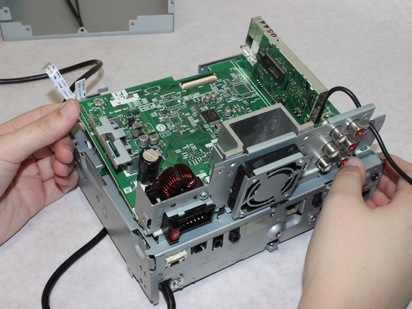

  5. Kenwood DNX571HD Satellite Antenna Connection Replacement: crwdns2935265:05crwdnd2935265:01crwdnd2935265:01crwdne2935265:0
    • Lift the CD drive carefully to expose the attached cable underneath.
  6. Kenwood DNX571HD Satellite Antenna Connection Replacement: crwdns2935265:06crwdnd2935265:01crwdnd2935265:02crwdne2935265:0 Kenwood DNX571HD Satellite Antenna Connection Replacement: crwdns2935265:06crwdnd2935265:02crwdnd2935265:02crwdne2935265:0
    • Flip up the black clasp with a spudger to disconnect the large white ribbon cable connecting the CD drive to the board underneath.

  11. Kenwood DNX571HD Satellite Antenna Connection Replacement: crwdns2935265:011crwdnd2935265:01crwdnd2935265:01crwdne2935265:0
    • Lift the top part of the unit up from the lower chassis.
  12. Kenwood DNX571HD Satellite Antenna Connection Replacement: crwdns2935265:012crwdnd2935265:01crwdnd2935265:02crwdne2935265:0 Kenwood DNX571HD Satellite Antenna Connection Replacement: crwdns2935265:012crwdnd2935265:02crwdnd2935265:02crwdne2935265:0
    • Remove the two 13mm long screws with a Phillips #1 screwdriver.
    • Gently thread the power cable through the circuit boards to separate the fan from the body of the stereo.
  13. Kenwood DNX571HD Satellite Antenna Connection Replacement, Satellite Antenna Connection: crwdns2935265:013crwdnd2935265:01crwdnd2935265:02crwdne2935265:0 Kenwood DNX571HD Satellite Antenna Connection Replacement, Satellite Antenna Connection: crwdns2935265:013crwdnd2935265:02crwdnd2935265:02crwdne2935265:0
    • Remove the four 5mm screws from the corners of the circuit board using a Phillips #1 screwdriver
    • Lift the circuit board from the rest of the assembly.
  14. Kenwood DNX571HD Satellite Antenna Connection Replacement: crwdns2935265:014crwdnd2935265:01crwdnd2935265:01crwdne2935265:0
    • Desolder the 12 leads to remove the connector from the circuit board.
    • There are ten leads in two parallel rows and two larger leads below them.
    • The satellite antenna is a thru-hole-mounted device. You must apply heat to each soldered pin individually and pull them out of the holes while the solder is molten.
    • The solder material, pins, and any surrounding material will get VERY hot while melting the connections. Do not touch any metal parts during the desoldering process and give the device time to cool off once you’re finished. It may also be good to take breaks so that the electronics aren’t kept hot for extended periods of time.
