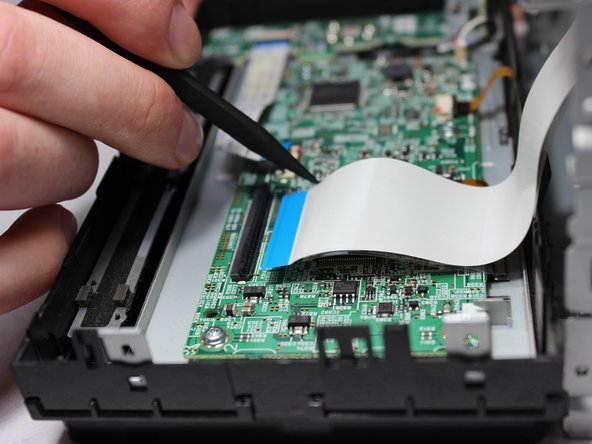

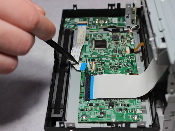

  4. Kenwood DNX571HD LCD Touch Screen Replacement: crwdns2935265:04crwdnd2935265:01crwdnd2935265:02crwdne2935265:0 Kenwood DNX571HD LCD Touch Screen Replacement: crwdns2935265:04crwdnd2935265:02crwdnd2935265:02crwdne2935265:0
    • Flip up the black clasp with the spudger to disconnect the small white ribbon cable from the main board.
  5. Kenwood DNX571HD LCD Touch Screen Replacement: crwdns2935265:05crwdnd2935265:01crwdnd2935265:02crwdne2935265:0 Kenwood DNX571HD LCD Touch Screen Replacement: crwdns2935265:05crwdnd2935265:02crwdnd2935265:02crwdne2935265:0
    • Flip up the black clasp with the spudger to disconnect the large white ribbon cable from the main board.

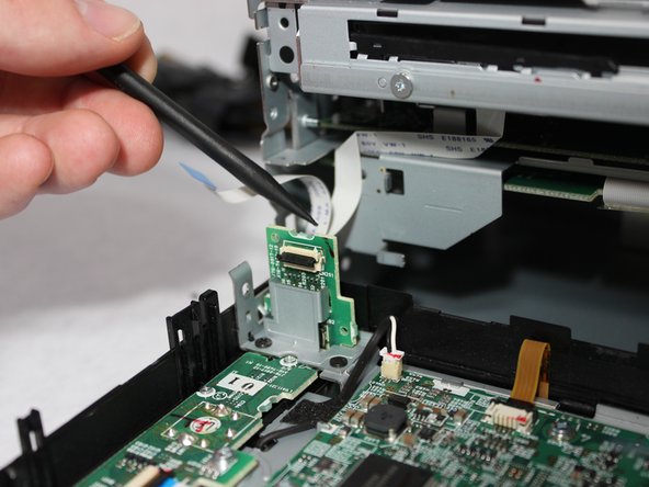

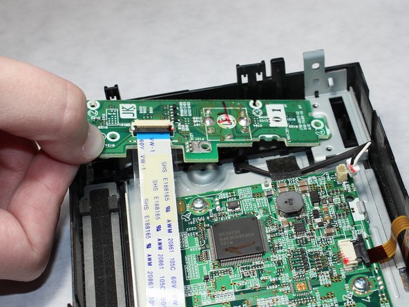

  6. Kenwood DNX571HD LCD Touch Screen Replacement: crwdns2935265:06crwdnd2935265:01crwdnd2935265:02crwdne2935265:0 Kenwood DNX571HD LCD Touch Screen Replacement: crwdns2935265:06crwdnd2935265:02crwdnd2935265:02crwdne2935265:0
    • Flip up the black clasp with the spudger to disconnect the small white ribbon cable from the vertical board.
    • Carefully pull the ribbon from the clasp with the spudger.

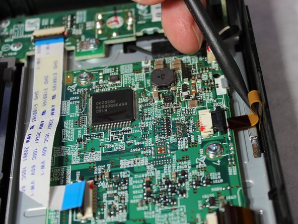

  8. Kenwood DNX571HD LCD Touch Screen Replacement: crwdns2935265:08crwdnd2935265:01crwdnd2935265:02crwdne2935265:0 Kenwood DNX571HD LCD Touch Screen Replacement: crwdns2935265:08crwdnd2935265:02crwdnd2935265:02crwdne2935265:0
    • Push out the black clasp with the spudger to disconnect the small orange ribbon cable from the main board.
    • Gently push the ribbon out of the clasp with the spudger.

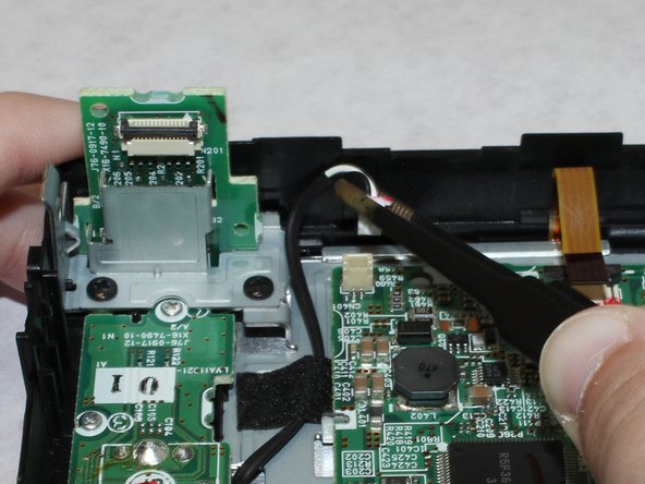

  9. Kenwood DNX571HD LCD Touch Screen Replacement: crwdns2935265:09crwdnd2935265:01crwdnd2935265:02crwdne2935265:0 Kenwood DNX571HD LCD Touch Screen Replacement: crwdns2935265:09crwdnd2935265:02crwdnd2935265:02crwdne2935265:0
    • Using a pair of tweezers, gently pull up on the connector for the power cable to disconnect it from the main board.

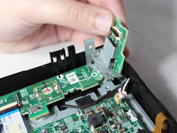

  10. Kenwood DNX571HD LCD Touch Screen Replacement: crwdns2935265:010crwdnd2935265:01crwdnd2935265:02crwdne2935265:0 Kenwood DNX571HD LCD Touch Screen Replacement: crwdns2935265:010crwdnd2935265:02crwdnd2935265:02crwdne2935265:0
    • Unscrew the two 4mm screws holding down the board that is standing vertically with a Phillips #1 screwdriver.
    • Pull up on the board to remove it.

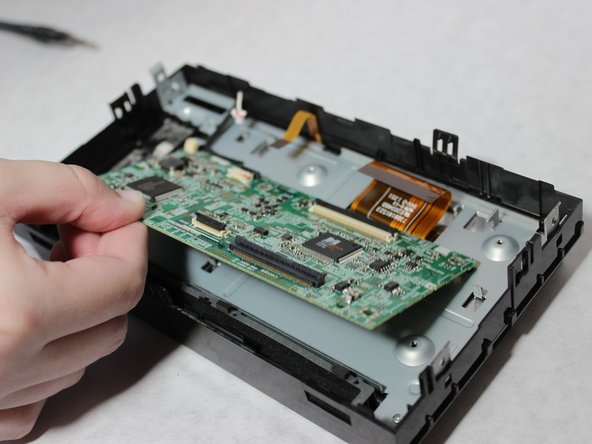

  11. Kenwood DNX571HD LCD Touch Screen Replacement: crwdns2935265:011crwdnd2935265:01crwdnd2935265:02crwdne2935265:0 Kenwood DNX571HD LCD Touch Screen Replacement: crwdns2935265:011crwdnd2935265:02crwdnd2935265:02crwdne2935265:0
    • Unscrew the four 5.5mm screws with a JIS #00 screwdriver.
    • Unscrew the 4mm screw with a Phillips #1 screwdriver.
    • Remove the disconnected circuit board.

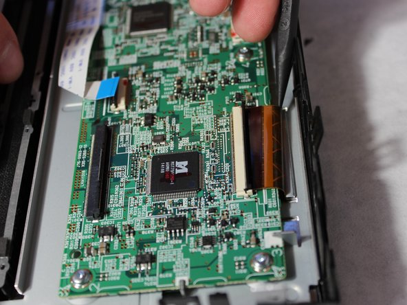

  12. Kenwood DNX571HD LCD Touch Screen Replacement: crwdns2935265:012crwdnd2935265:01crwdnd2935265:02crwdne2935265:0 Kenwood DNX571HD LCD Touch Screen Replacement: crwdns2935265:012crwdnd2935265:02crwdnd2935265:02crwdne2935265:0
    • Unscrew the four 4mm screws on the main board with a Phillips #1 screwdriver.
    • Gently lift the board out of the casing.

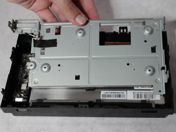

  14. Kenwood DNX571HD LCD Touch Screen Replacement: crwdns2935265:014crwdnd2935265:01crwdnd2935265:02crwdne2935265:0 Kenwood DNX571HD LCD Touch Screen Replacement: crwdns2935265:014crwdnd2935265:02crwdnd2935265:02crwdne2935265:0
    • Use the spudger to unhook the metal tabs and detach the metal plate from the plastic housing.
    • Place the spudger between the metal tab and the plastic case and gently lift the spudger away from the case.

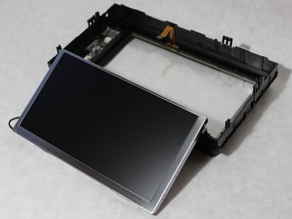

  15. Kenwood DNX571HD LCD Touch Screen Replacement: crwdns2935265:015crwdnd2935265:01crwdnd2935265:02crwdne2935265:0 Kenwood DNX571HD LCD Touch Screen Replacement: crwdns2935265:015crwdnd2935265:02crwdnd2935265:02crwdne2935265:0
    • Gently press the front of the screen to detach it from the plastic housing.
    • When removing the screen, gently flex out the plastic housing to help get the display past the plastic latch.
