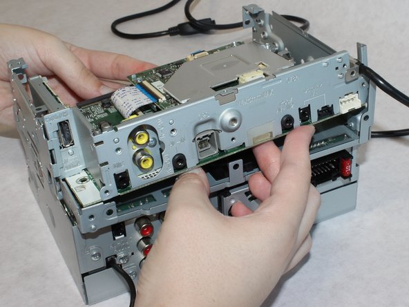

    • Lift the top part of the unit up from the lower chassis.

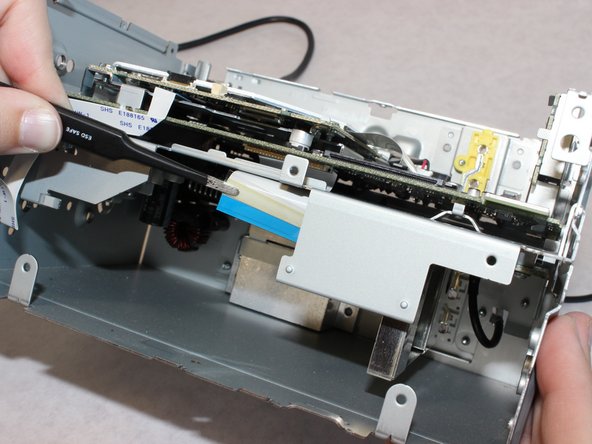

  12. Kenwood DNX571HD GPS Antenna Connection Replacement: crwdns2935265:012crwdnd2935265:01crwdnd2935265:02crwdne2935265:0 Kenwood DNX571HD GPS Antenna Connection Replacement: crwdns2935265:012crwdnd2935265:02crwdnd2935265:02crwdne2935265:0
    • Remove the two 13mm long screws with a Phillips #1 screwdriver.
    • Gently thread the power cable through the circuit boards to separate the fan from the body of the stereo.
  13. Kenwood DNX571HD GPS Antenna Connection Replacement, GPS Antenna Connection: crwdns2935265:013crwdnd2935265:01crwdnd2935265:02crwdne2935265:0 Kenwood DNX571HD GPS Antenna Connection Replacement, GPS Antenna Connection: crwdns2935265:013crwdnd2935265:02crwdnd2935265:02crwdne2935265:0
    • Using a spudger, undo the clasp to disconnect the large white ribbon cable.

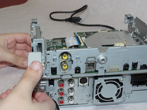

    • Remove the 5.5mm screw from the HDMI cable cover using a Phillips #2 screwdriver.
  17. Kenwood DNX571HD GPS Antenna Connection Replacement: crwdns2935265:017crwdnd2935265:01crwdnd2935265:01crwdne2935265:0
    • Remove the 5mm screw with a Phillips #1 screwdriver.
  18. Kenwood DNX571HD GPS Antenna Connection Replacement: crwdns2935265:018crwdnd2935265:01crwdnd2935265:02crwdne2935265:0 Kenwood DNX571HD GPS Antenna Connection Replacement: crwdns2935265:018crwdnd2935265:02crwdnd2935265:02crwdne2935265:0
    • Remove the two 5.5mm screws from the back.
    • Lift the upper portion of the stereo free from the chassis.

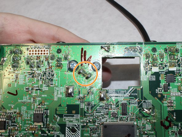

    • Remove the two screws underneath the GPS connector.
    • Desolder the GPS connector.
    • The GPS antenna is a thru-hole-mounted device. You must apply heat to each soldered pin individually and pull them out of the holes while the solder is molten.
    • The solder material, pins, and any surrounding material will get VERY hot while melting the connections. Do not touch any metal parts during the desoldering process and give the device time to cool off once you’re finished. It may also be good to take breaks so that the electronics aren’t kept hot for extended periods of time.
  20. Kenwood DNX571HD GPS Antenna Connection Replacement: crwdns2935265:020crwdnd2935265:01crwdnd2935265:01crwdne2935265:0
    • To remove and reinsert the connector, on the top side of the board, use your finger to gently lift the metal plate to get enough clearance.
