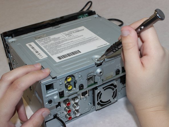

    • Unscrew the four 3.5mm side screws with a Phillips #1 screwdriver.
    • There are two screws per side.

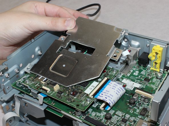

  8. Kenwood DNX571HD Cooling Fan Replacement: crwdns2935265:08crwdnd2935265:01crwdnd2935265:02crwdne2935265:0 Kenwood DNX571HD Cooling Fan Replacement: crwdns2935265:08crwdnd2935265:02crwdnd2935265:02crwdne2935265:0
    • Unscrew the three 5mm length screws with the Phillips #1 screwdriver.
    • Remove the metal plate
    • Removing the plate will damage the heat sink compound. This will need to be replaced during reassembly.
