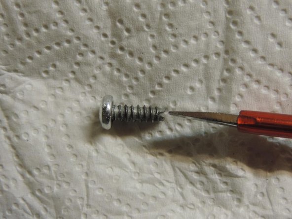

  6. Kenwood Chef Gear Drive SER1018 Replacement, Challenge: Unscrew hidden screw: crwdns2935265:06crwdnd2935265:01crwdnd2935265:02crwdne2935265:0 Kenwood Chef Gear Drive SER1018 Replacement, Challenge: Unscrew hidden screw: crwdns2935265:06crwdnd2935265:02crwdnd2935265:02crwdne2935265:0
    • According to "Jens" the plastic wheel can be removed by turnig it counter-clockwise when the gear is blocked. "Julien" found a YouTube-Video showing how to proceed. Starting at 7:25. Thank you to Jens and Julien.
    • No need to proceed with the custom tool if the plastic wheel has already been removed in the previous step
    • The tricky part is to unscrew the Tx20 screw located under the plastic wheel
    • I was not able to pull the plastic wheel from the shaft
    • If you like the risk you might drill a hole in the plastic wheel for easy access
    • I used a custom tool -> see next step

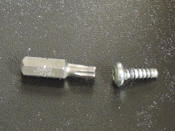

  7. Kenwood Chef Gear Drive SER1018 Replacement, Custom tooling: crwdns2935265:07crwdnd2935265:01crwdnd2935265:03crwdne2935265:0 Kenwood Chef Gear Drive SER1018 Replacement, Custom tooling: crwdns2935265:07crwdnd2935265:02crwdnd2935265:03crwdne2935265:0 Kenwood Chef Gear Drive SER1018 Replacement, Custom tooling: crwdns2935265:07crwdnd2935265:03crwdnd2935265:03crwdne2935265:0
    • I machined a 6 mm wrench to fit on the Tx20 bit
    • After removal I slotted the screw for easier mounting

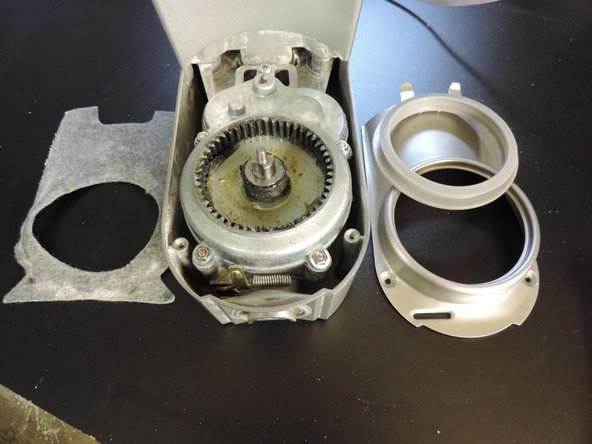

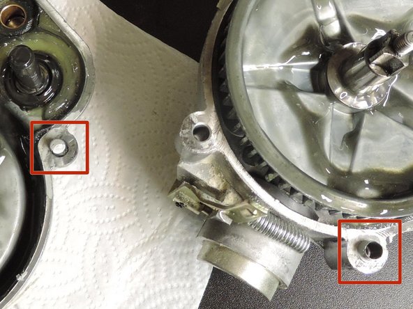

  8. Kenwood Chef Gear Drive SER1018 Replacement, Open gear box: crwdns2935265:08crwdnd2935265:01crwdnd2935265:02crwdne2935265:0 Kenwood Chef Gear Drive SER1018 Replacement, Open gear box: crwdns2935265:08crwdnd2935265:02crwdnd2935265:02crwdne2935265:0

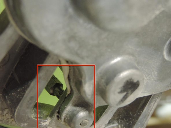

    • Take care of the guides (red markers). They can be pushed in after closing the gear box
    • Take away the sealing. To reseal I used sealant normally used in washing rooms.

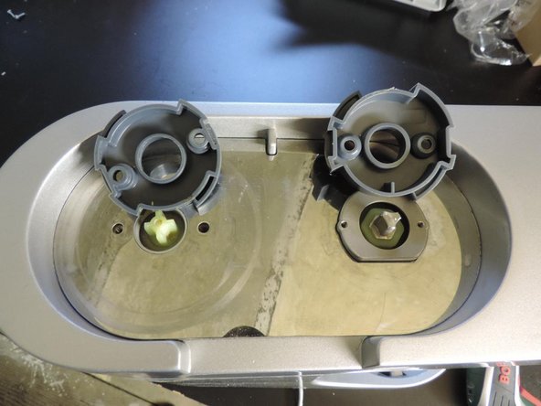

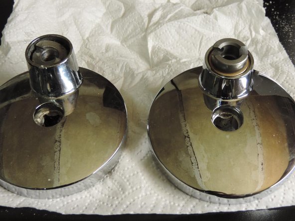

  9. Kenwood Chef Gear Drive SER1018 Replacement, Planet Hub: crwdns2935265:09crwdnd2935265:01crwdnd2935265:03crwdne2935265:0 Kenwood Chef Gear Drive SER1018 Replacement, Planet Hub: crwdns2935265:09crwdnd2935265:02crwdnd2935265:03crwdne2935265:0 Kenwood Chef Gear Drive SER1018 Replacement, Planet Hub: crwdns2935265:09crwdnd2935265:03crwdnd2935265:03crwdne2935265:0
    • The one with the cross is the old one
    • The bayonet doesn't look the same but the tools fits as before. The position of beater and whisk stay the same in respect to the bowl
    • The thickness change of the gearwheel doesn't seem to matter

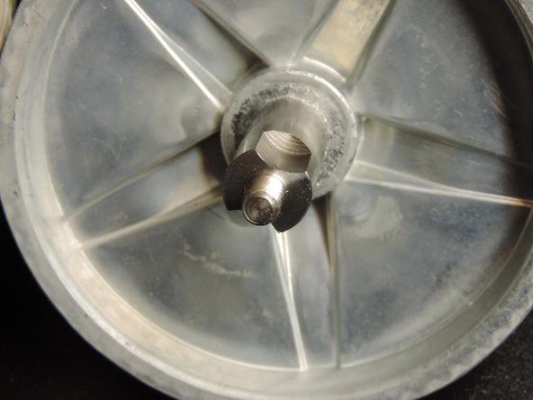

    • Label and part designated "Planet Hub Nut"

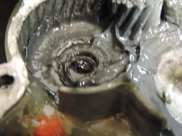

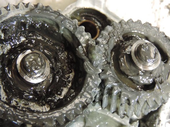

  13. Kenwood Chef Gear Drive SER1018 Replacement, Assemble the Gear Box: crwdns2935265:013crwdnd2935265:01crwdnd2935265:02crwdne2935265:0 Kenwood Chef Gear Drive SER1018 Replacement, Assemble the Gear Box: crwdns2935265:013crwdnd2935265:02crwdnd2935265:02crwdne2935265:0
    • There is plenty of grease. Put it on the parts to be greased.
    • Put sealant on the box (see step 8)
    • Place the machine upright standing in the normal working position with lowered arm. The front axle will fall out if the arm is in the upper position.
    • Gently slip the lower part in the upper part
    • As the screws were loose when disassembling, I put a drop of thread locker before mounting.
    • Mount the guides in the correct place
