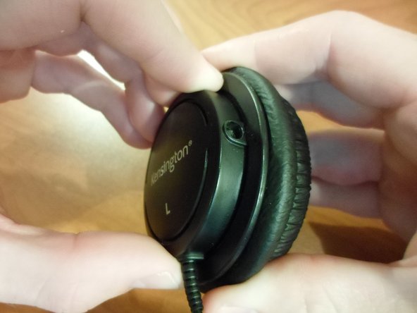

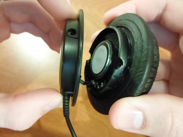

  3. Kensington Hi-Fi Headphones 33137 Speakers: crwdns2935265:03crwdnd2935265:01crwdnd2935265:03crwdne2935265:0 Kensington Hi-Fi Headphones 33137 Speakers: crwdns2935265:03crwdnd2935265:02crwdnd2935265:03crwdne2935265:0 Kensington Hi-Fi Headphones 33137 Speakers: crwdns2935265:03crwdnd2935265:03crwdnd2935265:03crwdne2935265:0
    • Hold the speaker cover in one hand and the speaker ear-padding in the other.
    • Turn the speaker cover counter-clockwise until it stops turning.
    • Pull the speaker cover and the speaker ear padding apart to expose the inner components of the speaker.
    • Make sure to pull the speakers apart gently to avoid disconnecting the speaker cable wires from the speaker.
    • If the speaker cover and ear-padding don't easily come apart, then make sure the speaker cover is fully turned.
    • Repeat this process for both speakers.

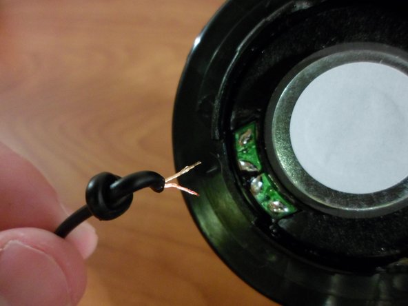

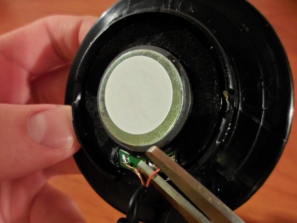

  4. Kensington Hi-Fi Headphones 33137 Speakers, Speakers: crwdns2935265:04crwdnd2935265:01crwdnd2935265:03crwdne2935265:0 Kensington Hi-Fi Headphones 33137 Speakers, Speakers: crwdns2935265:04crwdnd2935265:02crwdnd2935265:03crwdne2935265:0 Kensington Hi-Fi Headphones 33137 Speakers, Speakers: crwdns2935265:04crwdnd2935265:03crwdnd2935265:03crwdne2935265:0
    • With the internal speaker component exposed, the wires connecting the speakers to the speaker cable can be cut.
    • Reassembly after cutting the speaker cable wires will require soldering. Proceed with caution. See Kensington Hi-Fi Headphones 33137 Speaker Cable Replacement.
    • Cut each of the wires connecting the speaker to the speaker cable.
    • Repeat this process for each speaker.
