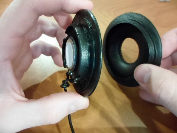

    • Hold the speaker cover in one hand and the speaker ear-padding in the other.
    • Turn the speaker cover counter-clockwise until it stops turning.
    • Pull the speaker cover and the speaker ear padding apart to expose the inner components of the speaker.
    • Make sure to pull the speakers apart gently to avoid disconnecting the speaker cable wires from the speaker.
    • If the speaker cover and ear-padding don't easily come apart, then make sure the speaker cover is fully turned.
    • Repeat this process for both speakers.

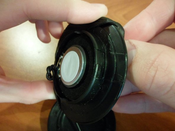

  4. Kensington Hi-Fi Headphones 33137 Speaker Ear-Pad, Speaker Ear-Pad: crwdns2935265:04crwdnd2935265:01crwdnd2935265:03crwdne2935265:0 Kensington Hi-Fi Headphones 33137 Speaker Ear-Pad, Speaker Ear-Pad: crwdns2935265:04crwdnd2935265:02crwdnd2935265:03crwdne2935265:0 Kensington Hi-Fi Headphones 33137 Speaker Ear-Pad, Speaker Ear-Pad: crwdns2935265:04crwdnd2935265:03crwdnd2935265:03crwdne2935265:0
    • After the speaker cover has been removed, hold the edge of the speaker ear-pad with fingers.
    • Gently pull the edge of the speaker ear-pad around the edge of the speaker.
    • To avoid tearing the speaker ear-pad, don't use too much force when pulling it around the edge of the speaker.
    • Repeat this process for the other speaker ear-padding.
