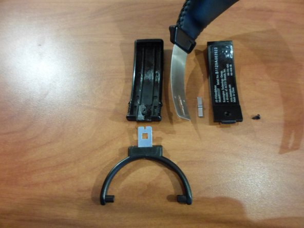

  3. Kensington Hi-Fi Headphones 33137 Headband: crwdns2935265:03crwdnd2935265:01crwdnd2935265:02crwdne2935265:0 Kensington Hi-Fi Headphones 33137 Headband: crwdns2935265:03crwdnd2935265:02crwdnd2935265:02crwdne2935265:0
    • This picture shows the headphones with the speakers detached. Steps 1 and 2 are not necessary to replace the headband covers, however they do make the process easier.
    • Turn the headphones so that the inner headphone cover is visible.
  4. Kensington Hi-Fi Headphones 33137 Headband: crwdns2935265:04crwdnd2935265:01crwdnd2935265:02crwdne2935265:0 Kensington Hi-Fi Headphones 33137 Headband: crwdns2935265:04crwdnd2935265:02crwdnd2935265:02crwdne2935265:0
    • Use the Phillips #00 screwdriver to loosen and remove the screw holding the inner headphone cover in place.
    • The screw dimensions are as follows: Length to Head = 4 mm, Head Length = 1.5 mm, Head Diameter = 3.5 mm, Major Diameter = 2 mm, Pitch = 0.5 mm.
    • All steps can be followed on both the left or right side of the headphones to remove inner coverings.
  5. Kensington Hi-Fi Headphones 33137 Headband: crwdns2935265:05crwdnd2935265:01crwdnd2935265:03crwdne2935265:0 Kensington Hi-Fi Headphones 33137 Headband: crwdns2935265:05crwdnd2935265:02crwdnd2935265:03crwdne2935265:0 Kensington Hi-Fi Headphones 33137 Headband: crwdns2935265:05crwdnd2935265:03crwdnd2935265:03crwdne2935265:0
    • Use the screwdriver to pry the inner headband covering loose.
    • Do not push the inner covering panel too hard, or the plastic will break. Only apply enough pressure to lift the panel up slightly.
    • Once the inner covering is loose, pull it free from the headband with your fingers and set it aside.
    • Make sure to pull the inner cover free gently do avoid losing the adjustment piece within the cover. It falls out easily and can be lost.

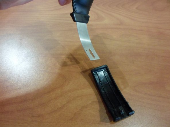

  6. Kensington Hi-Fi Headphones 33137 Headband, Speaker Clamp: crwdns2935265:06crwdnd2935265:01crwdnd2935265:03crwdne2935265:0 Kensington Hi-Fi Headphones 33137 Headband, Speaker Clamp: crwdns2935265:06crwdnd2935265:02crwdnd2935265:03crwdne2935265:0 Kensington Hi-Fi Headphones 33137 Headband, Speaker Clamp: crwdns2935265:06crwdnd2935265:03crwdnd2935265:03crwdne2935265:0
    • Turn the headphones so that the inner tab of the speaker clamp where it attaches to the headband can be seen.
    • Pull the speaker clamp so that the metal lifts free of the headband.
  7. Kensington Hi-Fi Headphones 33137 Headband: crwdns2935265:07crwdnd2935265:01crwdnd2935265:01crwdne2935265:0
    • Remove the speaker clamp.
    • All steps can be followed on either the left or right arm of the headphones to remove speaker clamps.
  8. Kensington Hi-Fi Headphones 33137 Headband, Headband Adjustment Piece: crwdns2935265:08crwdnd2935265:01crwdnd2935265:02crwdne2935265:0 Kensington Hi-Fi Headphones 33137 Headband, Headband Adjustment Piece: crwdns2935265:08crwdnd2935265:02crwdnd2935265:02crwdne2935265:0
    • Turn the headphones so that the metal pieces inside the headband covering can be seen.
  9. Kensington Hi-Fi Headphones 33137 Headband: crwdns2935265:09crwdnd2935265:01crwdnd2935265:02crwdne2935265:0 Kensington Hi-Fi Headphones 33137 Headband: crwdns2935265:09crwdnd2935265:02crwdnd2935265:02crwdne2935265:0
    • With your fingers, lift the small metal headband adjustment piece.
    • Remove the piece and set it aside.
    • All steps can be followed on either the left or right arm of the headphones to remove adjustment pieces.

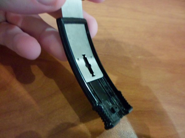

  10. Kensington Hi-Fi Headphones 33137 Headband, Headband: crwdns2935265:010crwdnd2935265:01crwdnd2935265:02crwdne2935265:0 Kensington Hi-Fi Headphones 33137 Headband, Headband: crwdns2935265:010crwdnd2935265:02crwdnd2935265:02crwdne2935265:0
    • Turn the headphones so that the metal part of the headband located inside the outer covering can be seen.
  11. Kensington Hi-Fi Headphones 33137 Headband: crwdns2935265:011crwdnd2935265:01crwdnd2935265:03crwdne2935265:0 Kensington Hi-Fi Headphones 33137 Headband: crwdns2935265:011crwdnd2935265:02crwdnd2935265:03crwdne2935265:0 Kensington Hi-Fi Headphones 33137 Headband: crwdns2935265:011crwdnd2935265:03crwdnd2935265:03crwdne2935265:0
    • With your fingers, pull the metal arm of the headband free of the plastic outer covering.
    • Set the outer covering aside.
  12. Kensington Hi-Fi Headphones 33137 Headband: crwdns2935265:012crwdnd2935265:01crwdnd2935265:01crwdne2935265:0
    • All steps must be followed on both the left and right arms of the headband to free it completely from the outer coverings.
