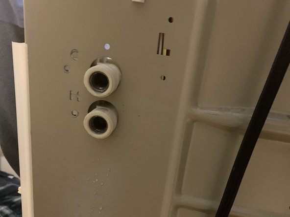

  3. Kenmore 80 Series Washer Water Inlet Valve Replacement, Disconnect water hoses (hot and cold): crwdns2935265:03crwdnd2935265:01crwdnd2935265:01crwdne2935265:0
    • Use the groove joint pliers to remove the hot and cold water hoses in a counter-clockwise rotation.
    • Place removed hoses in a bucket to catch the leaking residual water.

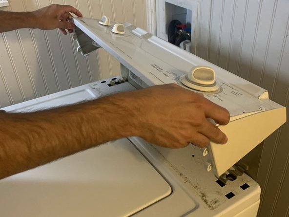

  4. Kenmore 80 Series Washer Water Inlet Valve Replacement, Move the control panel out of the way: crwdns2935265:04crwdnd2935265:01crwdnd2935265:03crwdne2935265:0 Kenmore 80 Series Washer Water Inlet Valve Replacement, Move the control panel out of the way: crwdns2935265:04crwdnd2935265:02crwdnd2935265:03crwdne2935265:0 Kenmore 80 Series Washer Water Inlet Valve Replacement, Move the control panel out of the way: crwdns2935265:04crwdnd2935265:03crwdnd2935265:03crwdne2935265:0
    • Remove plastic endcaps at either end.
    • Unscrew the screws at either end using the Phillips head screwdriver.
    • Rotate the panel up.

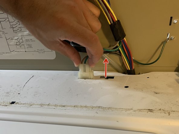

  5. Kenmore 80 Series Washer Water Inlet Valve Replacement, Unplug wire connector: crwdns2935265:05crwdnd2935265:01crwdnd2935265:02crwdne2935265:0 Kenmore 80 Series Washer Water Inlet Valve Replacement, Unplug wire connector: crwdns2935265:05crwdnd2935265:02crwdnd2935265:02crwdne2935265:0
    • Press sides of upper-connector and pull upwards.

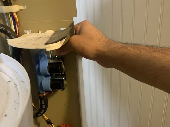

  7. Kenmore 80 Series Washer Water Inlet Valve Replacement, Tilt cabinet towards you: crwdns2935265:07crwdnd2935265:01crwdnd2935265:03crwdne2935265:0 Kenmore 80 Series Washer Water Inlet Valve Replacement, Tilt cabinet towards you: crwdns2935265:07crwdnd2935265:02crwdnd2935265:03crwdne2935265:0 Kenmore 80 Series Washer Water Inlet Valve Replacement, Tilt cabinet towards you: crwdns2935265:07crwdnd2935265:03crwdnd2935265:03crwdne2935265:0
    • Slide out and remove the shell of the washer.

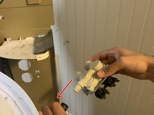

  8. Kenmore 80 Series Washer Water Inlet Valve Replacement, Remove wire connectors from valve (hot and cold): crwdns2935265:08crwdnd2935265:01crwdnd2935265:02crwdne2935265:0 Kenmore 80 Series Washer Water Inlet Valve Replacement, Remove wire connectors from valve (hot and cold): crwdns2935265:08crwdnd2935265:02crwdnd2935265:02crwdne2935265:0
    • Pull connectors directly towards you.
    • Properly distinguish hot(red) and cold (white) connectors.

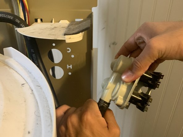

  9. Kenmore 80 Series Washer Water Inlet Valve Replacement, Remove mounting screws: crwdns2935265:09crwdnd2935265:01crwdnd2935265:03crwdne2935265:0 Kenmore 80 Series Washer Water Inlet Valve Replacement, Remove mounting screws: crwdns2935265:09crwdnd2935265:02crwdnd2935265:03crwdne2935265:0 Kenmore 80 Series Washer Water Inlet Valve Replacement, Remove mounting screws: crwdns2935265:09crwdnd2935265:03crwdnd2935265:03crwdne2935265:0
    • Use the 5/16” nutdriver to unscrew both mounting screws.
  10. Kenmore 80 Series Washer Water Inlet Valve Replacement, Remove clamp from interior water hose: crwdns2935265:010crwdnd2935265:01crwdnd2935265:03crwdne2935265:0 Kenmore 80 Series Washer Water Inlet Valve Replacement, Remove clamp from interior water hose: crwdns2935265:010crwdnd2935265:02crwdnd2935265:03crwdne2935265:0 Kenmore 80 Series Washer Water Inlet Valve Replacement, Remove clamp from interior water hose: crwdns2935265:010crwdnd2935265:03crwdnd2935265:03crwdne2935265:0
    • Use the groove joint pliers to press clamp and slide down from water hose.
    • Remove valve out from back panel.
    • Remove interior water hose from inlet water valve.
  11. Kenmore 80 Series Washer Water Inlet Valve Replacement, Install new water inlet valve: crwdns2935265:011crwdnd2935265:01crwdnd2935265:03crwdne2935265:0 Kenmore 80 Series Washer Water Inlet Valve Replacement, Install new water inlet valve: crwdns2935265:011crwdnd2935265:02crwdnd2935265:03crwdne2935265:0 Kenmore 80 Series Washer Water Inlet Valve Replacement, Install new water inlet valve: crwdns2935265:011crwdnd2935265:03crwdnd2935265:03crwdne2935265:0
    • Slide the interior water hose over the water inlet valve.
    • Use groove joint pliers to depress the clamp and secure the water hose to the valve.
