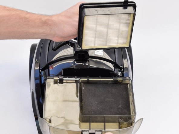

Learn how to properly remove the dustbin filter on your Kenmore 78423.
    1. Kenmore 78423 Dustbin filter Replacement, Dust Bin: crwdns2935265:01crwdnd2935265:01crwdnd2935265:02crwdne2935265:0 Kenmore 78423 Dustbin filter Replacement, Dust Bin: crwdns2935265:01crwdnd2935265:02crwdnd2935265:02crwdne2935265:0
      • Grab the dustbin handle, press and hold the button at the top of the handle.
      • Pull the dustbin up and away from the main body.
    2. Kenmore 78423 Dustbin filter Replacement: crwdns2935265:02crwdnd2935265:01crwdnd2935265:02crwdne2935265:0 Kenmore 78423 Dustbin filter Replacement: crwdns2935265:02crwdnd2935265:02crwdnd2935265:02crwdne2935265:0
      • Press the button located beneath the circular opening on the dust bin; this will open the bottom of the dustbin.
      • Properly dispose any contents of the dust bin into a wastebasket.
    1. Kenmore 78423 Dustbin filter Replacement, Dustbin Filters: crwdns2935265:03crwdnd2935265:01crwdnd2935265:03crwdne2935265:0 Kenmore 78423 Dustbin filter Replacement, Dustbin Filters: crwdns2935265:03crwdnd2935265:02crwdnd2935265:03crwdne2935265:0 Kenmore 78423 Dustbin filter Replacement, Dustbin Filters: crwdns2935265:03crwdnd2935265:03crwdnd2935265:03crwdne2935265:0
      • Pinch and grasp the raised handle on the primary dustbin filter.
      • Lift the primary dustbin filter up and away from the dustbin and place it to the side.
    2. Kenmore 78423 Dustbin filter Replacement: crwdns2935265:04crwdnd2935265:01crwdnd2935265:02crwdne2935265:0 Kenmore 78423 Dustbin filter Replacement: crwdns2935265:04crwdnd2935265:02crwdnd2935265:02crwdne2935265:0
      • Grasp the foam filter and lift up to remove.
      • The foam filter may be lodged inside of the primary dustbin filter. In this case, both filters may be removed at the same time.
