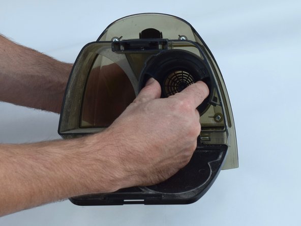

Kenmore 78423 Dustbin fiber collector Replacement
  1. Kenmore 78423 Dustbin fiber collector Replacement, Dust Bin: crwdns2935265:01crwdnd2935265:01crwdnd2935265:02crwdne2935265:0 Kenmore 78423 Dustbin fiber collector Replacement, Dust Bin: crwdns2935265:01crwdnd2935265:02crwdnd2935265:02crwdne2935265:0
    • Grab the dustbin handle, press and hold the button at the top of the handle.
    • Pull the dustbin up and away from the main body.
  2. Kenmore 78423 Dustbin fiber collector Replacement: crwdns2935265:02crwdnd2935265:01crwdnd2935265:02crwdne2935265:0 Kenmore 78423 Dustbin fiber collector Replacement: crwdns2935265:02crwdnd2935265:02crwdnd2935265:02crwdne2935265:0
    • Press the button located beneath the circular opening on the dust bin; this will open the bottom of the dustbin.
    • Properly dispose any contents of the dust bin into a wastebasket.
  3. Kenmore 78423 Dustbin fiber collector Replacement, Dustbin fiber collector: crwdns2935265:03crwdnd2935265:01crwdnd2935265:03crwdne2935265:0 Kenmore 78423 Dustbin fiber collector Replacement, Dustbin fiber collector: crwdns2935265:03crwdnd2935265:02crwdnd2935265:03crwdne2935265:0 Kenmore 78423 Dustbin fiber collector Replacement, Dustbin fiber collector: crwdns2935265:03crwdnd2935265:03crwdnd2935265:03crwdne2935265:0
    • Grab the fiber collector using the finger holes on both sides of the base.
    • The fiber collector is the black basket with the rounded base
    • Turn the base a quarter-turn clockwise and pull it away from the dustbin
    • Remove the fiber and hair that may be stuck inside the fiber collector

thank you for your help. My sister in law didn’t have the manual, its typical of her husband. without the manual I probably would have broken the fiber collector. Appreciate your help.
