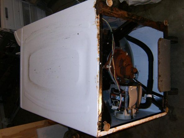

    • For ease of working on the bottom parts, lay the washer on its side.
  4. Kenmore 400 Washer clutch band Replacement: crwdns2935265:04crwdnd2935265:01crwdnd2935265:03crwdne2935265:0 Kenmore 400 Washer clutch band Replacement: crwdns2935265:04crwdnd2935265:02crwdnd2935265:03crwdne2935265:0 Kenmore 400 Washer clutch band Replacement: crwdns2935265:04crwdnd2935265:03crwdnd2935265:03crwdne2935265:0
    • Main parts of the assembly include
    • Drain pump
    • Motor
    • Transmission
    • This is a direct drive model. No belts but a motor coupler connects the motor to transmission. Check for any cracks etc.

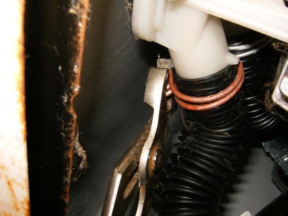

    • Drain lines from the drum and drain hose are connected to the pump with spring clamps.
    • Using a pair of pliers and squeezinge the opposite ends of the clamps together will loosen the clamp.
  6. Kenmore 400 Washer clutch band Replacement: crwdns2935265:06crwdnd2935265:01crwdnd2935265:03crwdne2935265:0 Kenmore 400 Washer clutch band Replacement: crwdns2935265:06crwdnd2935265:02crwdnd2935265:03crwdne2935265:0 Kenmore 400 Washer clutch band Replacement: crwdns2935265:06crwdnd2935265:03crwdnd2935265:03crwdne2935265:0
    • Pull the drain hose of the pump
    • Remove the tub-to-pump hose the same way

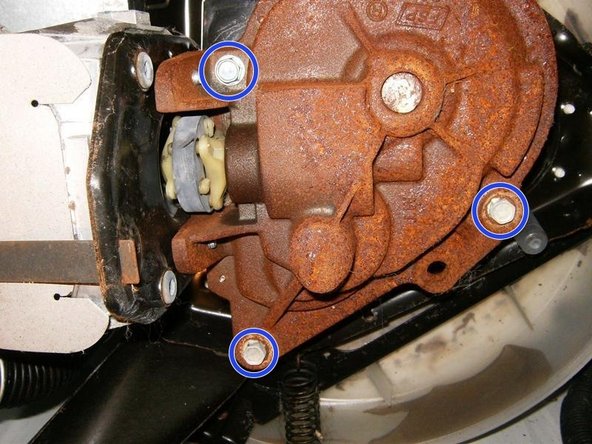

    • Remove the three 1/2inch bolts.
  7. Kenmore 400 Washer clutch band Replacement: crwdns2935265:07crwdnd2935265:01crwdnd2935265:03crwdne2935265:0 Kenmore 400 Washer clutch band Replacement: crwdns2935265:07crwdnd2935265:02crwdnd2935265:03crwdne2935265:0 Kenmore 400 Washer clutch band Replacement: crwdns2935265:07crwdnd2935265:03crwdnd2935265:03crwdne2935265:0
    • Here are the three bolts. They are 5/16 by 11/16 with a 1/2 inch hex head.
    • With the three bolts removed, pull the complete assembly out of the drum

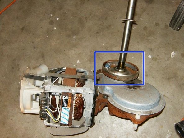

    • With the assembly removed, the clutch is now completely visible.
  8. Kenmore 400 Washer clutch band Replacement: crwdns2935265:08crwdnd2935265:01crwdnd2935265:03crwdne2935265:0 Kenmore 400 Washer clutch band Replacement: crwdns2935265:08crwdnd2935265:02crwdnd2935265:03crwdne2935265:0 Kenmore 400 Washer clutch band Replacement: crwdns2935265:08crwdnd2935265:03crwdnd2935265:03crwdne2935265:0

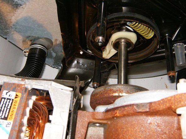

    • It is not necessary to replace the whole clutch. For this repair only the clutch band needs to be replaced
    • Using a pair of pliers to compress the spring will loosen the clutch band.
    • Lift the clutch band out of the clutch housing
    • Clutch band removed. Replace with model specific part.
