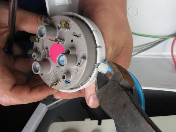

Kenmore 110 Series Washing Machine Water Level Sensor Replacement
    1. Kenmore 110 Series Washing Machine Water Level Sensor Replacement, Water Level Sensor: crwdns2935265:01crwdnd2935265:01crwdnd2935265:01crwdne2935265:0
      • Caution: Hazardous situation which, if not avoided, could result in minor or moderate injury. Unplug the washing machine!
      • Using a 5/16" socket wrench or an adjustable wrench, remove the three screws from the top rear of the washer.
      • Lifting from the rear, remove the top panel.
      • The top panel will still be connected by wires and hoses. It will help if you have a flat raised surface to set the top panel on.
    2. Kenmore 110 Series Washing Machine Water Level Sensor Replacement: crwdns2935265:02crwdnd2935265:01crwdnd2935265:03crwdne2935265:0 Kenmore 110 Series Washing Machine Water Level Sensor Replacement: crwdns2935265:02crwdnd2935265:02crwdnd2935265:03crwdne2935265:0 Kenmore 110 Series Washing Machine Water Level Sensor Replacement: crwdns2935265:02crwdnd2935265:03crwdnd2935265:03crwdne2935265:0
      • Using a 5/16" socket wrench or a hand wrench, remove the two screws from the component cover.
      • From the bottom, pull out and remove the component cover.
    3. Kenmore 110 Series Washing Machine Water Level Sensor Replacement: crwdns2935265:03crwdnd2935265:01crwdnd2935265:03crwdne2935265:0 Kenmore 110 Series Washing Machine Water Level Sensor Replacement: crwdns2935265:03crwdnd2935265:02crwdnd2935265:03crwdne2935265:0 Kenmore 110 Series Washing Machine Water Level Sensor Replacement: crwdns2935265:03crwdnd2935265:03crwdnd2935265:03crwdne2935265:0
      • Remove wires from water level sensor.
      • With a Phillips screwdriver remove the mounting screw.
      • Cut the zip tie and remove water level hose.
