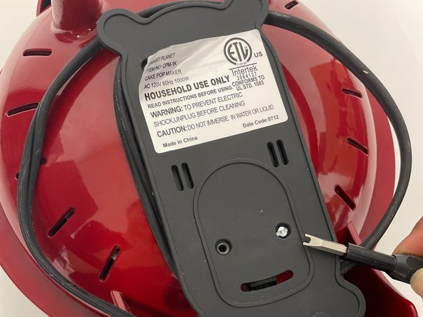

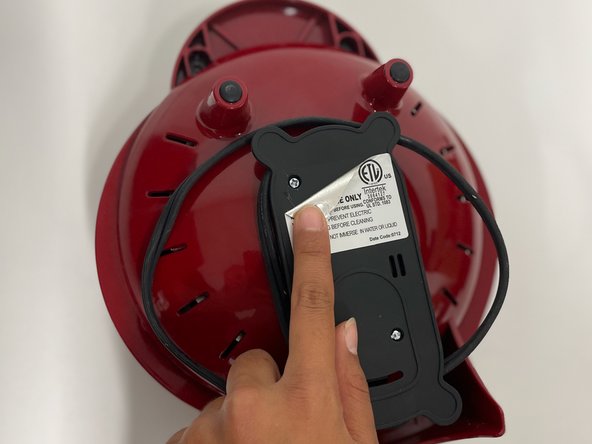

    • Remove three 11 mm screws from the back panel using a Phillips #2 screwdriver.
    • Two screws are underneath the sticker.
    • Remove the single 11 mm using a 3.0 spanner head screwdriver.

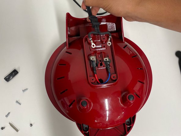

  2. Keebler Uncommonly Good Cake Pop Maker CPM-1K Disassembly: crwdns2935265:02crwdnd2935265:01crwdnd2935265:02crwdne2935265:0 Keebler Uncommonly Good Cake Pop Maker CPM-1K Disassembly: crwdns2935265:02crwdnd2935265:02crwdnd2935265:02crwdne2935265:0
    • Remove the back panel.
    • Remove the two black 8 mm screws with a Phillips #2 screwdriver.
    • Remove the two silver 7 mm screws with washers using a Phillips #2 screwdriver.

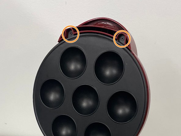

  3. Keebler Uncommonly Good Cake Pop Maker CPM-1K Disassembly: crwdns2935265:03crwdnd2935265:01crwdnd2935265:02crwdne2935265:0 Keebler Uncommonly Good Cake Pop Maker CPM-1K Disassembly: crwdns2935265:03crwdnd2935265:02crwdnd2935265:02crwdne2935265:0
    • Open the cake pop maker to expose the heating plates.
    • Remove the four 7 mm black screws located near the hinge where the device opens using a Phillips #2 screwdriver.
    • Remove the two 7 mm black screws at the front of the top plate using a Phillips #2 screwdriver.

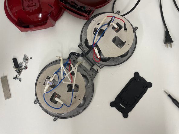

  4. Keebler Uncommonly Good Cake Pop Maker CPM-1K Disassembly: crwdns2935265:04crwdnd2935265:01crwdnd2935265:02crwdne2935265:0 Keebler Uncommonly Good Cake Pop Maker CPM-1K Disassembly: crwdns2935265:04crwdnd2935265:02crwdnd2935265:02crwdne2935265:0
    • Remove the bottom piece of the shell and lift up the top piece.
    • Remove the two 7 mm screws using a Phillips #2 screwdriver.
    • Fully remove the top piece.

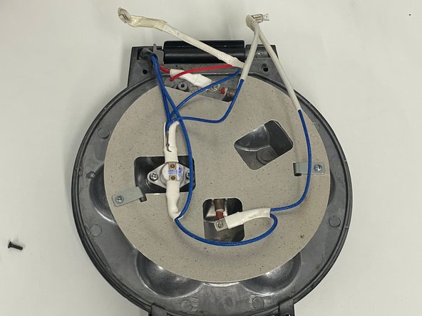

  5. Keebler Uncommonly Good Cake Pop Maker CPM-1K Disassembly: crwdns2935265:05crwdnd2935265:01crwdnd2935265:02crwdne2935265:0 Keebler Uncommonly Good Cake Pop Maker CPM-1K Disassembly: crwdns2935265:05crwdnd2935265:02crwdnd2935265:02crwdne2935265:0
    • Remove the two 6 mm screws with washers using a Phillips #2 screwdriver.
    • Remove the two 4 mm screws and small metal plates on either side of the device using a Phillips #2 screwdriver.
    • Repeat this process for the bottom plate.
