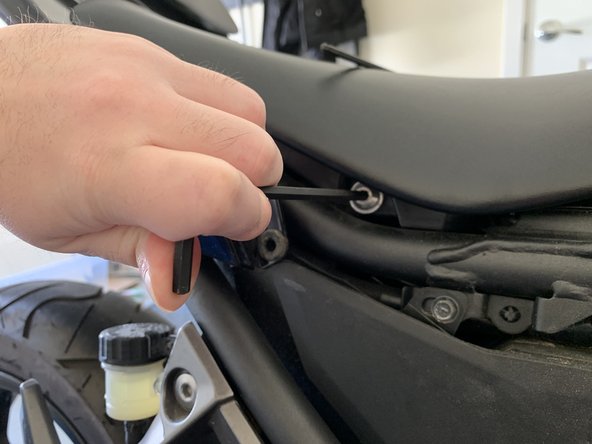

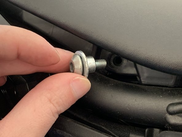

    • Locate the bolt holding the side seat cover in place and remove it using a 4mm hex key.
    • Make sure to also remove the bolt's washer.
