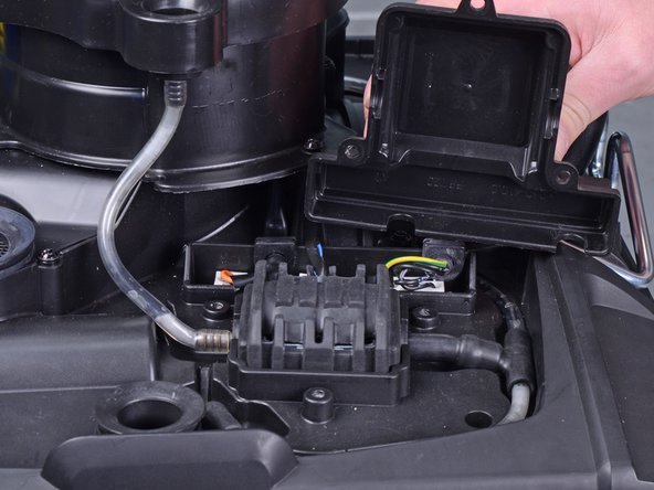

  3. Karcher Rotary Floor Cleaner 17833080 2017 Pump Replacement, Remove the pump cover: crwdns2935265:03crwdnd2935265:01crwdnd2935265:01crwdne2935265:0
    • Use a T20 driver to remove the three screws securing the pump cover.

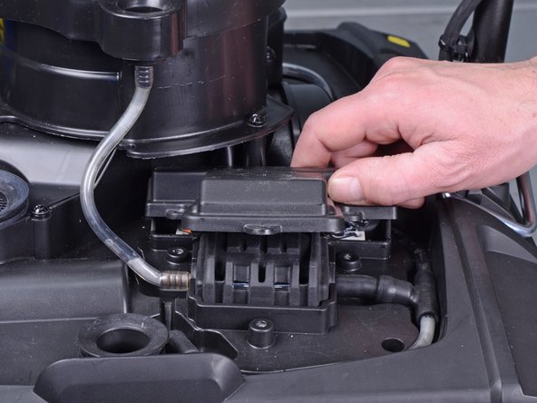

  4. Karcher Rotary Floor Cleaner 17833080 2017 Pump Replacement: crwdns2935265:04crwdnd2935265:01crwdnd2935265:03crwdne2935265:0 Karcher Rotary Floor Cleaner 17833080 2017 Pump Replacement: crwdns2935265:04crwdnd2935265:02crwdnd2935265:03crwdne2935265:0 Karcher Rotary Floor Cleaner 17833080 2017 Pump Replacement: crwdns2935265:04crwdnd2935265:03crwdnd2935265:03crwdne2935265:0

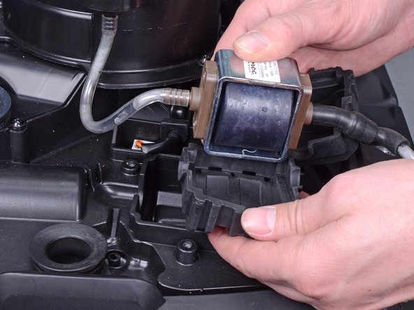

    • Remove the pump cover.

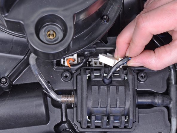

  5. Karcher Rotary Floor Cleaner 17833080 2017 Pump Replacement, Disconnect the pump: crwdns2935265:05crwdnd2935265:01crwdnd2935265:02crwdne2935265:0 Karcher Rotary Floor Cleaner 17833080 2017 Pump Replacement, Disconnect the pump: crwdns2935265:05crwdnd2935265:02crwdnd2935265:02crwdne2935265:0

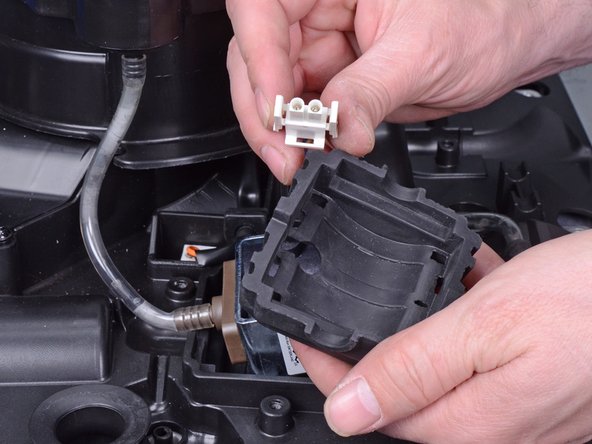

    • Squeeze the middle plug by the edges and pull it out of its socket.
    • During reassembly, make sure that all plugs are firmly seated in their sockets.

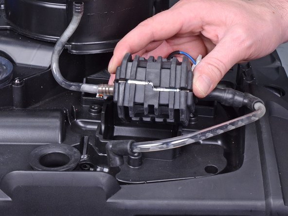

  6. Karcher Rotary Floor Cleaner 17833080 2017 Pump Replacement, Remove the pump bearings: crwdns2935265:06crwdnd2935265:01crwdnd2935265:03crwdne2935265:0 Karcher Rotary Floor Cleaner 17833080 2017 Pump Replacement, Remove the pump bearings: crwdns2935265:06crwdnd2935265:02crwdnd2935265:03crwdne2935265:0 Karcher Rotary Floor Cleaner 17833080 2017 Pump Replacement, Remove the pump bearings: crwdns2935265:06crwdnd2935265:03crwdnd2935265:03crwdne2935265:0

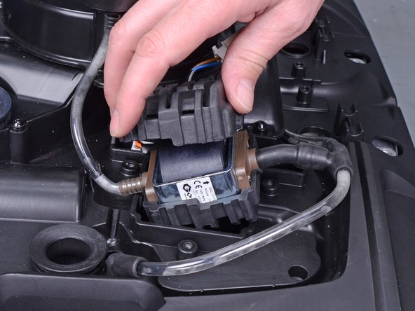

    • Lift the pump assembly out of its recess.
    • Reassembly tip: make sure that the output hose end is fully secured to the housing socket.

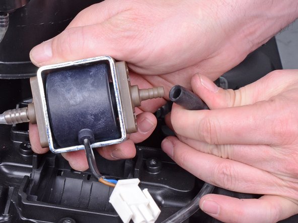

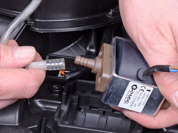

    • Pull the black check valve off the pump's output port.
  10. Karcher Rotary Floor Cleaner 17833080 2017 Pump Replacement: crwdns2935265:010crwdnd2935265:01crwdnd2935265:02crwdne2935265:0 Karcher Rotary Floor Cleaner 17833080 2017 Pump Replacement: crwdns2935265:010crwdnd2935265:02crwdnd2935265:02crwdne2935265:0
    • Pull the clear hose off the pump's input port.

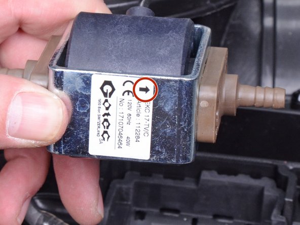

    • Reassembly tip: be careful not to mix the pump's input and output. The arrow points towards the pump output, which should connect to the black check valve.
