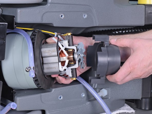

  7. Karcher Carpet Cleaner BRC3015C 2018 Vacuum Motor Replacement, Remove the vacuum motor assembly: crwdns2935265:07crwdnd2935265:01crwdnd2935265:01crwdne2935265:0
    • Use a flathead screwdriver to loosen the hose clamp securing the flexible hose to the vacuum motor.
  8. Karcher Carpet Cleaner BRC3015C 2018 Vacuum Motor Replacement: crwdns2935265:08crwdnd2935265:01crwdnd2935265:01crwdne2935265:0
    • Use a 3 mm hex key to remove the two bolts securing the vacuum motor cover.
  9. Karcher Carpet Cleaner BRC3015C 2018 Vacuum Motor Replacement: crwdns2935265:09crwdnd2935265:01crwdnd2935265:01crwdne2935265:0
    • Pull the flexible hose straight off of the vacuum motor to remove it.

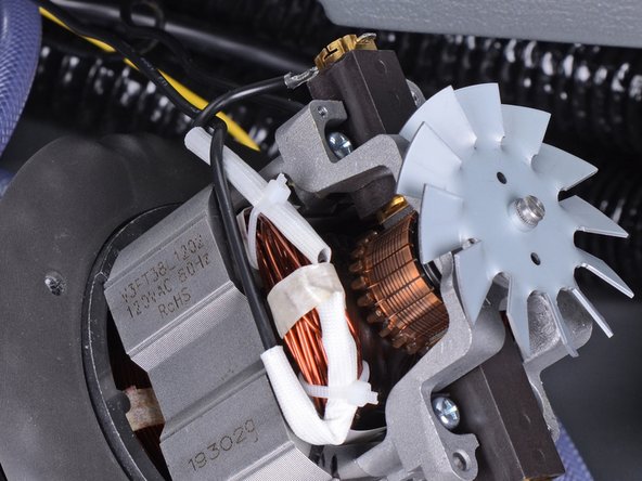

    • Use a pair of flush cutters to cut all the zip-ties securing any wires to the vacuum motor.

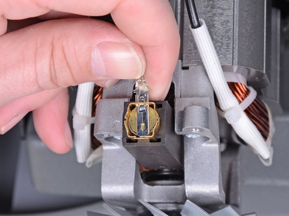

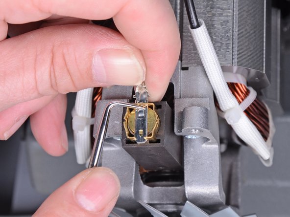

    • Use a pick or small flathead screwdriver to push down on the tab securing one of the motor's power cable connectors while gently sliding the connector out of its slot.
    • Do not completely remove the spade connector yet. The contact underneath it is tensioned by a spring and will fly out if you completely remove the spade connector.

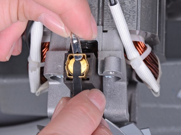

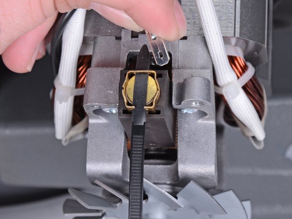

  17. Karcher Carpet Cleaner BRC3015C 2018 Vacuum Motor Replacement: crwdns2935265:017crwdnd2935265:01crwdnd2935265:03crwdne2935265:0 Karcher Carpet Cleaner BRC3015C 2018 Vacuum Motor Replacement: crwdns2935265:017crwdnd2935265:02crwdnd2935265:03crwdne2935265:0 Karcher Carpet Cleaner BRC3015C 2018 Vacuum Motor Replacement: crwdns2935265:017crwdnd2935265:03crwdnd2935265:03crwdne2935265:0
    • Use a zip tie, or anything flat and roughly the size of the spade connector, to slide into the slot as you slide the spade connector out of the slot.
    • Make sure the zip tie holds the spring contact down before you remove the spade connector.

    • Use the photos in this step as a reference for correctly reinstalling the cables on the new motor.
