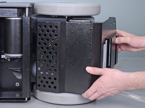

  2. Karcher Carpet Cleaner BRC3015C 2018 Pump Replacement, Remove the bottom cover: crwdns2935265:02crwdnd2935265:01crwdnd2935265:01crwdne2935265:0
    • Use a 3 mm hex key to remove two bolts securing the bottom cover.

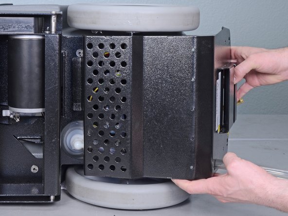

  3. Karcher Carpet Cleaner BRC3015C 2018 Pump Replacement: crwdns2935265:03crwdnd2935265:01crwdnd2935265:03crwdne2935265:0 Karcher Carpet Cleaner BRC3015C 2018 Pump Replacement: crwdns2935265:03crwdnd2935265:02crwdnd2935265:03crwdne2935265:0 Karcher Carpet Cleaner BRC3015C 2018 Pump Replacement: crwdns2935265:03crwdnd2935265:03crwdnd2935265:03crwdne2935265:0
    • Rotate the bottom cover down toward the bottom of the carpet cleaner, then pull it straight back toward the rear of the carpet cleaner to remove it.
    • Don't completely remove the cover yet. There is a ground wire connecting the cover to the carpet cleaner that must be disconnected first.

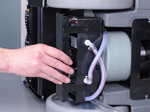

  5. Karcher Carpet Cleaner BRC3015C 2018 Pump Replacement, Remove the pump cover: crwdns2935265:05crwdnd2935265:01crwdnd2935265:01crwdne2935265:0
    • Use a 3 mm hex key to remove the four bolts securing the pump cover.
  6. Karcher Carpet Cleaner BRC3015C 2018 Pump Replacement: crwdns2935265:06crwdnd2935265:01crwdnd2935265:02crwdne2935265:0 Karcher Carpet Cleaner BRC3015C 2018 Pump Replacement: crwdns2935265:06crwdnd2935265:02crwdnd2935265:02crwdne2935265:0
    • Remove the pump cover.

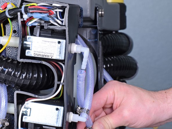

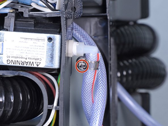

  7. Karcher Carpet Cleaner BRC3015C 2018 Pump Replacement, Remove the pump hoses: crwdns2935265:07crwdnd2935265:01crwdnd2935265:02crwdne2935265:0 Karcher Carpet Cleaner BRC3015C 2018 Pump Replacement, Remove the pump hoses: crwdns2935265:07crwdnd2935265:02crwdnd2935265:02crwdne2935265:0
    • Use a flathead screwdriver to loosen the hose clamps at both ends of the pump.
  8. Karcher Carpet Cleaner BRC3015C 2018 Pump Replacement: crwdns2935265:08crwdnd2935265:01crwdnd2935265:03crwdne2935265:0 Karcher Carpet Cleaner BRC3015C 2018 Pump Replacement: crwdns2935265:08crwdnd2935265:02crwdnd2935265:03crwdne2935265:0 Karcher Carpet Cleaner BRC3015C 2018 Pump Replacement: crwdns2935265:08crwdnd2935265:03crwdnd2935265:03crwdne2935265:0
    • Pull the hoses at both ends of the pump straight off of their hose barbs to remove them.

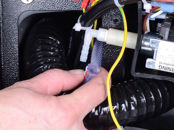

  9. Karcher Carpet Cleaner BRC3015C 2018 Pump Replacement, Remove the pump: crwdns2935265:09crwdnd2935265:01crwdnd2935265:01crwdne2935265:0
    • Use your fingers to unscrew the hose barb from the outward-facing end of the pump.

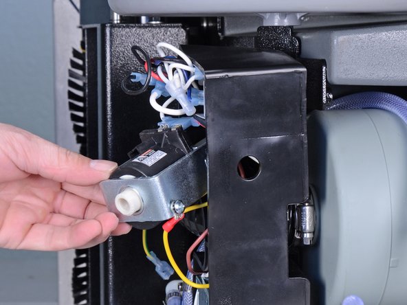

  10. Karcher Carpet Cleaner BRC3015C 2018 Pump Replacement: crwdns2935265:010crwdnd2935265:01crwdnd2935265:03crwdne2935265:0 Karcher Carpet Cleaner BRC3015C 2018 Pump Replacement: crwdns2935265:010crwdnd2935265:02crwdnd2935265:03crwdne2935265:0 Karcher Carpet Cleaner BRC3015C 2018 Pump Replacement: crwdns2935265:010crwdnd2935265:03crwdnd2935265:03crwdne2935265:0
    • Bend the outer side of the pump compartment away from the pump very slightly.
    • Slide the pump out of the hole in the side of the pump compartment, then continue to slide the pump out of the compartment.
    • Do not completely remove the pump yet, as it is still tethered to the carpet cleaner by three wires.

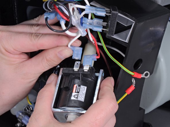

  11. Karcher Carpet Cleaner BRC3015C 2018 Pump Replacement: crwdns2935265:011crwdnd2935265:01crwdnd2935265:01crwdne2935265:0
    • Use a Phillips #2 screwdriver to remove the screw securing the ground wire to the pump.
    • Remove the ground wire from the pump.
  12. Karcher Carpet Cleaner BRC3015C 2018 Pump Replacement: crwdns2935265:012crwdnd2935265:01crwdnd2935265:02crwdne2935265:0 Karcher Carpet Cleaner BRC3015C 2018 Pump Replacement: crwdns2935265:012crwdnd2935265:02crwdnd2935265:02crwdne2935265:0
    • Pull the two connectors straight off of the pump to disconnect them from the pump.
  13. Karcher Carpet Cleaner BRC3015C 2018 Pump Replacement: crwdns2935265:013crwdnd2935265:01crwdnd2935265:01crwdne2935265:0
    • Use your fingers to unscrew the remaining hose barb from the pump.

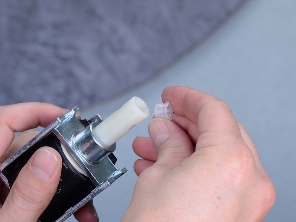

    • Your new pump may come with plugs on either end. Use an angled pick or small flathead screwdriver to pry these out before installation.
