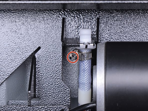

  5. Karcher Carpet Cleaner BRC3015C 2018 Check Valve Replacement, Remove the check valve hose: crwdns2935265:05crwdnd2935265:01crwdnd2935265:02crwdne2935265:0 Karcher Carpet Cleaner BRC3015C 2018 Check Valve Replacement, Remove the check valve hose: crwdns2935265:05crwdnd2935265:02crwdnd2935265:02crwdne2935265:0
    • Use a flathead screwdriver to loosen the hose clamps at each end of the check valve hose.
  6. Karcher Carpet Cleaner BRC3015C 2018 Check Valve Replacement: crwdns2935265:06crwdnd2935265:01crwdnd2935265:01crwdne2935265:0
    • Pull the check valve hose straight off of its hose barb to remove it.

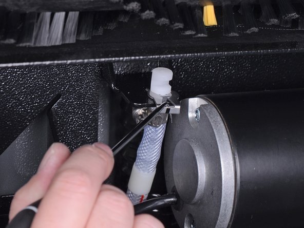

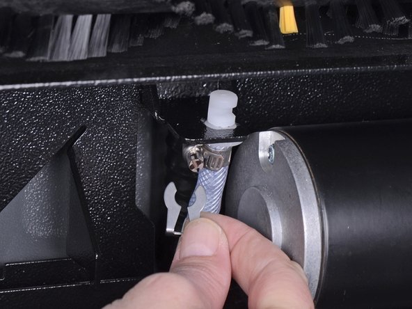

  7. Karcher Carpet Cleaner BRC3015C 2018 Check Valve Replacement: crwdns2935265:07crwdnd2935265:01crwdnd2935265:03crwdne2935265:0 Karcher Carpet Cleaner BRC3015C 2018 Check Valve Replacement: crwdns2935265:07crwdnd2935265:02crwdnd2935265:03crwdne2935265:0 Karcher Carpet Cleaner BRC3015C 2018 Check Valve Replacement: crwdns2935265:07crwdnd2935265:03crwdnd2935265:03crwdne2935265:0
    • Use an angled pick or your fingers to pull the clamp securing the check valve hose nozzle straight out and off of its bracket.

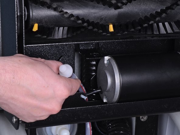

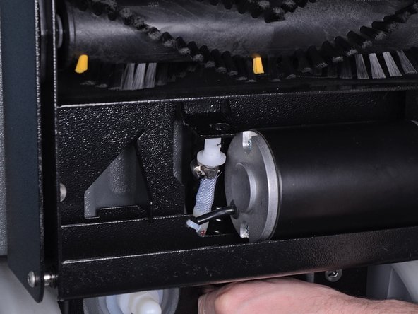

  8. Karcher Carpet Cleaner BRC3015C 2018 Check Valve Replacement: crwdns2935265:08crwdnd2935265:01crwdnd2935265:03crwdne2935265:0 Karcher Carpet Cleaner BRC3015C 2018 Check Valve Replacement: crwdns2935265:08crwdnd2935265:02crwdnd2935265:03crwdne2935265:0 Karcher Carpet Cleaner BRC3015C 2018 Check Valve Replacement: crwdns2935265:08crwdnd2935265:03crwdnd2935265:03crwdne2935265:0
    • Pull the nozzle straight down and out of its bracket.
    • Slide the entire check valve hose up and out of the carpet cleaner.

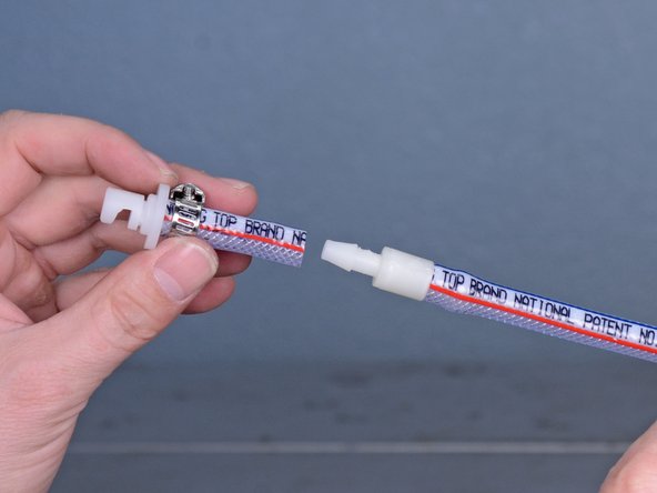

  9. Karcher Carpet Cleaner BRC3015C 2018 Check Valve Replacement, Remove the check valve: crwdns2935265:09crwdnd2935265:01crwdnd2935265:02crwdne2935265:0 Karcher Carpet Cleaner BRC3015C 2018 Check Valve Replacement, Remove the check valve: crwdns2935265:09crwdnd2935265:02crwdnd2935265:02crwdne2935265:0
    • Pull the shorter hose straight off of the check valve to remove it.

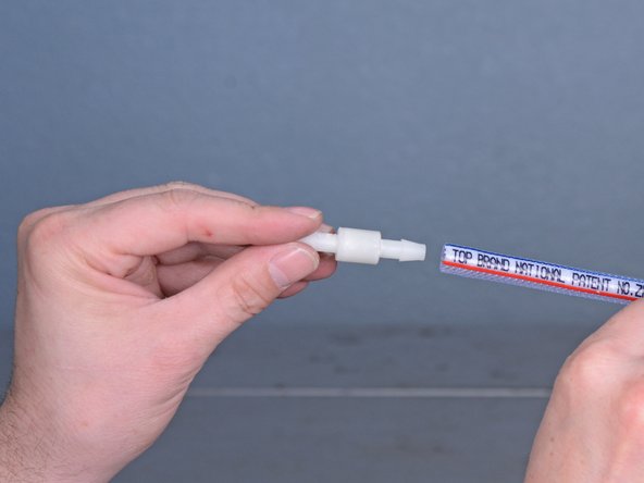

  10. Karcher Carpet Cleaner BRC3015C 2018 Check Valve Replacement: crwdns2935265:010crwdnd2935265:01crwdnd2935265:02crwdne2935265:0 Karcher Carpet Cleaner BRC3015C 2018 Check Valve Replacement: crwdns2935265:010crwdnd2935265:02crwdnd2935265:02crwdne2935265:0
    • Pull the check valve straight out of the hose to remove it.
    • Replace the check valve with a 1/4" x 1/4" hose barb.
    • Make sure to slide the hose clamps back onto the hose before reinstalling the hose.
