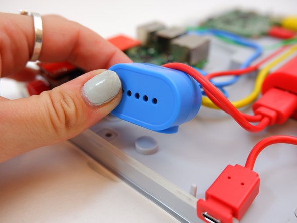

    • Take off the clear backing of the computer and set it aside.
    • Locate the Speaker.
  2. Kano Computer Kit Complete Speaker Replacement: crwdns2935265:02crwdnd2935265:01crwdnd2935265:03crwdne2935265:0 Kano Computer Kit Complete Speaker Replacement: crwdns2935265:02crwdnd2935265:02crwdnd2935265:03crwdne2935265:0 Kano Computer Kit Complete Speaker Replacement: crwdns2935265:02crwdnd2935265:03crwdnd2935265:03crwdne2935265:0

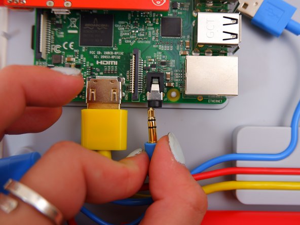

    • Unplug the blue power cable from the brain.
  3. Kano Computer Kit Complete Speaker Replacement: crwdns2935265:03crwdnd2935265:01crwdnd2935265:03crwdne2935265:0 Kano Computer Kit Complete Speaker Replacement: crwdns2935265:03crwdnd2935265:02crwdnd2935265:03crwdne2935265:0 Kano Computer Kit Complete Speaker Replacement: crwdns2935265:03crwdnd2935265:03crwdnd2935265:03crwdne2935265:0

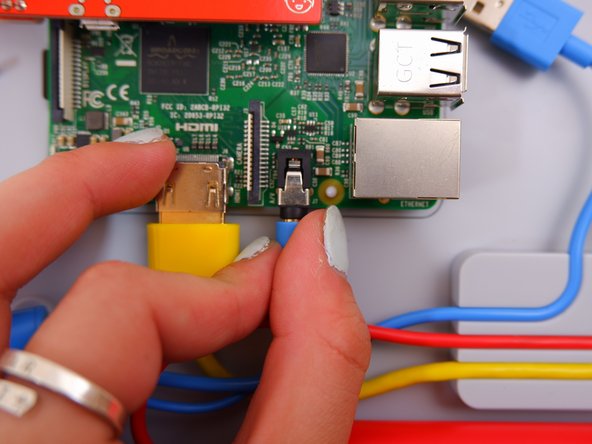

    • Unplug the blue audio jack from the brain.
  4. Kano Computer Kit Complete Speaker Replacement: crwdns2935265:04crwdnd2935265:01crwdnd2935265:02crwdne2935265:0 Kano Computer Kit Complete Speaker Replacement: crwdns2935265:04crwdnd2935265:02crwdnd2935265:02crwdne2935265:0
    • Pull the speaker up off the back of the screen.
To reassemble your device, follow these instructions in reverse order using the new speaker.
