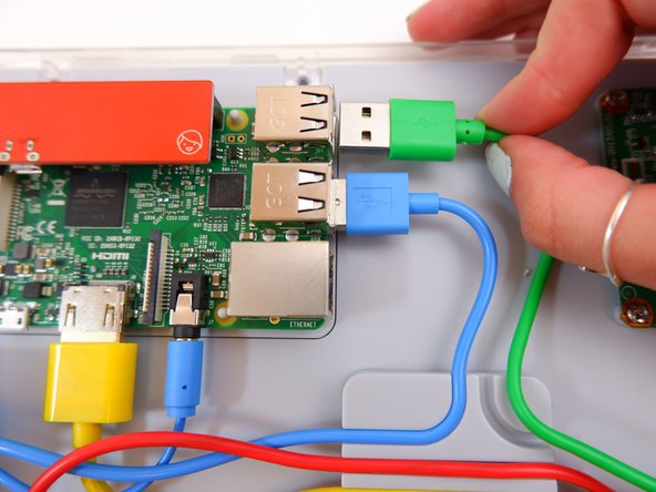

    1. Kano Computer Kit Complete Raspberry Pi Replacement, Raspberry Pi: crwdns2935265:01crwdnd2935265:01crwdnd2935265:02crwdne2935265:0 Kano Computer Kit Complete Raspberry Pi Replacement, Raspberry Pi: crwdns2935265:01crwdnd2935265:02crwdnd2935265:02crwdne2935265:0
      • Take off the clear backing of the computer and set it aside.
      • The Raspberry Pi is located in the top right corner of the case.

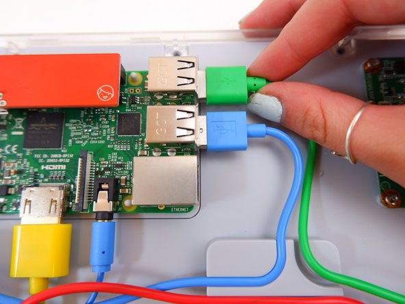

    3. Kano Computer Kit Complete Raspberry Pi Replacement: crwdns2935265:03crwdnd2935265:01crwdnd2935265:03crwdne2935265:0 Kano Computer Kit Complete Raspberry Pi Replacement: crwdns2935265:03crwdnd2935265:02crwdnd2935265:03crwdne2935265:0 Kano Computer Kit Complete Raspberry Pi Replacement: crwdns2935265:03crwdnd2935265:03crwdnd2935265:03crwdne2935265:0

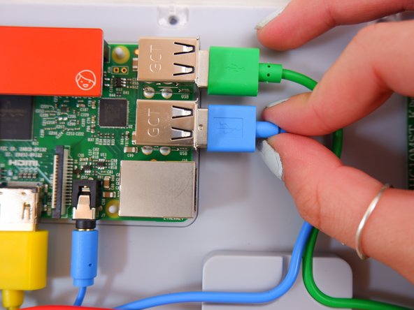

      • Unplug the green cable
    4. Kano Computer Kit Complete Raspberry Pi Replacement: crwdns2935265:04crwdnd2935265:01crwdnd2935265:03crwdne2935265:0 Kano Computer Kit Complete Raspberry Pi Replacement: crwdns2935265:04crwdnd2935265:02crwdnd2935265:03crwdne2935265:0 Kano Computer Kit Complete Raspberry Pi Replacement: crwdns2935265:04crwdnd2935265:03crwdnd2935265:03crwdne2935265:0

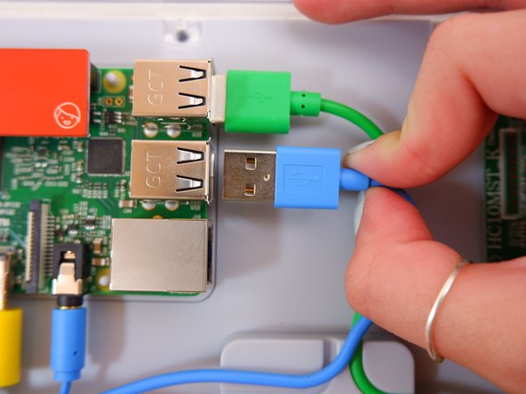

      • Unplug the blue USB cable.

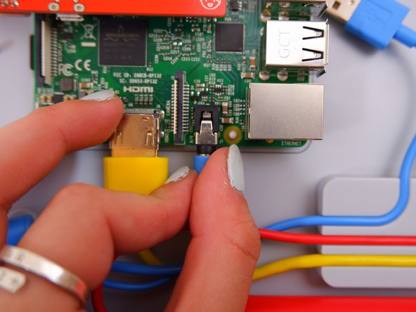

    5. Kano Computer Kit Complete Raspberry Pi Replacement: crwdns2935265:05crwdnd2935265:01crwdnd2935265:03crwdne2935265:0 Kano Computer Kit Complete Raspberry Pi Replacement: crwdns2935265:05crwdnd2935265:02crwdnd2935265:03crwdne2935265:0 Kano Computer Kit Complete Raspberry Pi Replacement: crwdns2935265:05crwdnd2935265:03crwdnd2935265:03crwdne2935265:0

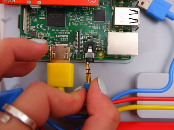

      • Unplug the blue audio jack.

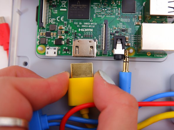

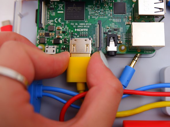

    6. Kano Computer Kit Complete Raspberry Pi Replacement: crwdns2935265:06crwdnd2935265:01crwdnd2935265:03crwdne2935265:0 Kano Computer Kit Complete Raspberry Pi Replacement: crwdns2935265:06crwdnd2935265:02crwdnd2935265:03crwdne2935265:0 Kano Computer Kit Complete Raspberry Pi Replacement: crwdns2935265:06crwdnd2935265:03crwdnd2935265:03crwdne2935265:0
      • Unplug the yellow cable.

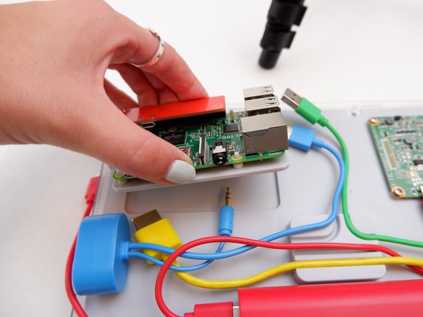

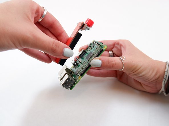

      • Pop off the entire board from of the back of the screen.
    8. Kano Computer Kit Complete Raspberry Pi Replacement: crwdns2935265:08crwdnd2935265:01crwdnd2935265:01crwdne2935265:0
      • Remove the backing off the Raspberry Pi.
    9. Kano Computer Kit Complete Raspberry Pi Replacement: crwdns2935265:09crwdnd2935265:01crwdnd2935265:02crwdne2935265:0 Kano Computer Kit Complete Raspberry Pi Replacement: crwdns2935265:09crwdnd2935265:02crwdnd2935265:02crwdne2935265:0
      • Remove the power button from the Raspberry Pi.
