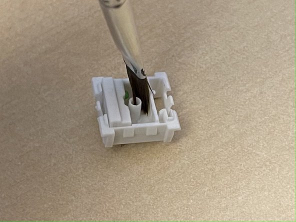

  3. Kailh Silent Brown Switch Lubrication, Lube base: crwdns2935265:03crwdnd2935265:01crwdnd2935265:02crwdne2935265:0 Kailh Silent Brown Switch Lubrication, Lube base: crwdns2935265:03crwdnd2935265:02crwdnd2935265:02crwdne2935265:0
    • Take you brush and twirl it around in the base.

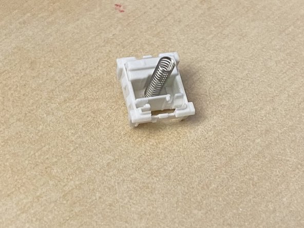

  7. Kailh Silent Brown Switch Lubrication, Put spring onto base: crwdns2935265:07crwdnd2935265:01crwdnd2935265:02crwdne2935265:0 Kailh Silent Brown Switch Lubrication, Put spring onto base: crwdns2935265:07crwdnd2935265:02crwdnd2935265:02crwdne2935265:0
    • Insert the spring onto the protrusion.
