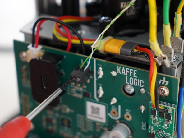

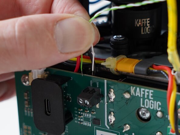

  6. Kaffelogic Nano 7/LINK (D-P Serial) Thermocouple Replacement, Disconnect the thermocouple: crwdns2935265:06crwdnd2935265:01crwdnd2935265:03crwdne2935265:0 Kaffelogic Nano 7/LINK (D-P Serial) Thermocouple Replacement, Disconnect the thermocouple: crwdns2935265:06crwdnd2935265:02crwdnd2935265:03crwdne2935265:0 Kaffelogic Nano 7/LINK (D-P Serial) Thermocouple Replacement, Disconnect the thermocouple: crwdns2935265:06crwdnd2935265:03crwdnd2935265:03crwdne2935265:0

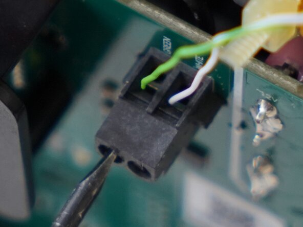

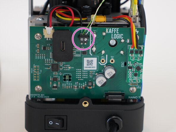

    • Use a 2.0mm slotted screwdriver to remove the thermocouple wires from the PCB-A

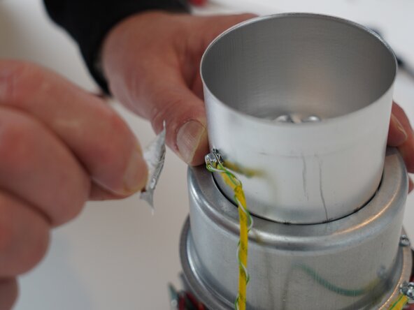

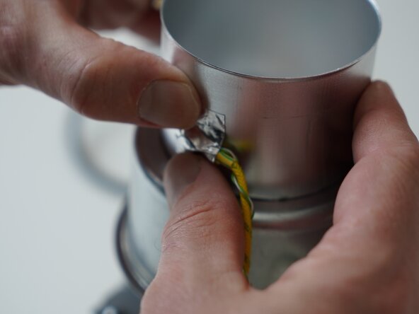

  7. Kaffelogic Nano 7/LINK (D-P Serial) Thermocouple Replacement, Remove the tape: crwdns2935265:07crwdnd2935265:01crwdnd2935265:03crwdne2935265:0 Kaffelogic Nano 7/LINK (D-P Serial) Thermocouple Replacement, Remove the tape: crwdns2935265:07crwdnd2935265:02crwdnd2935265:03crwdne2935265:0 Kaffelogic Nano 7/LINK (D-P Serial) Thermocouple Replacement, Remove the tape: crwdns2935265:07crwdnd2935265:03crwdnd2935265:03crwdne2935265:0
    • Carefully remove the foil tape from the roast chamber

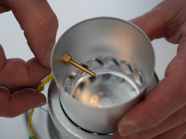

  8. Kaffelogic Nano 7/LINK (D-P Serial) Thermocouple Replacement, Removing the thermocouple: crwdns2935265:08crwdnd2935265:01crwdnd2935265:03crwdne2935265:0 Kaffelogic Nano 7/LINK (D-P Serial) Thermocouple Replacement, Removing the thermocouple: crwdns2935265:08crwdnd2935265:02crwdnd2935265:03crwdne2935265:0 Kaffelogic Nano 7/LINK (D-P Serial) Thermocouple Replacement, Removing the thermocouple: crwdns2935265:08crwdnd2935265:03crwdnd2935265:03crwdne2935265:0

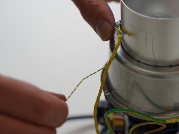

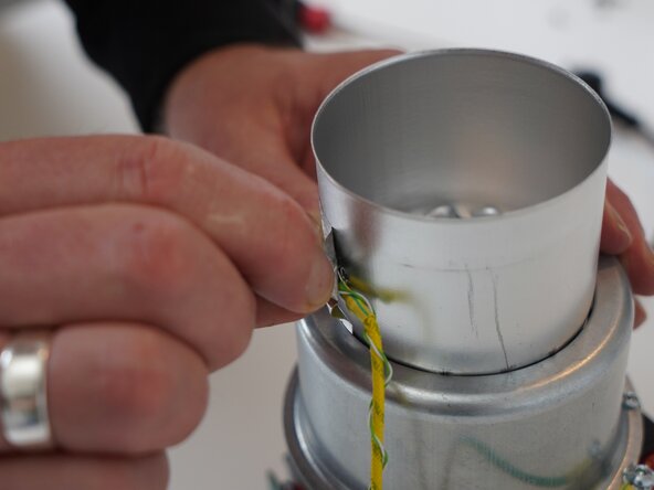

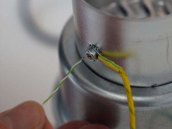

    • Unwind the thermocouple wire from the earth lead.
    • Pinch the thermocouple and gently remove it from the tube.

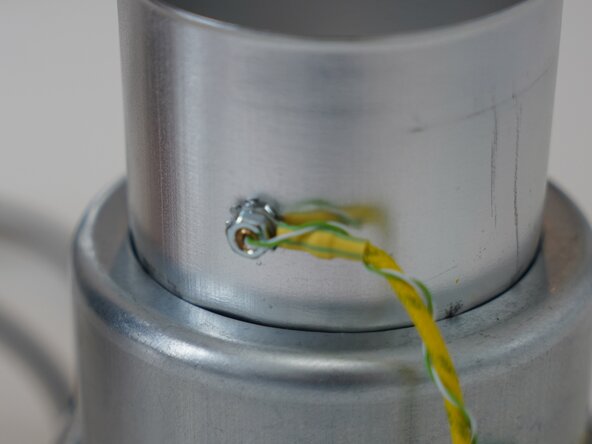

  9. Kaffelogic Nano 7/LINK (D-P Serial) Thermocouple Replacement, Reassembly notes: crwdns2935265:09crwdnd2935265:01crwdnd2935265:03crwdne2935265:0 Kaffelogic Nano 7/LINK (D-P Serial) Thermocouple Replacement, Reassembly notes: crwdns2935265:09crwdnd2935265:02crwdnd2935265:03crwdne2935265:0 Kaffelogic Nano 7/LINK (D-P Serial) Thermocouple Replacement, Reassembly notes: crwdns2935265:09crwdnd2935265:03crwdnd2935265:03crwdne2935265:0

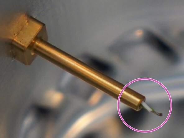

    • Leave 2mm of thermocouple insulation exposed
    • The thermocouple wires have connections points marked. Take care not to clamp the connector on the insulation.
    • Massage the tape firmly over the thermocouple wires to secure the position.
