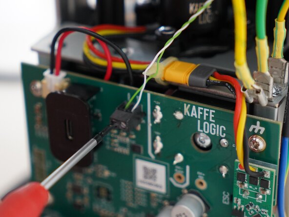

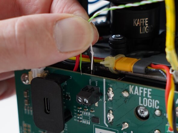

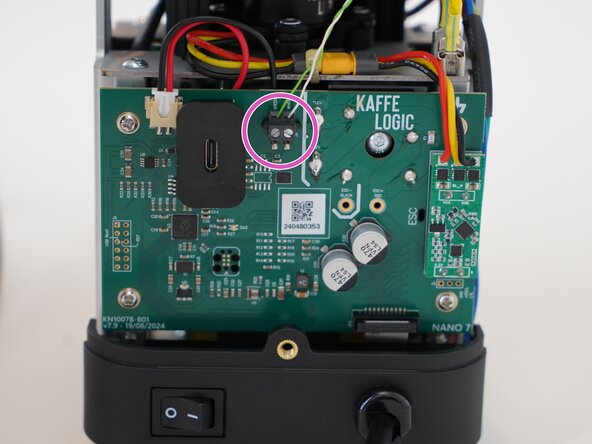

  6. Kaffelogic Nano 7/LINK (D-P Serial) Stack Replacement, Disconnect the thermocouple: crwdns2935265:06crwdnd2935265:01crwdnd2935265:03crwdne2935265:0 Kaffelogic Nano 7/LINK (D-P Serial) Stack Replacement, Disconnect the thermocouple: crwdns2935265:06crwdnd2935265:02crwdnd2935265:03crwdne2935265:0 Kaffelogic Nano 7/LINK (D-P Serial) Stack Replacement, Disconnect the thermocouple: crwdns2935265:06crwdnd2935265:03crwdnd2935265:03crwdne2935265:0
    • Use a 2.0mm slotted screwdriver to remove the thermocouple wires from the PCB-A

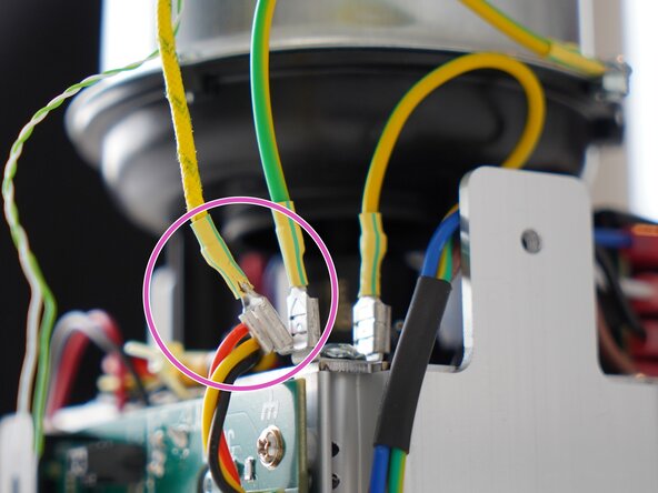

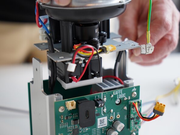

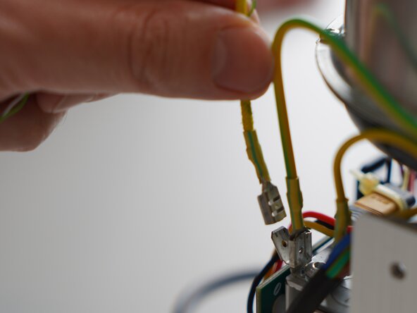

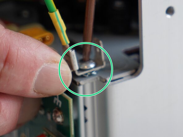

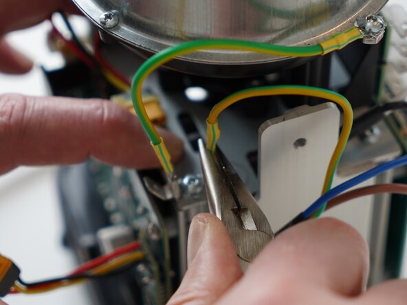

  7. Kaffelogic Nano 7/LINK (D-P Serial) Stack Replacement, Disconnect the earth: crwdns2935265:07crwdnd2935265:01crwdnd2935265:03crwdne2935265:0 Kaffelogic Nano 7/LINK (D-P Serial) Stack Replacement, Disconnect the earth: crwdns2935265:07crwdnd2935265:02crwdnd2935265:03crwdne2935265:0 Kaffelogic Nano 7/LINK (D-P Serial) Stack Replacement, Disconnect the earth: crwdns2935265:07crwdnd2935265:03crwdnd2935265:03crwdne2935265:0
    • Use needle-nose pliers to pull the roast chamber earth lead away from the earthing point.

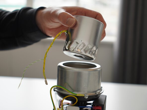

  8. Kaffelogic Nano 7/LINK (D-P Serial) Stack Replacement, Pull away the roast chamber: crwdns2935265:08crwdnd2935265:01crwdnd2935265:01crwdne2935265:0
    • Remove the roast chamber from the element chamber.
    • Head through to our wiki for instructions on recalibrating your fan speed after this repair.
    • Nucleus Link anemometer calibration instructions can be found here.

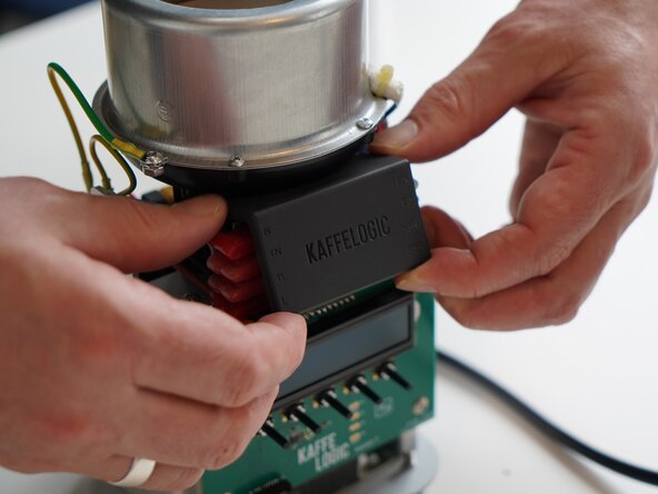

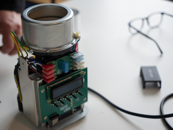

  9. Kaffelogic Nano 7/LINK (D-P Serial) Stack Replacement, Remove the mains wiring cover: crwdns2935265:09crwdnd2935265:01crwdnd2935265:03crwdne2935265:0 Kaffelogic Nano 7/LINK (D-P Serial) Stack Replacement, Remove the mains wiring cover: crwdns2935265:09crwdnd2935265:02crwdnd2935265:03crwdne2935265:0 Kaffelogic Nano 7/LINK (D-P Serial) Stack Replacement, Remove the mains wiring cover: crwdns2935265:09crwdnd2935265:03crwdnd2935265:03crwdne2935265:0
    • Remove the terminal PCB cover and set it aside. This is held in with four small plastic clips at each corner.

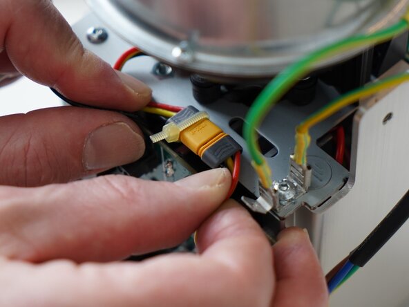

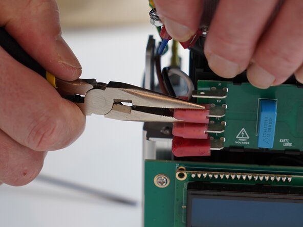

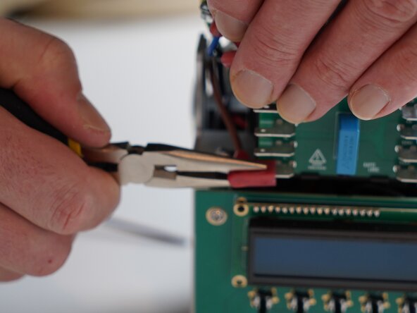

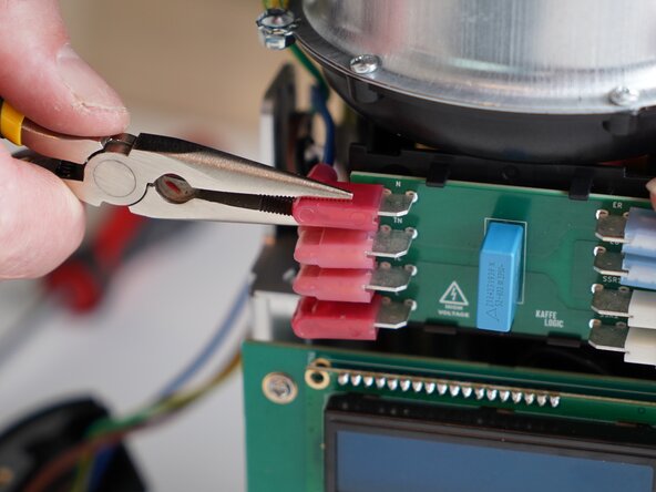

  10. Kaffelogic Nano 7/LINK (D-P Serial) Stack Replacement, Disconnect the mains connectors: crwdns2935265:010crwdnd2935265:01crwdnd2935265:03crwdne2935265:0 Kaffelogic Nano 7/LINK (D-P Serial) Stack Replacement, Disconnect the mains connectors: crwdns2935265:010crwdnd2935265:02crwdnd2935265:03crwdne2935265:0 Kaffelogic Nano 7/LINK (D-P Serial) Stack Replacement, Disconnect the mains connectors: crwdns2935265:010crwdnd2935265:03crwdnd2935265:03crwdne2935265:0
    • Remove all four connectors on the left side of the terminal PCB.
    • These are marked an N (Neutral), TN (Transformer Neutral), TL (Transformer Live) and L (Live)

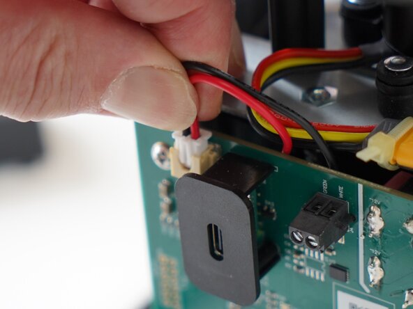

  11. Kaffelogic Nano 7/LINK (D-P Serial) Stack Replacement, Disconnect the motor: crwdns2935265:011crwdnd2935265:01crwdnd2935265:02crwdne2935265:0 Kaffelogic Nano 7/LINK (D-P Serial) Stack Replacement, Disconnect the motor: crwdns2935265:011crwdnd2935265:02crwdnd2935265:02crwdne2935265:0
    • Disconnect the motor cable, this may take some wiggling.
    • Refrain from using pliers or metal tools on this connector, as the plastic insulation can be damaged.

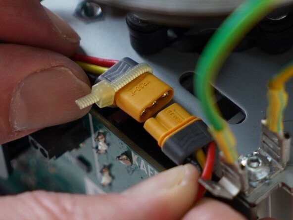

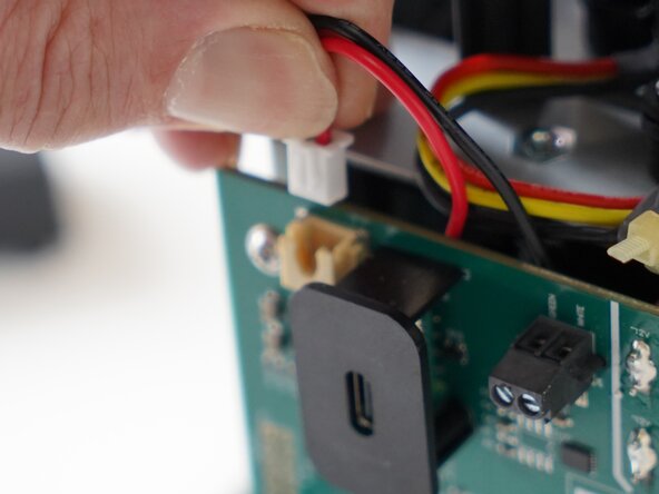

  12. Kaffelogic Nano 7/LINK (D-P Serial) Stack Replacement, Disconnect the SSR signal: crwdns2935265:012crwdnd2935265:01crwdnd2935265:02crwdne2935265:0 Kaffelogic Nano 7/LINK (D-P Serial) Stack Replacement, Disconnect the SSR signal: crwdns2935265:012crwdnd2935265:02crwdnd2935265:02crwdne2935265:0
    • Pull upwards on the SSR signal connector to remove it.

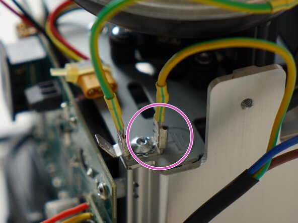

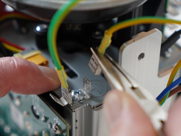

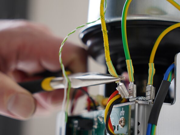

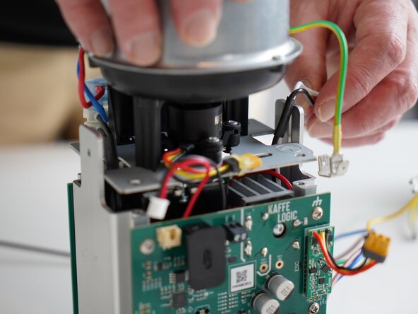

  13. Kaffelogic Nano 7/LINK (D-P Serial) Stack Replacement, Remove the earth tab: crwdns2935265:013crwdnd2935265:01crwdnd2935265:03crwdne2935265:0 Kaffelogic Nano 7/LINK (D-P Serial) Stack Replacement, Remove the earth tab: crwdns2935265:013crwdnd2935265:02crwdnd2935265:03crwdne2935265:0 Kaffelogic Nano 7/LINK (D-P Serial) Stack Replacement, Remove the earth tab: crwdns2935265:013crwdnd2935265:03crwdnd2935265:03crwdne2935265:0
    • Remove the mains earthing connector from the tab. Pliers can be used for this as it can be tight.

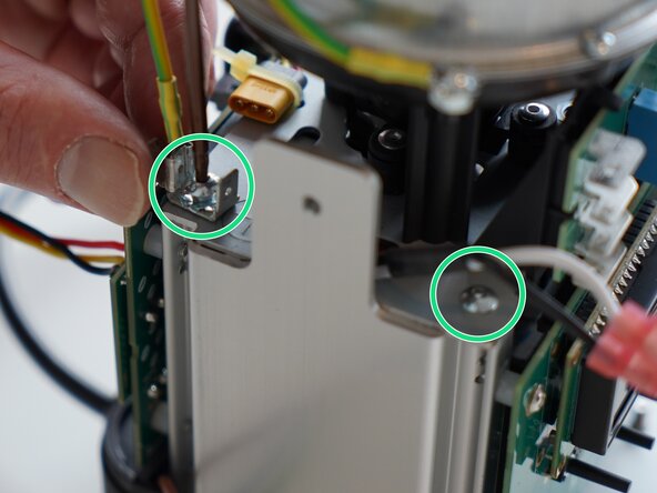

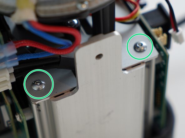

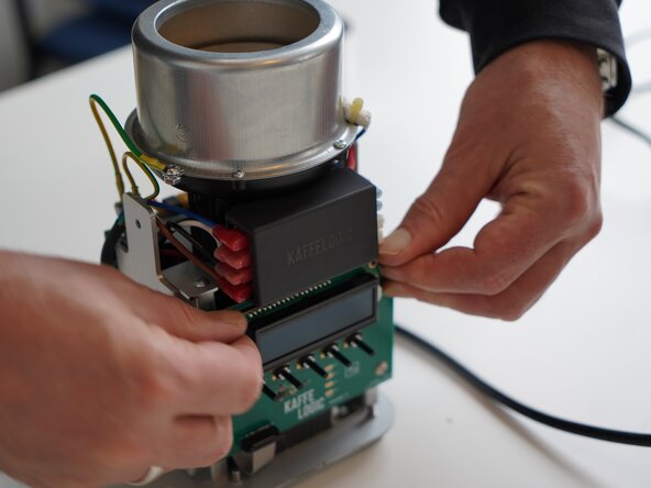

  14. Kaffelogic Nano 7/LINK (D-P Serial) Stack Replacement, Remove gantry screws: crwdns2935265:014crwdnd2935265:01crwdnd2935265:03crwdne2935265:0 Kaffelogic Nano 7/LINK (D-P Serial) Stack Replacement, Remove gantry screws: crwdns2935265:014crwdnd2935265:02crwdnd2935265:03crwdne2935265:0 Kaffelogic Nano 7/LINK (D-P Serial) Stack Replacement, Remove gantry screws: crwdns2935265:014crwdnd2935265:03crwdnd2935265:03crwdne2935265:0
    • Remove the 4x 2.5mm Hex screws securing the gantry plate to the aluminium uprights. A long driver bit is recommended for this.
    • Some early roasters will have sprung earth tabs on the right hand side of the roaster, please place these back as they were found during reassembly.

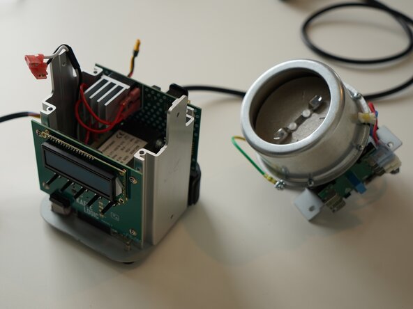

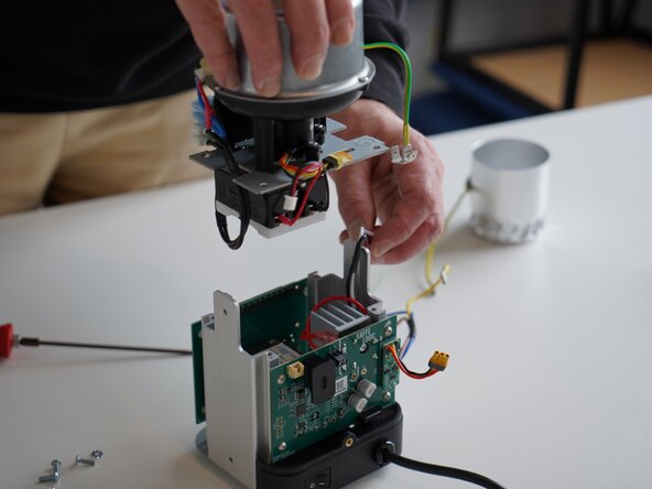

  15. Kaffelogic Nano 7/LINK (D-P Serial) Stack Replacement, Removing the stack: crwdns2935265:015crwdnd2935265:01crwdnd2935265:03crwdne2935265:0 Kaffelogic Nano 7/LINK (D-P Serial) Stack Replacement, Removing the stack: crwdns2935265:015crwdnd2935265:02crwdnd2935265:03crwdne2935265:0 Kaffelogic Nano 7/LINK (D-P Serial) Stack Replacement, Removing the stack: crwdns2935265:015crwdnd2935265:03crwdnd2935265:03crwdne2935265:0
    • Pull upwards on the stack to remove it from the base assembly.
  16. Kaffelogic Nano 7/LINK (D-P Serial) Stack Replacement, Stack Removed: crwdns2935265:016crwdnd2935265:01crwdnd2935265:03crwdne2935265:0 Kaffelogic Nano 7/LINK (D-P Serial) Stack Replacement, Stack Removed: crwdns2935265:016crwdnd2935265:02crwdnd2935265:03crwdne2935265:0 Kaffelogic Nano 7/LINK (D-P Serial) Stack Replacement, Stack Removed: crwdns2935265:016crwdnd2935265:03crwdnd2935265:03crwdne2935265:0
    • Well done! Your stack assembly is free!

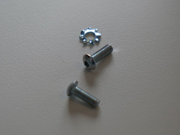

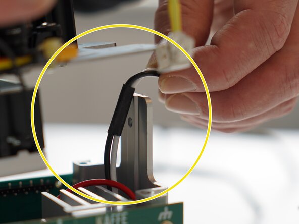

    • During reassembly, the star washer should be placed between the gantry plate steel and the earthing tab as pictured.
    • There is a hole in the gantry plate to route the transformer primary wires through. Hold them to the side as you place the new stack.
