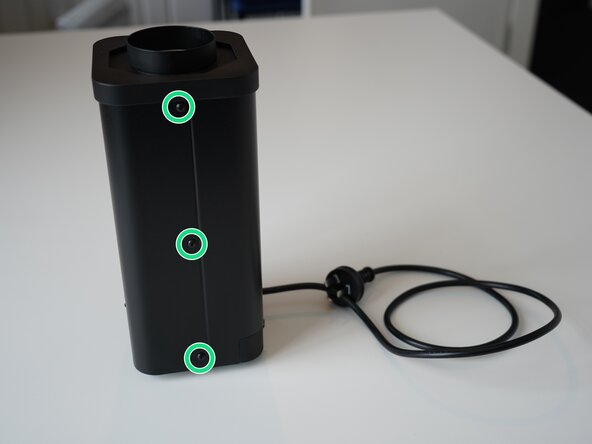

  1. Kaffelogic Nano 7/LINK (D-P Serial) Roast Chamber Replacement, Removing Front Panel Screws: crwdns2935265:01crwdnd2935265:01crwdnd2935265:02crwdne2935265:0 Kaffelogic Nano 7/LINK (D-P Serial) Roast Chamber Replacement, Removing Front Panel Screws: crwdns2935265:01crwdnd2935265:02crwdnd2935265:02crwdne2935265:0
    • Remove the 6x 2.5mm Hex screws on the left and right side of the roaster.
    • Take care not to damage the buttons while maneuvering the front panel, with all six screws removed it may fall away.

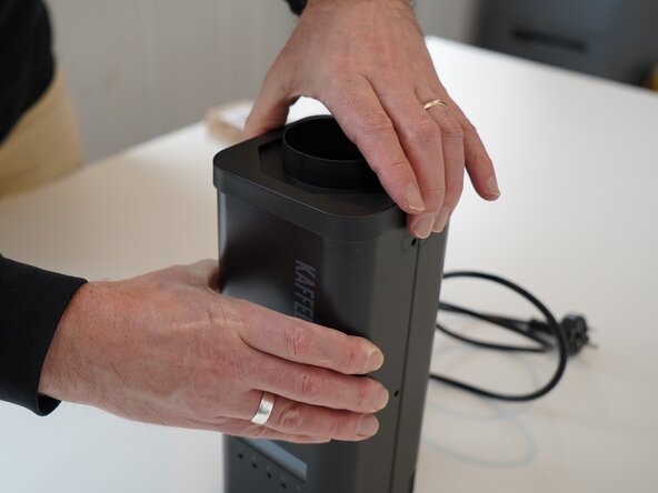

  2. Kaffelogic Nano 7/LINK (D-P Serial) Roast Chamber Replacement, Lift the closure: crwdns2935265:02crwdnd2935265:01crwdnd2935265:02crwdne2935265:0 Kaffelogic Nano 7/LINK (D-P Serial) Roast Chamber Replacement, Lift the closure: crwdns2935265:02crwdnd2935265:02crwdnd2935265:02crwdne2935265:0
    • Hold the front panel steady while removing the plastic top/closure.
