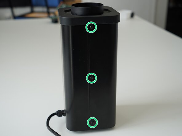

  1. Kaffelogic Nano 7/LINK (A/B/C-N Serial) Roast Chamber Replacement, Removing Panel Screws: crwdns2935265:01crwdnd2935265:01crwdnd2935265:02crwdne2935265:0 Kaffelogic Nano 7/LINK (A/B/C-N Serial) Roast Chamber Replacement, Removing Panel Screws: crwdns2935265:01crwdnd2935265:02crwdnd2935265:02crwdne2935265:0
    • Remove the 6x 2.5mm Hex screws on the left and right side of the roaster.

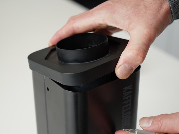

  2. Kaffelogic Nano 7/LINK (A/B/C-N Serial) Roast Chamber Replacement, Lift the closure: crwdns2935265:02crwdnd2935265:01crwdnd2935265:02crwdne2935265:0 Kaffelogic Nano 7/LINK (A/B/C-N Serial) Roast Chamber Replacement, Lift the closure: crwdns2935265:02crwdnd2935265:02crwdnd2935265:02crwdne2935265:0
    • Hold the roaster steady while removing the plastic top/closure.
    • Panels may spring apart slightly once removed.
