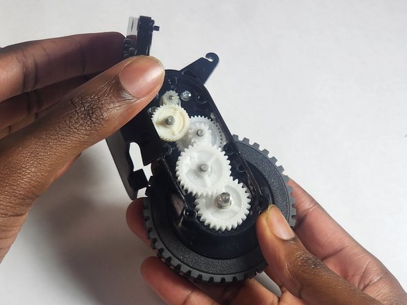

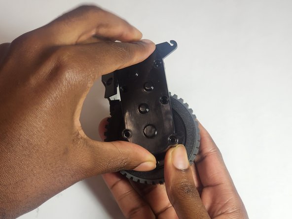

  8. KYVOL CYBOVAC E20 Wheel Assembly Replacement, Wheel Assembly: crwdns2935265:08crwdnd2935265:01crwdnd2935265:03crwdne2935265:0 KYVOL CYBOVAC E20 Wheel Assembly Replacement, Wheel Assembly: crwdns2935265:08crwdnd2935265:02crwdnd2935265:03crwdne2935265:0 KYVOL CYBOVAC E20 Wheel Assembly Replacement, Wheel Assembly: crwdns2935265:08crwdnd2935265:03crwdnd2935265:03crwdne2935265:0
    • Remove six 10 mm screws from the housing using a Phillips #00 screwdriver.
    • Open the gearbox.
  9. KYVOL CYBOVAC E20 Wheel Assembly Replacement: crwdns2935265:09crwdnd2935265:01crwdnd2935265:01crwdne2935265:0
    • Gently remove each gear.
