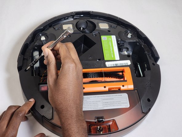

  8. KYVOL CYBOVAC E20 Motherboard Replacement, Motherboard: crwdns2935265:08crwdnd2935265:01crwdnd2935265:02crwdne2935265:0 KYVOL CYBOVAC E20 Motherboard Replacement, Motherboard: crwdns2935265:08crwdnd2935265:02crwdnd2935265:02crwdne2935265:0
    • Flip the device over.
    • Remove the eight 15 mm screws on the device's underside using a Phillips #2 screwdriver

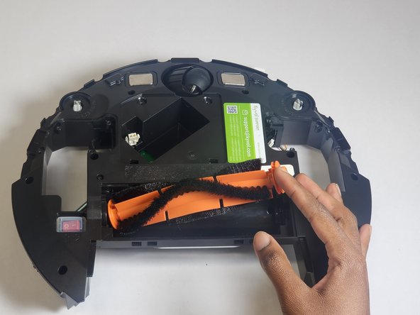

  10. KYVOL CYBOVAC E20 Motherboard Replacement: crwdns2935265:010crwdnd2935265:01crwdnd2935265:02crwdne2935265:0 KYVOL CYBOVAC E20 Motherboard Replacement: crwdns2935265:010crwdnd2935265:02crwdnd2935265:02crwdne2935265:0
    • Remove the dust bin from the device.

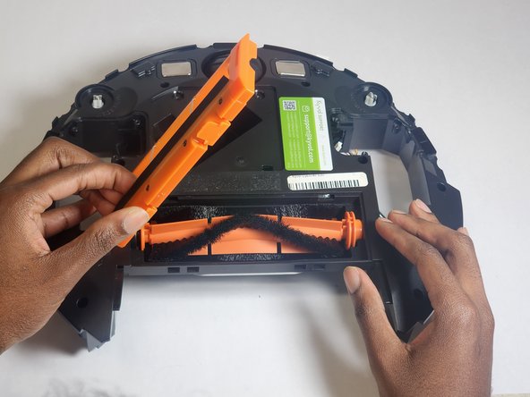

  11. KYVOL CYBOVAC E20 Motherboard Replacement: crwdns2935265:011crwdnd2935265:01crwdnd2935265:03crwdne2935265:0 KYVOL CYBOVAC E20 Motherboard Replacement: crwdns2935265:011crwdnd2935265:02crwdnd2935265:03crwdne2935265:0 KYVOL CYBOVAC E20 Motherboard Replacement: crwdns2935265:011crwdnd2935265:03crwdnd2935265:03crwdne2935265:0
    • Remove the main brush from the bottom of the device.
    • Remove the orange cover, then pop the brush out of its compartment.

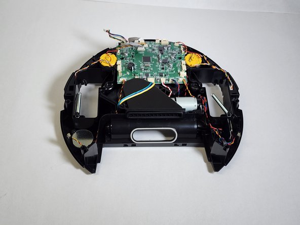

  12. KYVOL CYBOVAC E20 Motherboard Replacement: crwdns2935265:012crwdnd2935265:01crwdnd2935265:02crwdne2935265:0 KYVOL CYBOVAC E20 Motherboard Replacement: crwdns2935265:012crwdnd2935265:02crwdnd2935265:02crwdne2935265:0
    • Disconnect the ribbon cable between the top and bottom halves of the device and remove the top half away from the rest of the body.

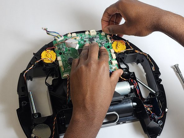

  13. KYVOL CYBOVAC E20 Motherboard Replacement: crwdns2935265:013crwdnd2935265:01crwdnd2935265:01crwdne2935265:0
    • Remove the three 10 mm screws from the motherboard using a Phillips #2 screwdriver.

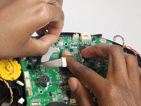

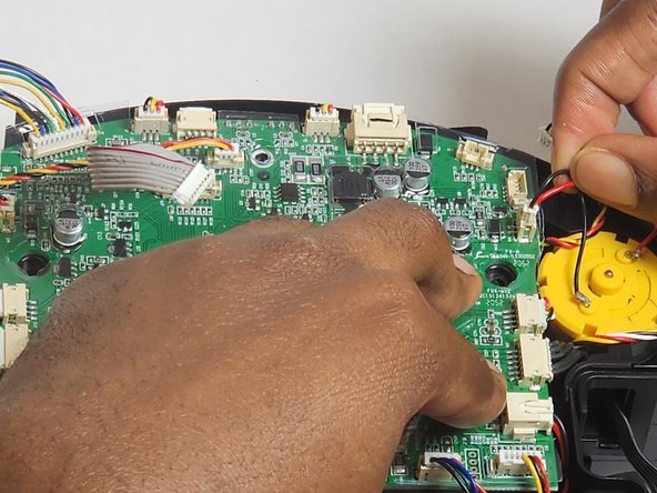

  14. KYVOL CYBOVAC E20 Motherboard Replacement: crwdns2935265:014crwdnd2935265:01crwdnd2935265:03crwdne2935265:0 KYVOL CYBOVAC E20 Motherboard Replacement: crwdns2935265:014crwdnd2935265:02crwdnd2935265:03crwdne2935265:0 KYVOL CYBOVAC E20 Motherboard Replacement: crwdns2935265:014crwdnd2935265:03crwdnd2935265:03crwdne2935265:0
    • Detach the connections on the motherboard carefully.

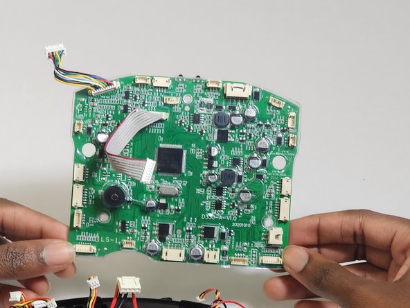

  15. KYVOL CYBOVAC E20 Motherboard Replacement: crwdns2935265:015crwdnd2935265:01crwdnd2935265:03crwdne2935265:0 KYVOL CYBOVAC E20 Motherboard Replacement: crwdns2935265:015crwdnd2935265:02crwdnd2935265:03crwdne2935265:0 KYVOL CYBOVAC E20 Motherboard Replacement: crwdns2935265:015crwdnd2935265:03crwdnd2935265:03crwdne2935265:0
    • Continue removing the connections up until you are done removing all 19 of the motherboard connections.
    • Once all plugs are disconnected, lift the motherboard out of the device.
