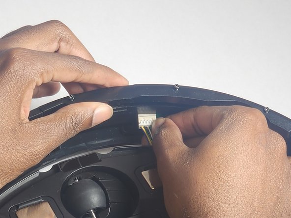

  9. KYVOL CYBOVAC E20 Main Motor Replacement: crwdns2935265:09crwdnd2935265:01crwdnd2935265:02crwdne2935265:0 KYVOL CYBOVAC E20 Main Motor Replacement: crwdns2935265:09crwdnd2935265:02crwdnd2935265:02crwdne2935265:0
    • Remove the eight 10 mm screws using a Phillips #00 screwdriver.
    • Disconnect the plug.
    • Remove the front bumper.

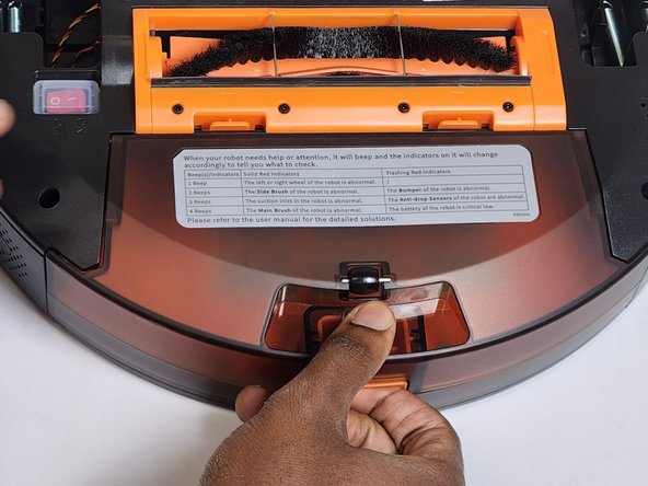

  10. KYVOL CYBOVAC E20 Main Motor Replacement: crwdns2935265:010crwdnd2935265:01crwdnd2935265:03crwdne2935265:0 KYVOL CYBOVAC E20 Main Motor Replacement: crwdns2935265:010crwdnd2935265:02crwdnd2935265:03crwdne2935265:0 KYVOL CYBOVAC E20 Main Motor Replacement: crwdns2935265:010crwdnd2935265:03crwdnd2935265:03crwdne2935265:0

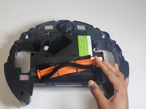

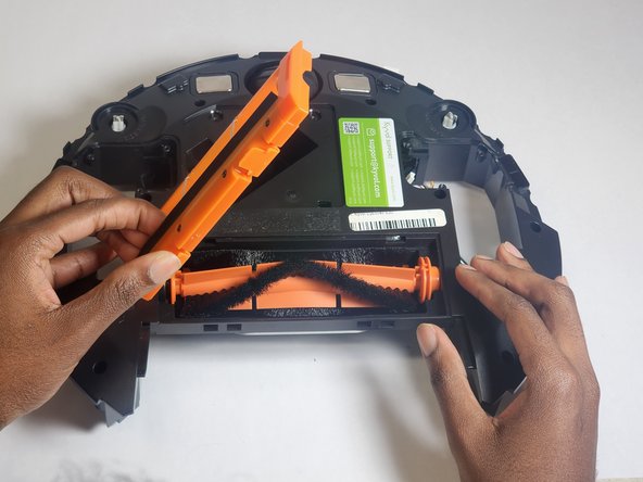

    • Apply pressure to each tab to remove the cover.
    • Remove the main brush.
  11. KYVOL CYBOVAC E20 Main Motor Replacement: crwdns2935265:011crwdnd2935265:01crwdnd2935265:02crwdne2935265:0 KYVOL CYBOVAC E20 Main Motor Replacement: crwdns2935265:011crwdnd2935265:02crwdnd2935265:02crwdne2935265:0

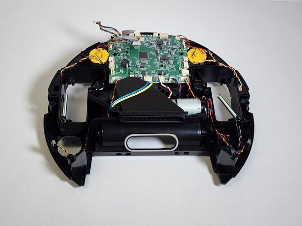

    • Flip the vacuum so it is upright.
    • Disconnect the outer shell from the motherboard.

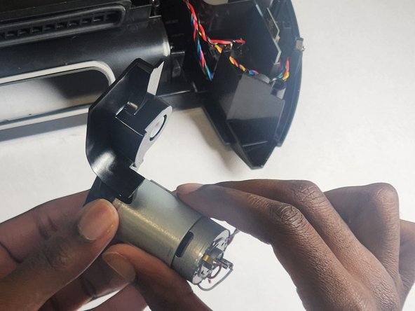

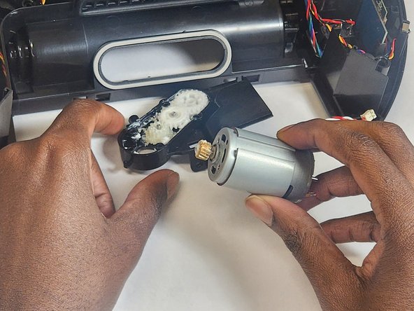

  12. KYVOL CYBOVAC E20 Main Motor Replacement: crwdns2935265:012crwdnd2935265:01crwdnd2935265:03crwdne2935265:0 KYVOL CYBOVAC E20 Main Motor Replacement: crwdns2935265:012crwdnd2935265:02crwdnd2935265:03crwdne2935265:0 KYVOL CYBOVAC E20 Main Motor Replacement: crwdns2935265:012crwdnd2935265:03crwdnd2935265:03crwdne2935265:0

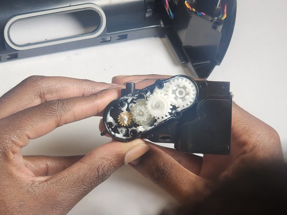

    • Remove the single 10 mm screw using a Phillips #0 screwdriver.
    • Disconnect the motor from the motherboard and remove the main motor assembly.

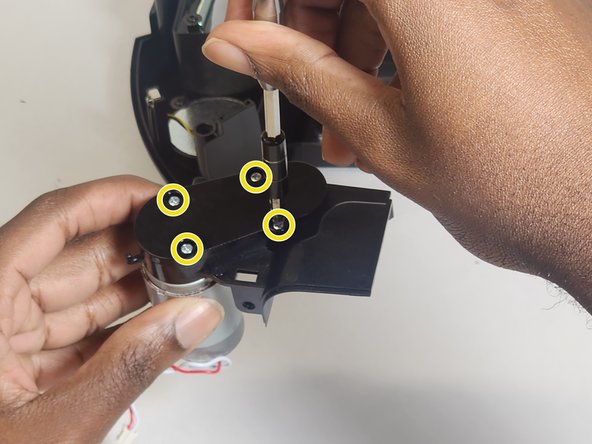

    • Remove the four 6 mm screws using a Phillips #1 screwdriver.
    • Remove the gearbox cover.
  13. KYVOL CYBOVAC E20 Main Motor Replacement: crwdns2935265:013crwdnd2935265:01crwdnd2935265:03crwdne2935265:0 KYVOL CYBOVAC E20 Main Motor Replacement: crwdns2935265:013crwdnd2935265:02crwdnd2935265:03crwdne2935265:0 KYVOL CYBOVAC E20 Main Motor Replacement: crwdns2935265:013crwdnd2935265:03crwdnd2935265:03crwdne2935265:0
    • Remove the two 6 mm screws using a Phillips #1 screwdriver to separate main motor from the housing.
