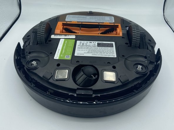

    • Start with the vacuum on a flat surface.
    • The power button should be on the side closest to you.
  2. KYVOL CYBOVAC E20 Front Bumper Replacement: crwdns2935265:02crwdnd2935265:01crwdnd2935265:02crwdne2935265:0 KYVOL CYBOVAC E20 Front Bumper Replacement: crwdns2935265:02crwdnd2935265:02crwdnd2935265:02crwdne2935265:0
    • Flip the vacuum over so the bottom is facing up.
    • The dust bin should be on the side furthest from you.
    • Remove the eight 1 mm screws holding the bumper in place using a Phillips #00 screwdriver.
  3. KYVOL CYBOVAC E20 Front Bumper Replacement: crwdns2935265:03crwdnd2935265:01crwdnd2935265:02crwdne2935265:0 KYVOL CYBOVAC E20 Front Bumper Replacement: crwdns2935265:03crwdnd2935265:02crwdnd2935265:02crwdne2935265:0
    • Remove both sides of the bumper and replace them with new ones.
