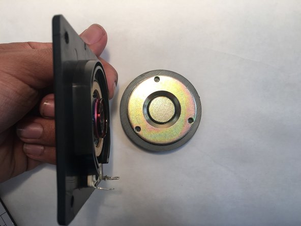

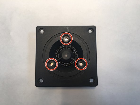

  5. KLH Speaker Tweeter and Driver Replacement: crwdns2935265:05crwdnd2935265:01crwdnd2935265:03crwdne2935265:0 KLH Speaker Tweeter and Driver Replacement: crwdns2935265:05crwdnd2935265:02crwdnd2935265:03crwdne2935265:0 KLH Speaker Tweeter and Driver Replacement: crwdns2935265:05crwdnd2935265:03crwdnd2935265:03crwdne2935265:0
    • Remove the speaker from its plastic bezel using a #1 Phillips head screwdriver.
