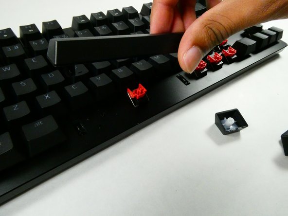

    • Grip the keycap with your keycap puller.

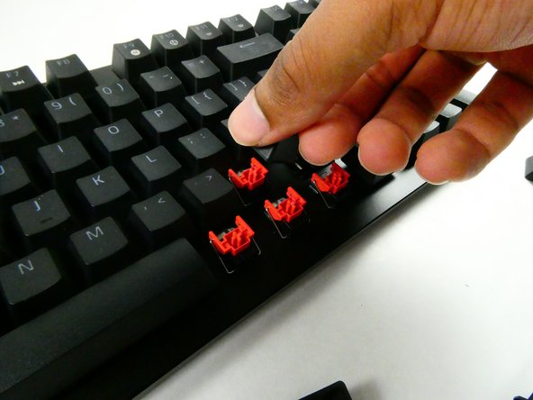

    • You can remove keycaps with your fingers if you don’t have a puller, but the adjacent keycaps must be removed first for sufficient grip.
  3. KBParadise V6000 Disassembly: crwdns2935265:03crwdnd2935265:01crwdnd2935265:03crwdne2935265:0 KBParadise V6000 Disassembly: crwdns2935265:03crwdnd2935265:02crwdnd2935265:03crwdne2935265:0 KBParadise V6000 Disassembly: crwdns2935265:03crwdnd2935265:03crwdnd2935265:03crwdne2935265:0
    • Pull with an upwards force to remove the keycap.
    • Take a moment to clean the area that was previously obscured if it’s dirty.
    • Use gentle force so as not to damage the stabilizers.

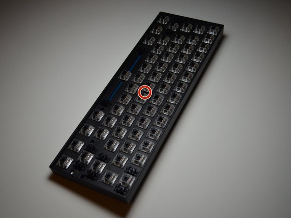

  4. KBParadise V6000 Disassembly, Remove the screws: crwdns2935265:04crwdnd2935265:01crwdnd2935265:02crwdne2935265:0 KBParadise V6000 Disassembly, Remove the screws: crwdns2935265:04crwdnd2935265:02crwdnd2935265:02crwdne2935265:0
    • Remove the five screws that hold the keyboard together.
    • Two of the screws on the bottom are under the two rubber feet closest to the user, so the rubber feet must be carefully peeled away to access the screws.

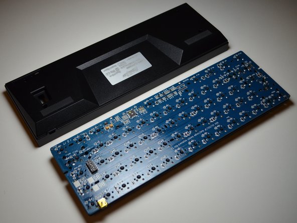

  5. KBParadise V6000 Disassembly, Remove the case: crwdns2935265:05crwdnd2935265:01crwdnd2935265:02crwdne2935265:0 KBParadise V6000 Disassembly, Remove the case: crwdns2935265:05crwdnd2935265:02crwdnd2935265:02crwdne2935265:0
    • Invert the keyboard and lift the case off.
    • If the case holds on, gently hit the keyboard into the palm of your hand to dislodge the internals.
