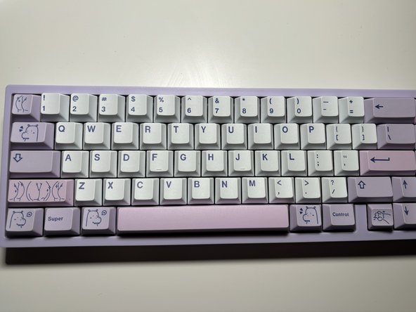

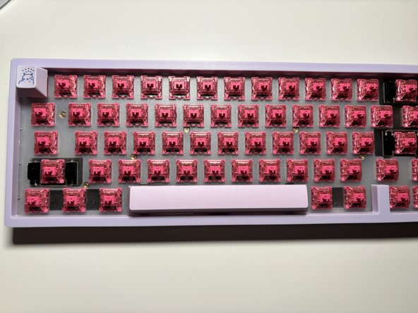

    • Place keyboard on top of a flat table.
    • Remove keycaps manually or with a key cap puller, as demonstrated.
    • Organize tools to prevent loss.

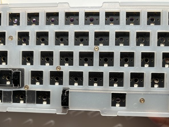

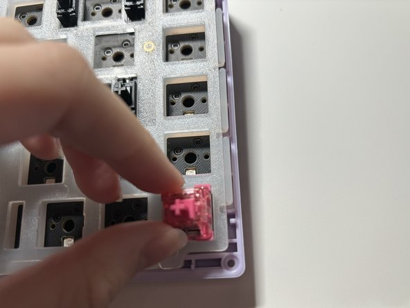

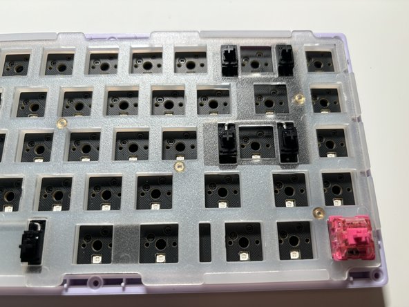

  2. KBD67 Lite R4 Keyboard Keys Replacement, Remove switches from PCB: crwdns2935265:02crwdnd2935265:01crwdnd2935265:03crwdne2935265:0 KBD67 Lite R4 Keyboard Keys Replacement, Remove switches from PCB: crwdns2935265:02crwdnd2935265:02crwdnd2935265:03crwdne2935265:0 KBD67 Lite R4 Keyboard Keys Replacement, Remove switches from PCB: crwdns2935265:02crwdnd2935265:03crwdnd2935265:03crwdne2935265:0

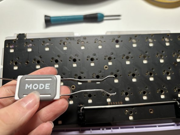

    • These images showcase the correct utilization of a key switch puller.
    • Remove switches either manually or with a key switch puller.
    • A switch puller is recommended as hand removal might be difficult.

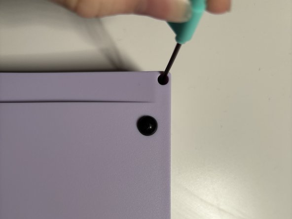

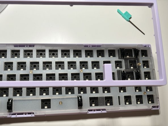

  3. KBD67 Lite R4 Keyboard Keys Replacement, Remove case (unscrew from back): crwdns2935265:03crwdnd2935265:01crwdnd2935265:03crwdne2935265:0 KBD67 Lite R4 Keyboard Keys Replacement, Remove case (unscrew from back): crwdns2935265:03crwdnd2935265:02crwdnd2935265:03crwdne2935265:0 KBD67 Lite R4 Keyboard Keys Replacement, Remove case (unscrew from back): crwdns2935265:03crwdnd2935265:03crwdnd2935265:03crwdne2935265:0
    • Use screwdriver to unscrew the eight screws on back of keyboard.
    • Make sure to secure screws for later use.

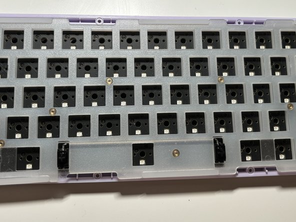

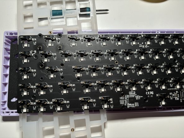

  4. KBD67 Lite R4 Keyboard Keys Replacement, Remove PCB from case: crwdns2935265:04crwdnd2935265:01crwdnd2935265:03crwdne2935265:0 KBD67 Lite R4 Keyboard Keys Replacement, Remove PCB from case: crwdns2935265:04crwdnd2935265:02crwdnd2935265:03crwdne2935265:0 KBD67 Lite R4 Keyboard Keys Replacement, Remove PCB from case: crwdns2935265:04crwdnd2935265:03crwdnd2935265:03crwdne2935265:0

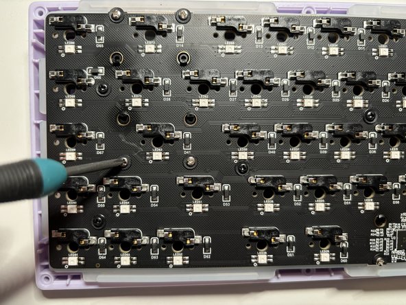

    • Unscrew the PCB from case.
    • Avoid placing the PCB on static-prone surfaces to prevent it from shorting the switch sockets.

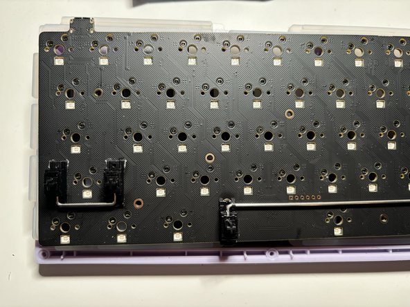

  5. KBD67 Lite R4 Keyboard Keys Replacement, Unscrew the stabilizers: crwdns2935265:05crwdnd2935265:01crwdnd2935265:03crwdne2935265:0 KBD67 Lite R4 Keyboard Keys Replacement, Unscrew the stabilizers: crwdns2935265:05crwdnd2935265:02crwdnd2935265:03crwdne2935265:0 KBD67 Lite R4 Keyboard Keys Replacement, Unscrew the stabilizers: crwdns2935265:05crwdnd2935265:03crwdnd2935265:03crwdne2935265:0
    • Unscrew the stabilizers from the back of the PCB.
    • Keep track of the noise-reducing foam stickers screwed between the PCB and keyboard switches.

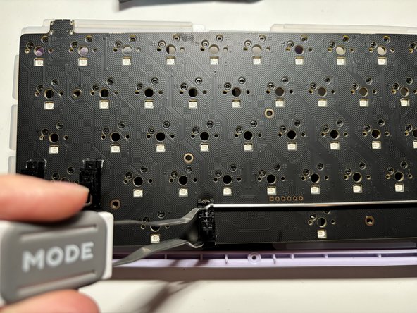

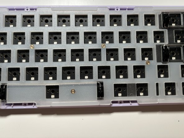

  6. KBD67 Lite R4 Keyboard Keys Replacement, Pull Stabilizers out of PCB: crwdns2935265:06crwdnd2935265:01crwdnd2935265:03crwdne2935265:0 KBD67 Lite R4 Keyboard Keys Replacement, Pull Stabilizers out of PCB: crwdns2935265:06crwdnd2935265:02crwdnd2935265:03crwdne2935265:0 KBD67 Lite R4 Keyboard Keys Replacement, Pull Stabilizers out of PCB: crwdns2935265:06crwdnd2935265:03crwdnd2935265:03crwdne2935265:0
    • Use switch puller to take out stabilizers.
    • Once the stabilizers are unscrewed from the back, they can be removed from the PCB.

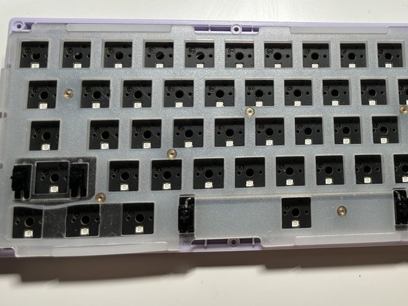

    • This completes the disassembly of the keyboard. Place the PCB in a static-free area.
  7. KBD67 Lite R4 Keyboard Keys Replacement, Place PCB on foam and plastic cover: crwdns2935265:07crwdnd2935265:01crwdnd2935265:03crwdne2935265:0 KBD67 Lite R4 Keyboard Keys Replacement, Place PCB on foam and plastic cover: crwdns2935265:07crwdnd2935265:02crwdnd2935265:03crwdne2935265:0 KBD67 Lite R4 Keyboard Keys Replacement, Place PCB on foam and plastic cover: crwdns2935265:07crwdnd2935265:03crwdnd2935265:03crwdne2935265:0
    • Place the plastic and foam cover on the bottom of the keyboard case.
    • The PCB sits on top of the foam cover.

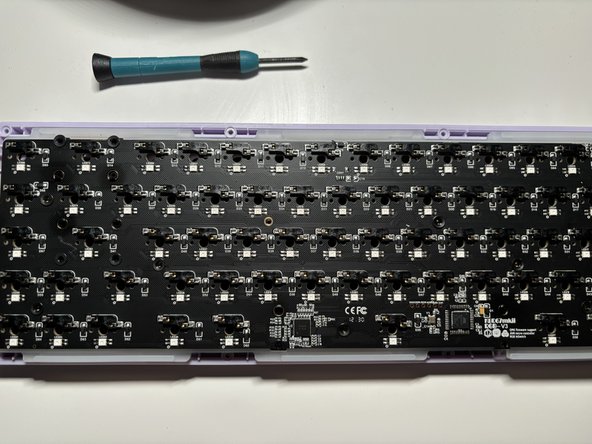

  8. KBD67 Lite R4 Keyboard Keys Replacement, Put stabilizers back onto PCB: crwdns2935265:08crwdnd2935265:01crwdnd2935265:03crwdne2935265:0 KBD67 Lite R4 Keyboard Keys Replacement, Put stabilizers back onto PCB: crwdns2935265:08crwdnd2935265:02crwdnd2935265:03crwdne2935265:0 KBD67 Lite R4 Keyboard Keys Replacement, Put stabilizers back onto PCB: crwdns2935265:08crwdnd2935265:03crwdnd2935265:03crwdne2935265:0
    • Ensure noise-reducing foam stickers are in position before attaching the stabilizers.
    • Install stabilizers onto the PCB.
    • Screw where applicable.

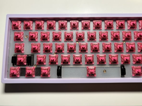

  9. KBD67 Lite R4 Keyboard Keys Replacement, Replace switches into hot swap PCB: crwdns2935265:09crwdnd2935265:01crwdnd2935265:03crwdne2935265:0 KBD67 Lite R4 Keyboard Keys Replacement, Replace switches into hot swap PCB: crwdns2935265:09crwdnd2935265:02crwdnd2935265:03crwdne2935265:0 KBD67 Lite R4 Keyboard Keys Replacement, Replace switches into hot swap PCB: crwdns2935265:09crwdnd2935265:03crwdnd2935265:03crwdne2935265:0
    Microfiber Cleaning Cloths
    $3.99

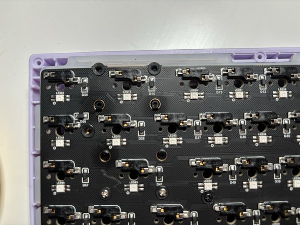

    • Do not bend the switch pins.
    • Optional: You can clean the switches with a microfiber cloth.
    • Align the key switch pins with the corresponding holes on the PCB.

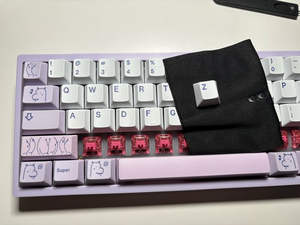

  11. KBD67 Lite R4 Keyboard Keys Replacement, Choose keycaps for Switches: crwdns2935265:011crwdnd2935265:01crwdnd2935265:03crwdne2935265:0 KBD67 Lite R4 Keyboard Keys Replacement, Choose keycaps for Switches: crwdns2935265:011crwdnd2935265:02crwdnd2935265:03crwdne2935265:0 KBD67 Lite R4 Keyboard Keys Replacement, Choose keycaps for Switches: crwdns2935265:011crwdnd2935265:03crwdnd2935265:03crwdne2935265:0
    • Choose keycaps to place onto switches.
    • Optional: If you would like, clean the keycaps with a microfiber cloth or a bristled toothbrush before reattaching them.
  12. KBD67 Lite R4 Keyboard Keys Replacement, Test the switches and PCB: crwdns2935265:012crwdnd2935265:01crwdnd2935265:02crwdne2935265:0 KBD67 Lite R4 Keyboard Keys Replacement, Test the switches and PCB: crwdns2935265:012crwdnd2935265:02crwdnd2935265:02crwdne2935265:0
    • Plug the keyboard into a device of your choice and test its functions using appropriate software.
